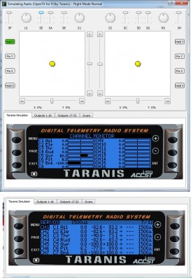

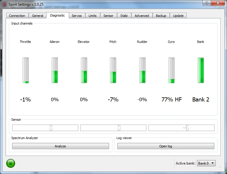

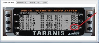

I had those settings as well, and found that I was seeing -7% of pitch when the TX was sending 0.0 on channel 6Jman841 wrote:Test 23:
My Pitch center is 1500us as I changed the subtrim instead...
In Servo tab It is set to 6 on the subtrim with the max limit at 89 and min limit at -77
By changing this, the diagnostic screen now shows the correct 0% when the TX tells me channel 6 is 0.0
While I have not put a pitch guage on the heli, this may have been the reason for my unequal pitch range
I had .5deg more -ve pitch, but the Trex 450 is known to be uneven!

Excellent! I changed my fail safe values to be similar to yours Yak, I will test it with no pulses as well but I suspect everything is fixed.
My pitch shows a perfect 0-100 with proper centering in the diagnostic screen and on the heli when I setup the pitch. Strange that yours did not.
