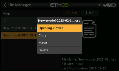

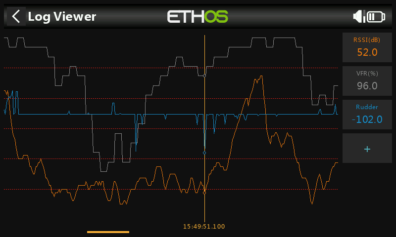

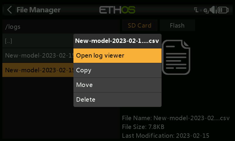

Ethos 1.5.0 - there will also be a Log Viewer - *.csv files ...
