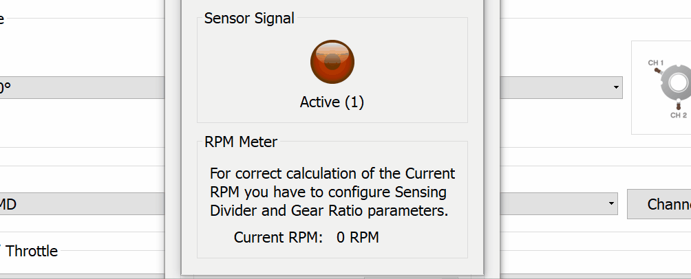

Stuttering was the wrong word sorry, it just regulated too much since the rpm was jumping too hard. Check this animated gif (click it to be animated):
I disabled spirit's gov and enabled esc gov as long as the rpm signal is jumping that much.
I added ferrit rings to the bec cables. I could only do 3 windings instead of 5... could relocate the ubec so that more windings are possible. unfortunately with 3 windings there was no difference at all to the rpm jumping, i don't think 2 windings more will help... What else could be the problem?
