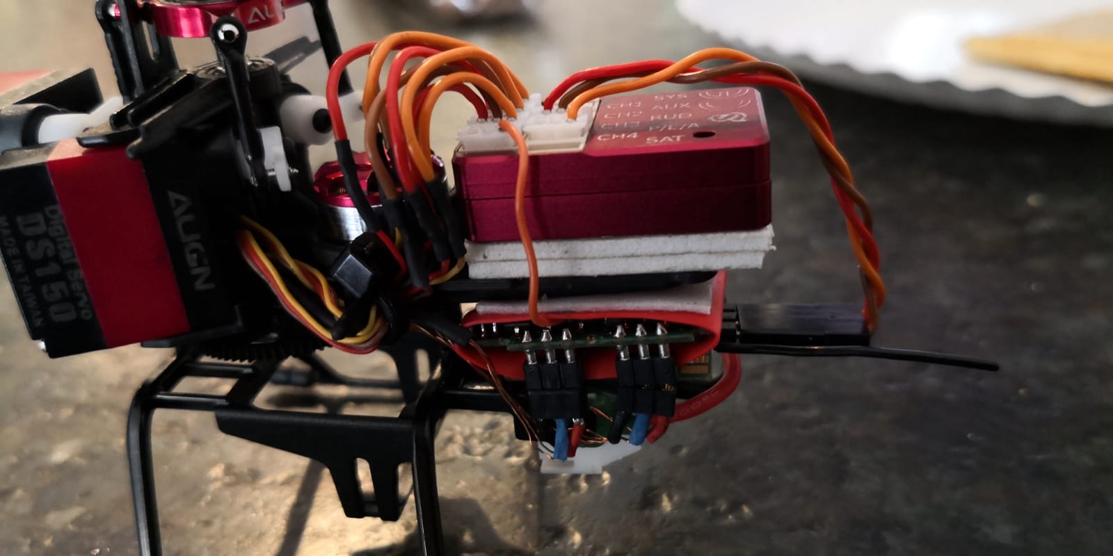

Hi
I made a set of pictures of the mounting of the spirit2 and geolink as well as a ppt with pictures of the position of the swash plate under different settings. Hope this helps.
kind regards
Jo
kind regards
Jo

Thank you very much for all the details.
After communication we have found that units with inclined swashplate where even no accelerometer calibration has an effect, the sensor is partially bad.
The part of the sensor was not utilized by the previous firmwares, so the issue was not apparent.
Any unit with this error will be fixed for free by us.
The first indication that is showing there is something wrong is that swashplate is not level once rescue or stabilisation is engaged.
