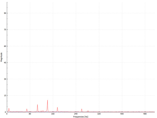

I have attached my settings and also a freeze from the vibe analyser (running with all blades attached) with the hopes that may help either me or others sort this X5 thing out.

Posts: 13044
vibration analysis seems to be perfect if it looks similarly in all axes. So we can rule out vibration problem.
You can try to lower Geometry 6° even more. But either solution with 20% gain should work too.
