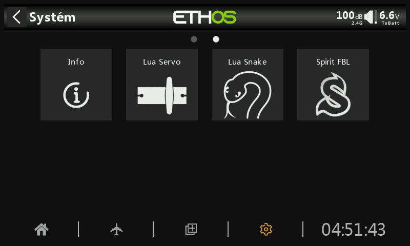

Any news on when the ETHOS Lua integration scripts will finally be available, or if it already is, where to find it?
Posts: 12887
Integration scripts are finished. You can download it now. It was tested with EthOS 1.3.
Here wiki page with screenshots is visible:
https://manual.spirit-system.com/index.php?title=EthOS

Hi Tomas, thanks for the scripts, i'm running 1.3 on x20s HD, the scripts are opening on the radio and i'm configured F-port, my guess is,, i got wiring missing somewhere as the scripts don't open. I am unable to find specific wiring in the wiki pages but remember seeing something somewhere connecting into the SYS Plug of the spirit GT, can you put me out of my misery please? :oops:
