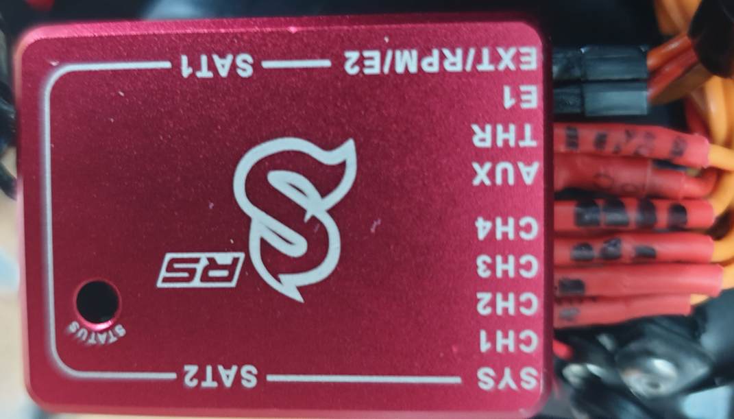

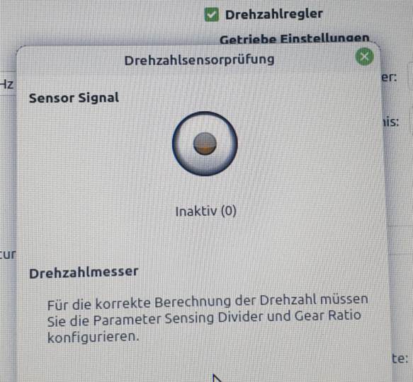

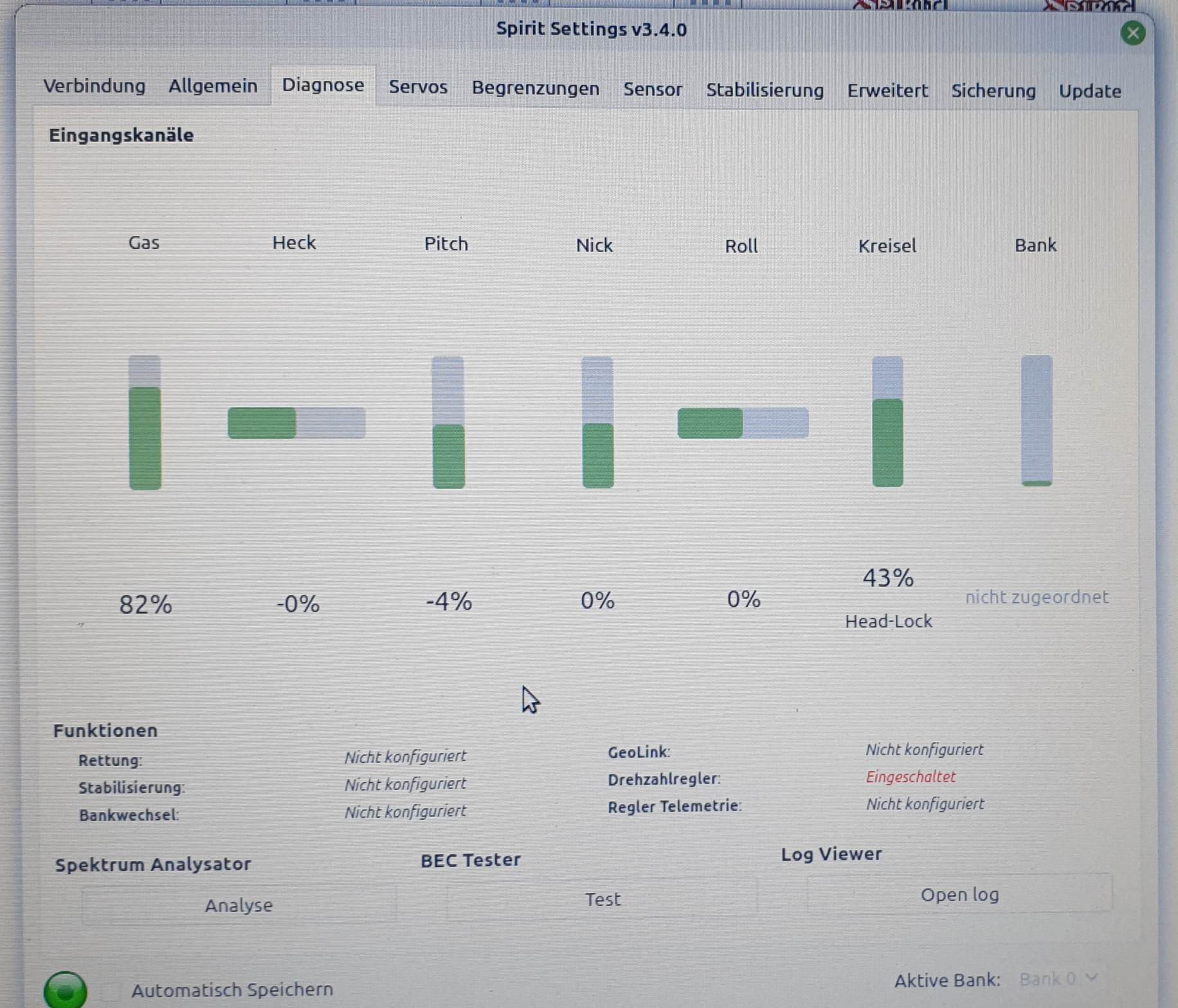

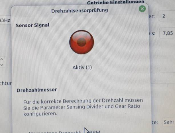

Hi Scott,
well the sensor ist conected with red and brown cable to the E1 port and the orange cable is connected to the middle pin of "EXT/RPM/E2".
Wenn the Sensor do not see the magnet it is red colored and shows "active" and when it sees the magnet it's grey and shows "inactive". It is the same for both magnets.
Please see also the pics.
best regards, Kay
best regards, Kay
