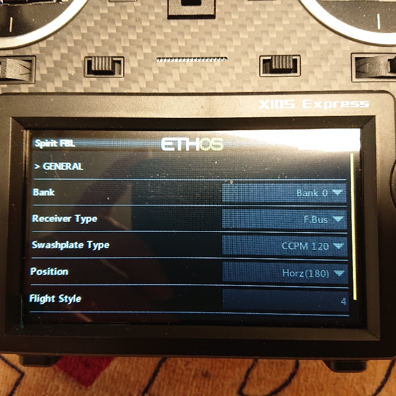

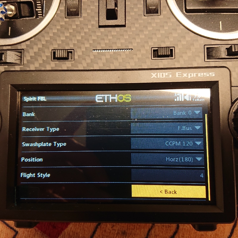

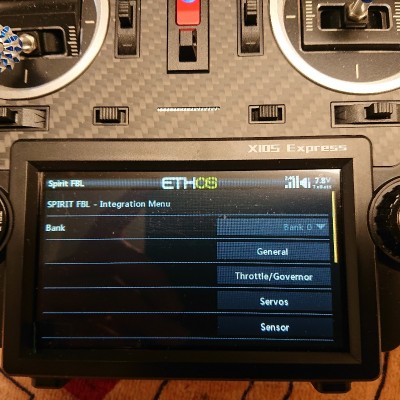

Hello, I tested the new script for ETHOS today - First I tested the test with FPort with and without redundancy receiver - Result for FPort both Archer RS alone and in combination with redundancy receiver with the Archer R8 Pro works stable and flawlessly, it you can branch into all points and make changes, after one setting you can easily go to another point and change other points - at the end you can either leave the script without changes or save the changed settings, it works perfectly! Here I noticed two points that should still be changed - on the one hand, the displayed rudder gain does not match the setting in the remote control, a gain of 60% is always displayed, regardless of what the transmitter specifies - it has to be in any case still to be corrected - another thing is also not correct yet, namely under the point Stabili under the point Rescue-Duration 30 instead of 3 seconds is displayed, that should also be corrected - but as I said everything else is perfect!

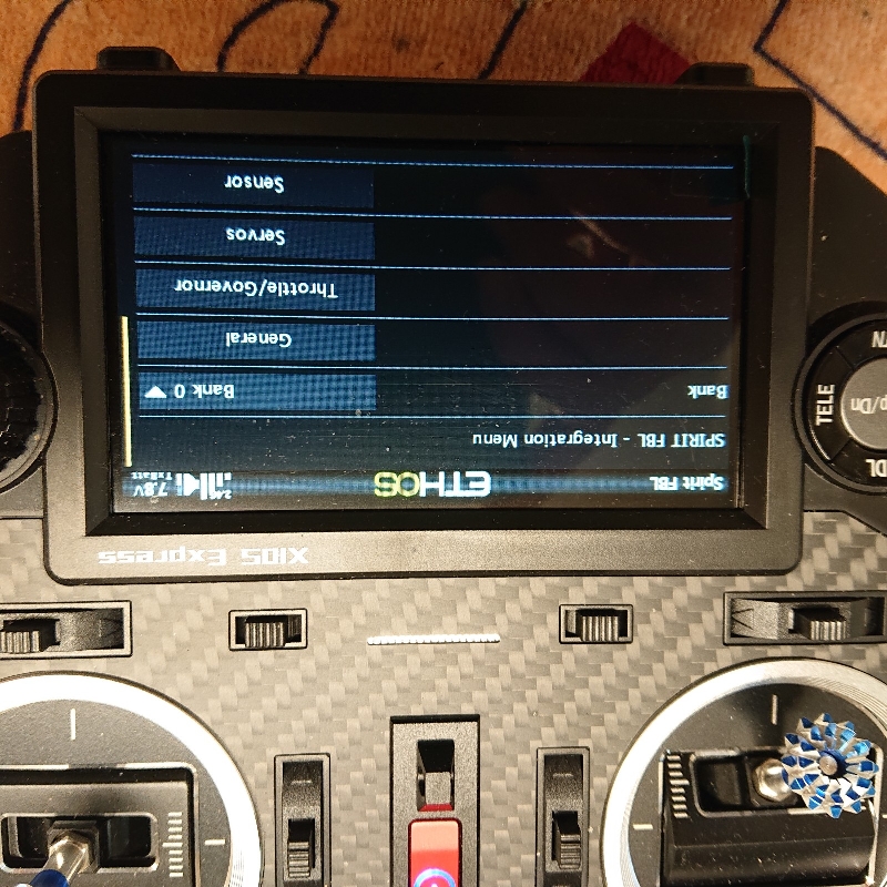

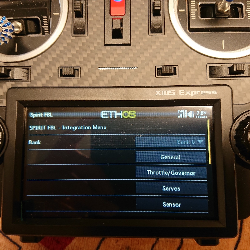

After that I switched my FBL back to FBus and adjusted everything again (without subtrimming) so that all displays were calibrated to 100 again, of course I had to restart the FBL, re-enter missing functions with the corresponding channels and delete all telemetry sensors and start again - After that I had to set up the telemetry screens in my remote control again - After I had tested all the functions and everything was fine, it was time to test the new script for the FBUS protocol - Unfortunately I wasn't very happy - after everything seemed to be active (not grayed out) when the script was started, but as soon as any sub-item was selected and you were in it, all values were grayed out, nothing could be changed, no matter whether the Archer RS was set alone on FBUS nor the Archer R8 Pro alone, still combined as a redundancy system, the behavior was always the same. At first everything seemed ok, but if you switched to a sub-item, nothing could be changed there (greyed out or provided with a question mark) - if you went up one level again (entry), the bank, which was white before, was also grayed out, so it could not be changed, there was also no query as to whether changes should be saved, but it was terminated "without comment" - I tried to create photos that reflect the behavior so that you can imagine it - I am attaching the photos in the same order - unfortunately that has new script did not lead to the hoped-for result for FBus, which I find quite a pity - I switch back to FPort to be able to use the script at all, because without integration a whole piece of comfort for "on the field settings" is missing - I don't know what could be causing this, I only know that this is quite frustrating - maybe the developer at Spirit has another idea what it could be...
Best regards
PS. I am attaching photos of the integration with FBus and look yourself...

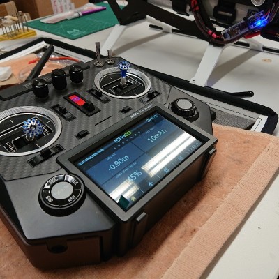

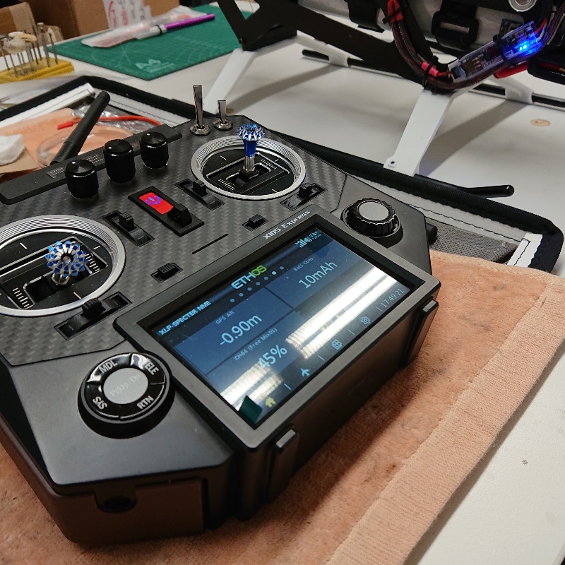

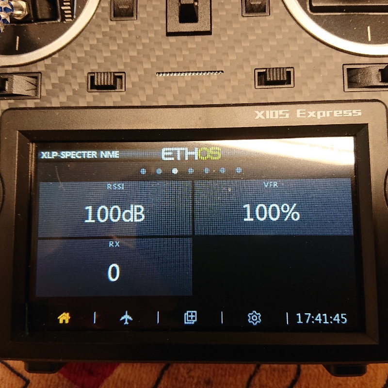

Posts: 643
here are the pics, as announced:
to be continued...

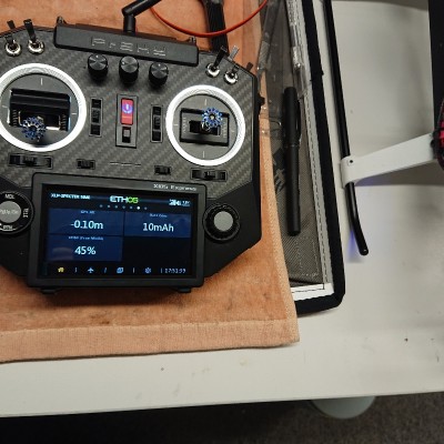

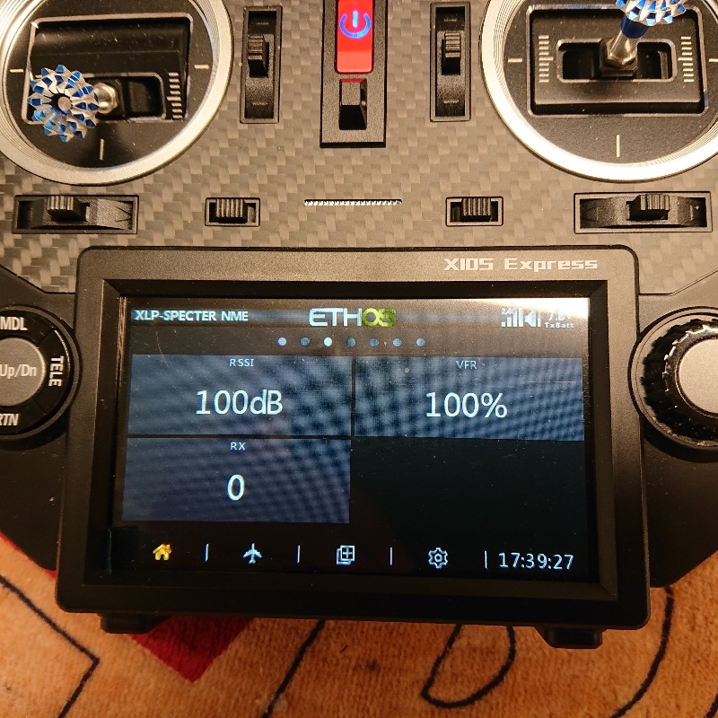

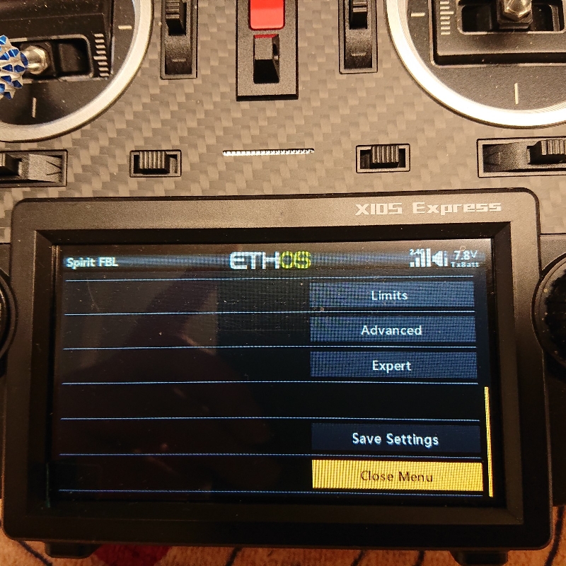

Posts: 643
here more:
Posts: 643

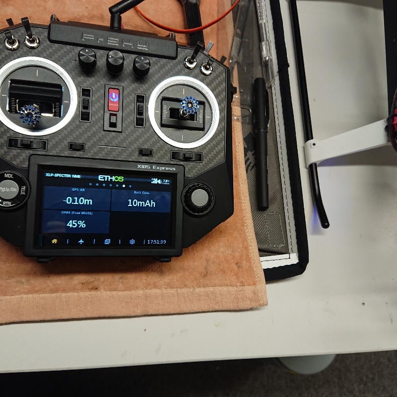

here more:
In the last two pictures, you can see quite a drift in the altitude, that's a bit strange, isn't it?
The heli was on the workbench the whole time...
