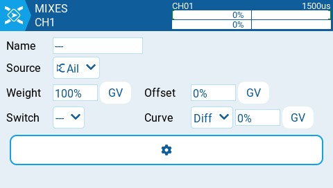

go here
above exit the values usec at a minimum, centerx, max stick.
Can you show me the 3 positions with a photo for example take the values ​​for aileron and elevator.
My radiomaster tx16s mak 2 max mount the ag01 and I REPEAT YOU that I had to move the screws why some sticks they were not centered mechanically.
This type of stick it has the adjustment screws on the front and rear.
But these inaccuracies with re-calibration they adjust.
changing from mode 2 to mode1 i had the same problem in the center stick and after I solved
This radio does not send 1000 usec at min .
Let's go step by step and for now let's see the values ​​from that menu that I showed you
