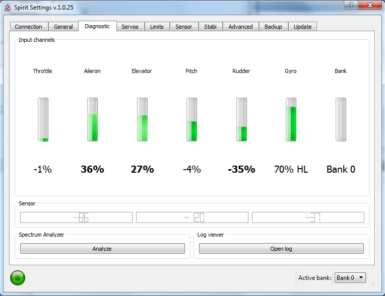

Hello Zexx,
I have done some testing which included updating to 1.251-5.
The diagnostics page displays the failsafes as expected when the TX is turned off.
I have included some screenshots to show this.
Rudder is being sent as expected, however I believe that I have the same symptoms as JMann.
The tail servo starts twitching and moving very suddenly back and forth when I attempted to download the log files with the TX turned off.
I then removed power from the Heli & turned TX back on & it seems ok.
I hope that I can roll back to original 1.25 :)
Note that I had been turning the TX on/off frequently to get the screenshots, but it was not until I attempted to get the log files that this happened.

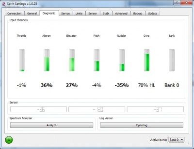

Diagnostics page with sticks at random positions, TX is on

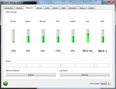

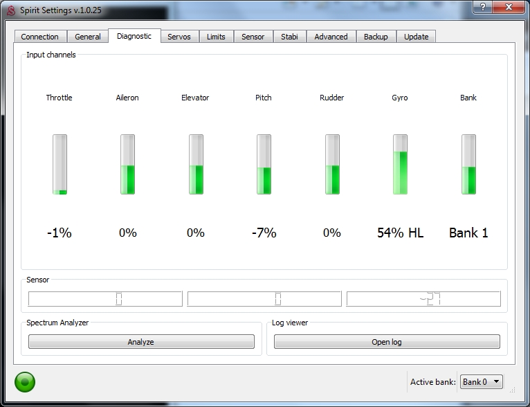

Diagnostics page with TX turned off & normal failsafe settings being sent

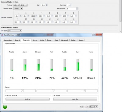

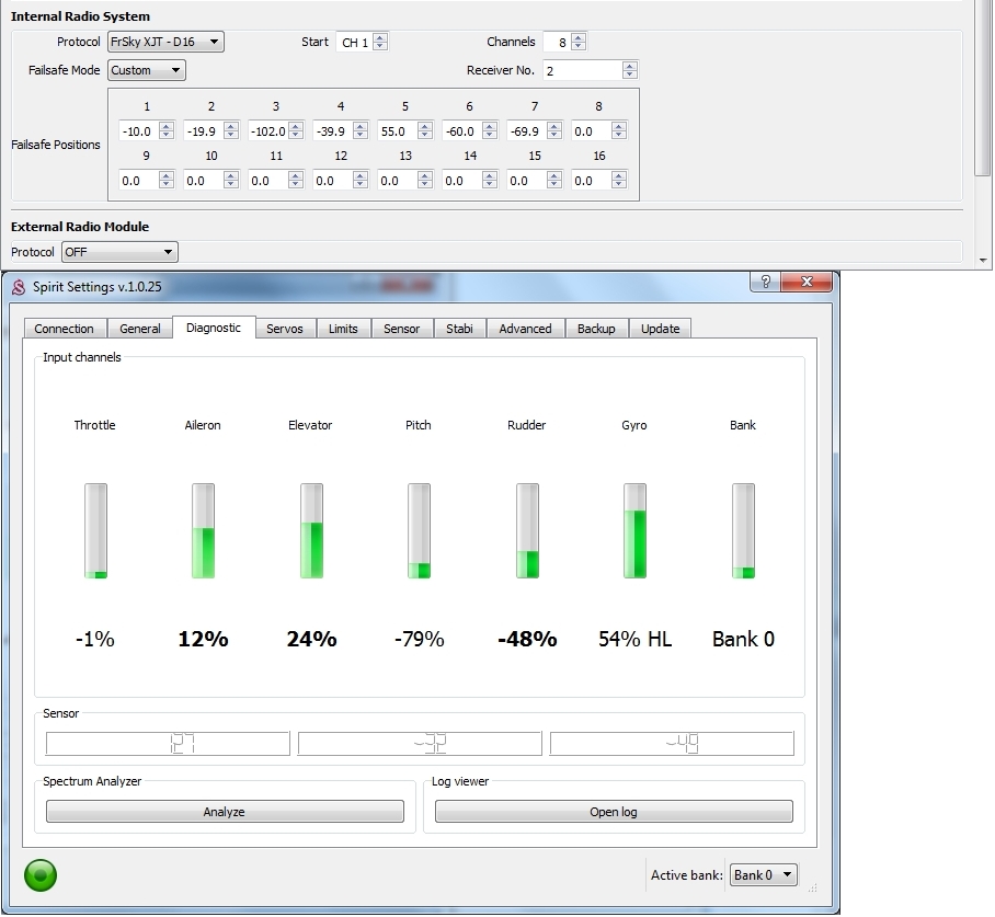

Diagnostics page with TX turned off & "Custom failsafe settings being sent"

That was a screenshot from opentx.
It's at the bottom left of the Setup tab (the first one) for the model.
I read in the current models of the radio, made the changes and wrote it back.
