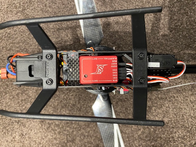

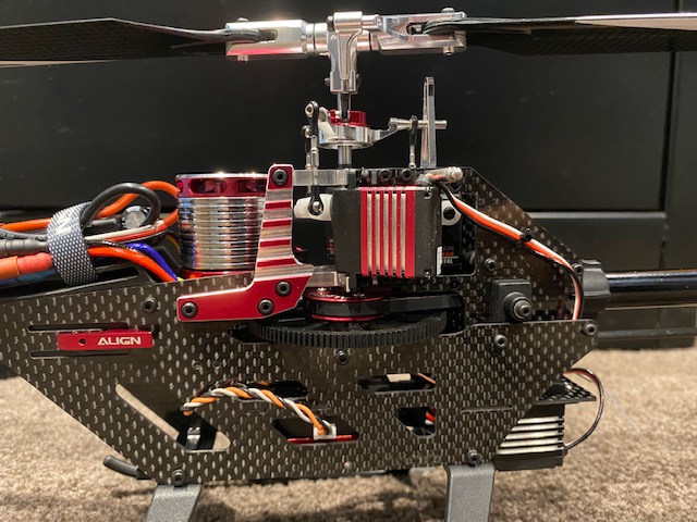

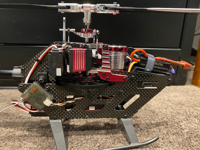

I have just purchased a brand new T-Rex 300x with Spirit 2 and GeoLink. The T-Rex is completely standard and I have mounted the Spirit 2 upside down under the rotor main shaft, parallel with the main blades and the tail boom. My Radio is a Spektrum DX9 Black and the rx plugged into the Spirit 2 (in SAT1) is a Spektrum SPM9745 DSMX. I have not installed the GeoLink yet as I want to get the Spirit 2 running properly first. I have attached pictures of the install.
I loaded the Spirit Settings app on my Macbook Air with Ver 3.0.0 which I installed on 15 Apr. I ran the setup wizard and bound the rx, leveled the swash with reference to the main shaft (not with the floor since the heli has inclined skids), and zeroed-pitched the tail rotor. The stab mode is in Stab Scale and I'm using the gyro switch (D) on the DX9 Tx with +100%,0%,-100%. Presently, everything appears to be working nearly ok just with a low hover in my indoor lounge. I'm not very experienced with stabilized helis yet (also have a fully working T-Rex 150x) so just want to take things slowly and carefully.
Even though I leveled the swash (with reference to the main shaft), there is a tenancy for the heli to want to slightly drift in the hover. I also have tail wag at the rate of about 4 or 5 shakes per second with the gyro switch in -100%, but it diminishes in 0% gyro (switch middle position). I haven't tried it with switch in 100% gyro position yet as I though this would turn off all stab and not keen to try this indoors yet.
I am seeking help with 4 questions for the group:
1. Should I continue using ver 3.0.0 or go back to 2.8.0?
2. How should I reduce the tag wag?
3. When connect the battery and allow the heli to settle before flight, should I do this with its normal skids on the floor position or should i incline the heli by 5 degrees so the blades are level with the horizon?
4. Am I missing anything else?
Thanks for the help.
Tony
