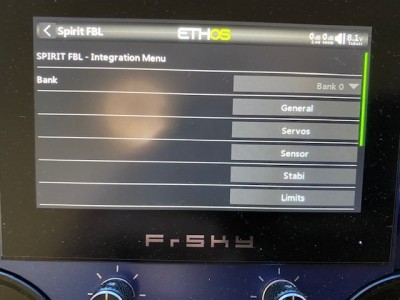

X20S HD 1.3 Ethos. 2.2.2 spirit Gt. TDMX Receiver (2.4 & 900)..S-bus wired to rudder.. S.port wired to System, red wire removed, configured to F-Port but unable to change scripts at all. Nothing, but servo operation as normal.
Does anyone have a positive grip on wiring please?

Hi and thanks for your reply, i have that set up on another spirit gt, running full telemetry from hobbywing 200a plat 4. same TDMX Receiver but still no set is able to be changed, all the scripts are readable but nothing can be edited.

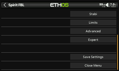

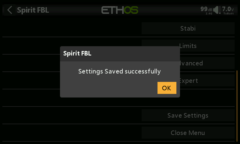

thank you for your reports!
Today we released updated scripts with improved Save Settings button - previously there was no notification so people might think nothing happened. Now you will see notification dialog.
Added button for Closing the script directly.
Link for new scripts: https://spirit-system.com/dl/ethos/spir ... .4.3r2.zip

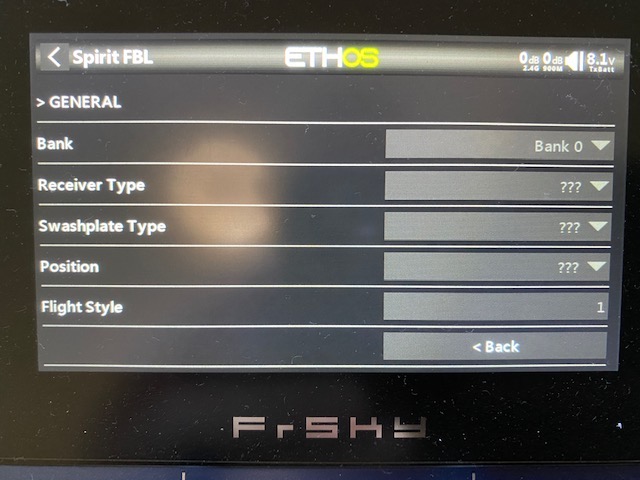

Ethos 1.3 hw1.4.0 fw 2.2.2 rec= TDMX 2.4/900 F.Port -Rud Spirit Gt. 3.4.3
Still no change for me with the updated files, nothing is being read, nothing to adjust.
You should see a telemetry variables sent from Spirit unit first - in the Model - Telemetry screen.
All variables coming from unit should be visible there. If not, then the telemetry does not work at all.
For example RPM, Fuel and GPS Alt sensors.
kim hill
Posts: 29
Joined: Mon 04. Jul 2022 19:57:03
all telemetry is working fine, from hobbywing through the sprit.
Then I guess the only thing that could affect this is EthOS version, used receiver and its firmware.
We have not tested TDMX receivers yet, so it is hard to say. It is possible these receivers require more recent EthOS version.
