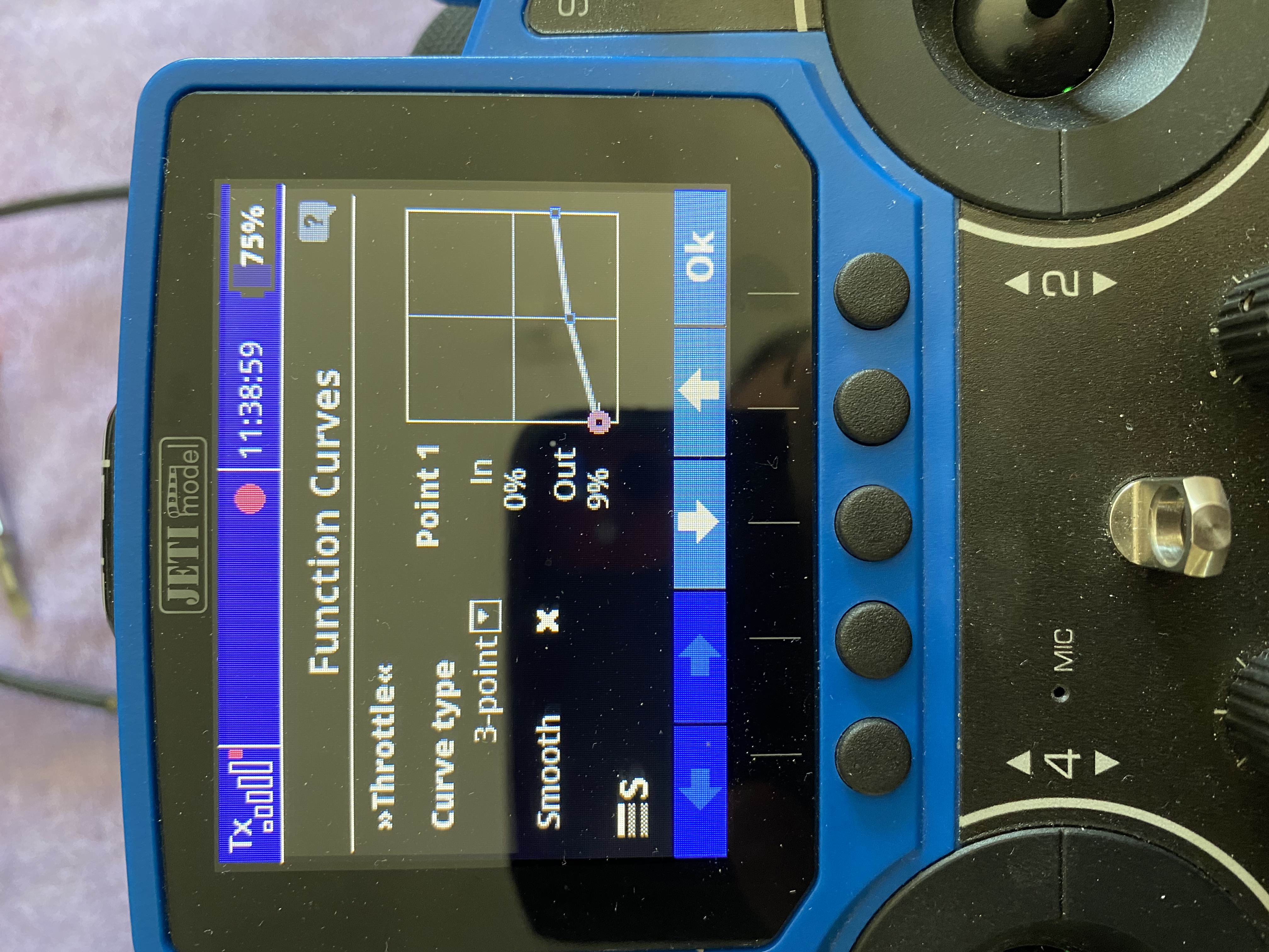

Well, I do have an idea, and it's something about how your set up and mine differ. My flight modes are throttle hold, normal, IU1, IU2
Throttle hold is 11% flat curve (constant)
Normal is 3 point 9%, 28%, 32%
IU1 is 81% flat (constant)
IU2 is 90% flat (constant).

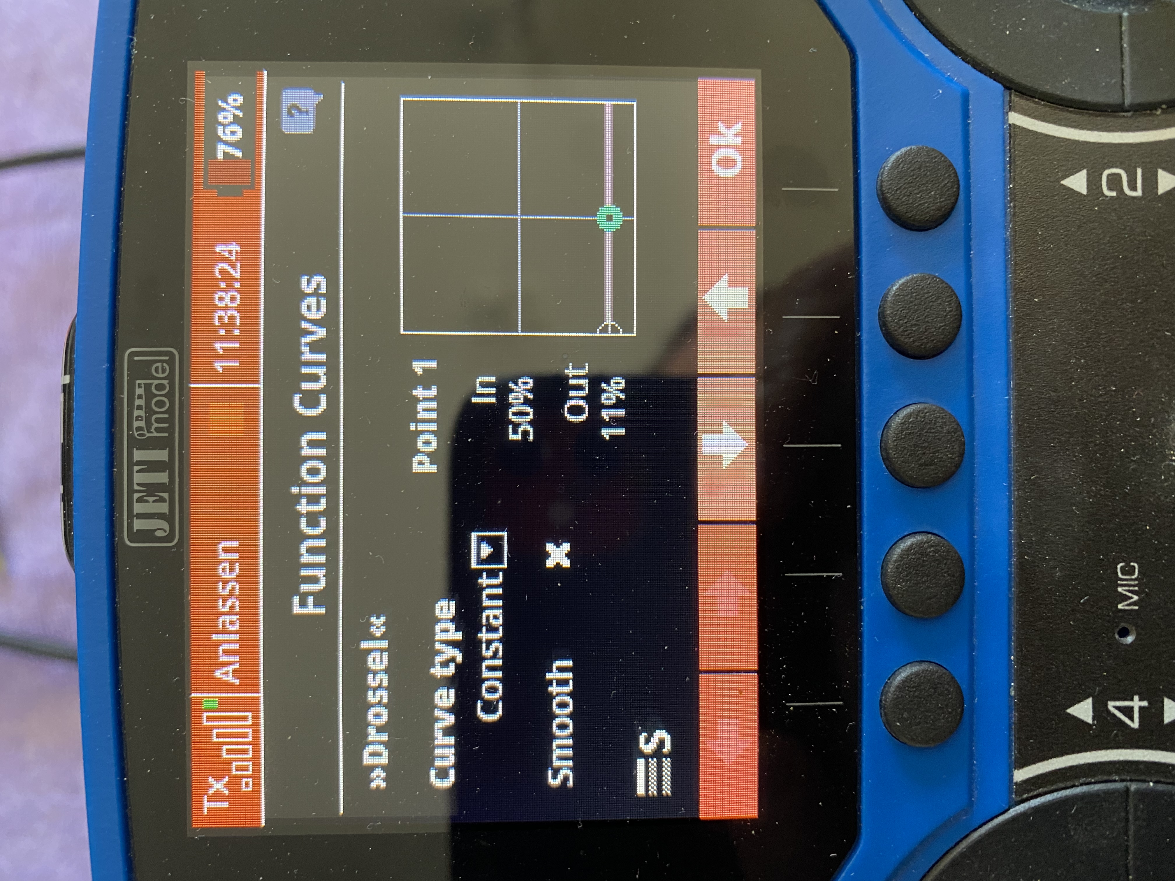

Your normal is flat curve (constant) 11% constant.
Aside from the obvious flat vs 3pt curve is the input value of the graph on the right, yours is 50% input and 11% output. Mine is 0% input and 9% output.
The idea, is that maybe this input of 50% input is causing confusion to Spirit.
There are a number of other pilots here, so, please check your systems, if your set up is the same as Kay (that is Constant normal up and input of 50% (and you fly Jeti)) and your gov works fine, then chime in, cause that would automatically mean my "idea" is wrong.
If you are wondering how/when I switch to IU1 it's in the air after I've established a hover. Mine is a behavior that is a holdover from the early days of FBL when helicopters had a tendency to tip over on throttle up. I get that my set up is not what is suggested in the Wiki.
Good luck

Hi Scott,
well, I'm sorry probably I didn't catch your Idea correctly... You mean the 50% that is shown at the curve setup in the DS12? If so, from my point of view this value never is transfered to the spirit, it only sees the corresponding absolut servo position of each point of the curve.
If I understand correctly, you are using the trottle hold for starting the engine, and after the engine is running you use the 3point curve for "manual spoolup", take off till hovering. After that you switch to IU1 or IU2. In that case the difference between your setup and mine is the difference of the current servoposition to the requested one.
I have also a 11% idle (flat) curve for engine start. The direct servo output sent to the spirit is than a value of -75% (channel 1 output of the transmitter). As soon as the engine is running, I switch to 80% flat curve what should activate the gov and tell the gov that I want to have ~1630 rpm. The corresponding servo output on channel 1 is now 65%.
In your case as it seems to me that you activate the gov at hoovering, means the trottle current position is much closer to the value the spirit would have to set it. This is valid for both the channel 1 output at this moment and also for the real servo position. Your gov would probably need less time for adjusting the requested rpm. This is interessting, I will check, first programming a much slower rpm, and seeing if the gov is struggeling if it takes to long for complete spoolup from idling. I also could try a 3point curve also for hovering and activating the gov at this point.

Here are two screen captures from my model and yours.
The input of 50% is what is was seeing. But I don’t know what it means or if it impacts anything since it is t an output.
