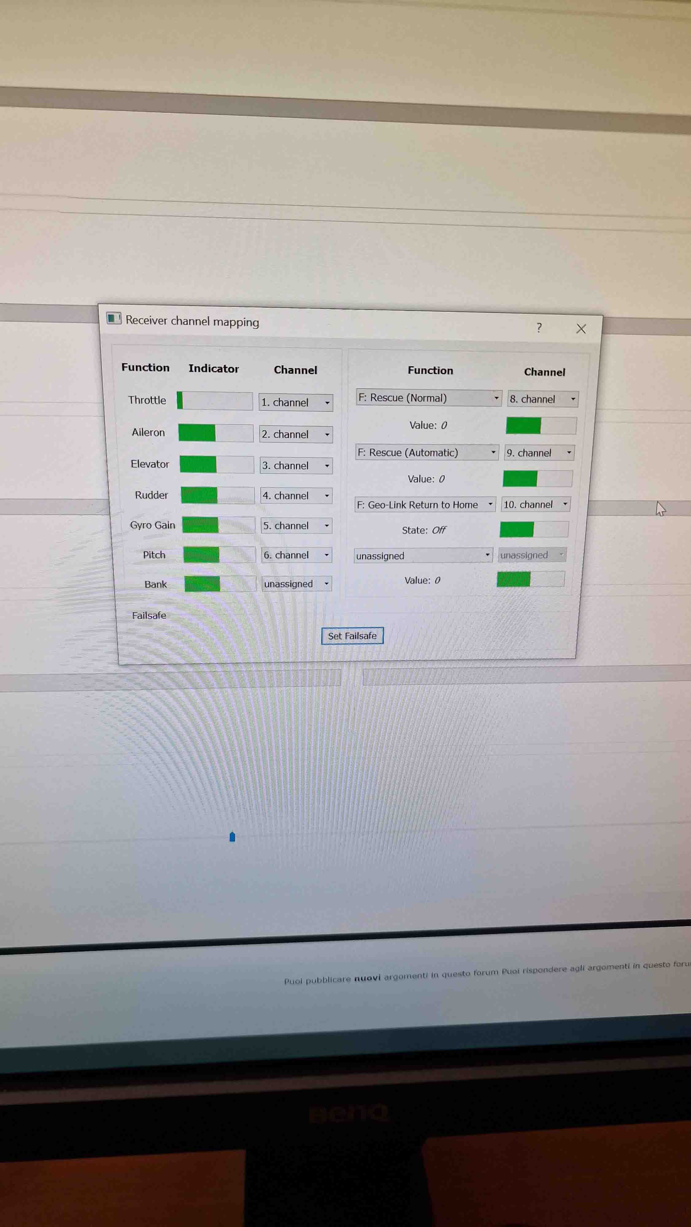

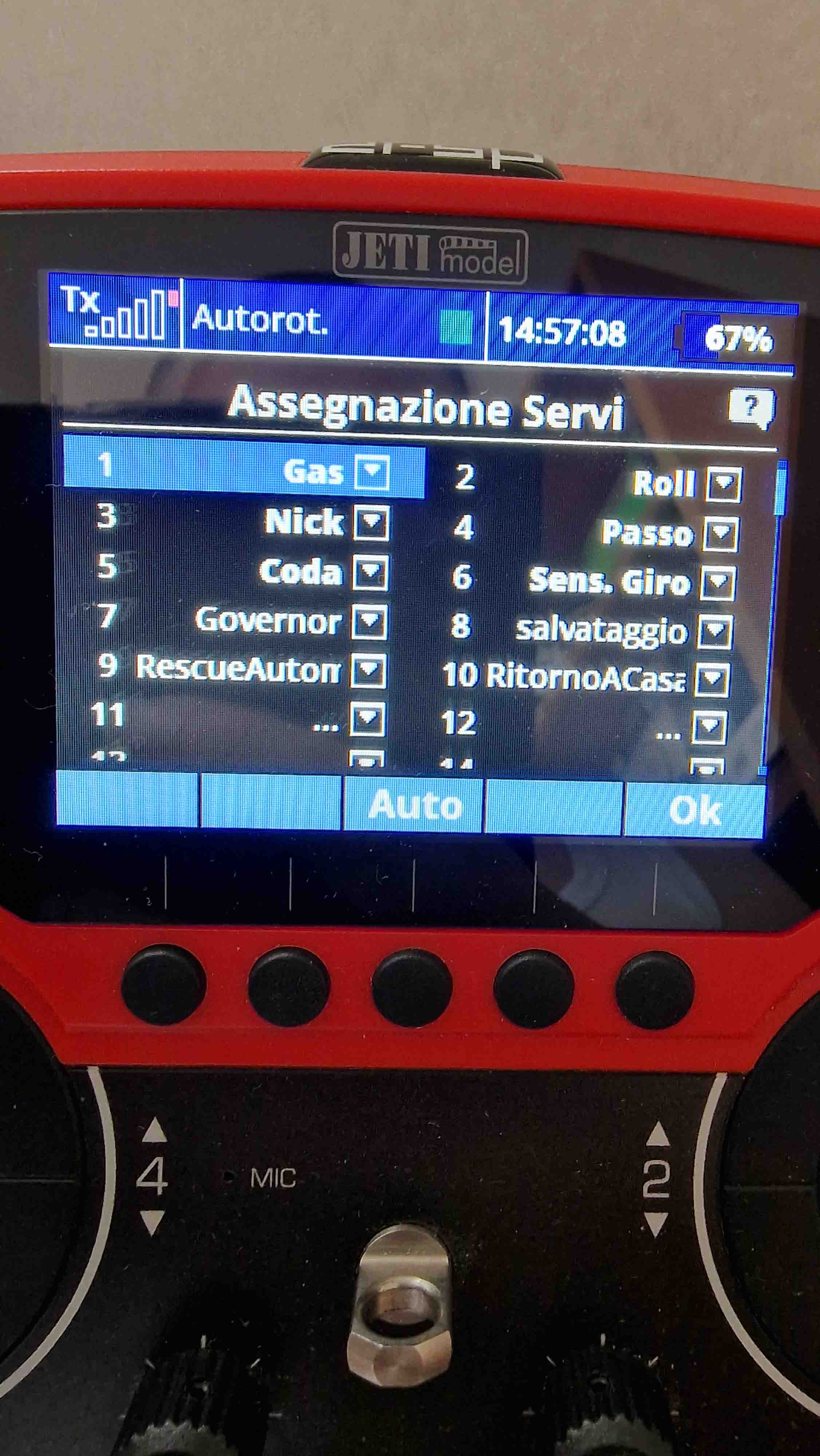

franz88
Posts: 343
because in my radio and in software spirit do channels 4 to 6 not match?
helicopter fly well
