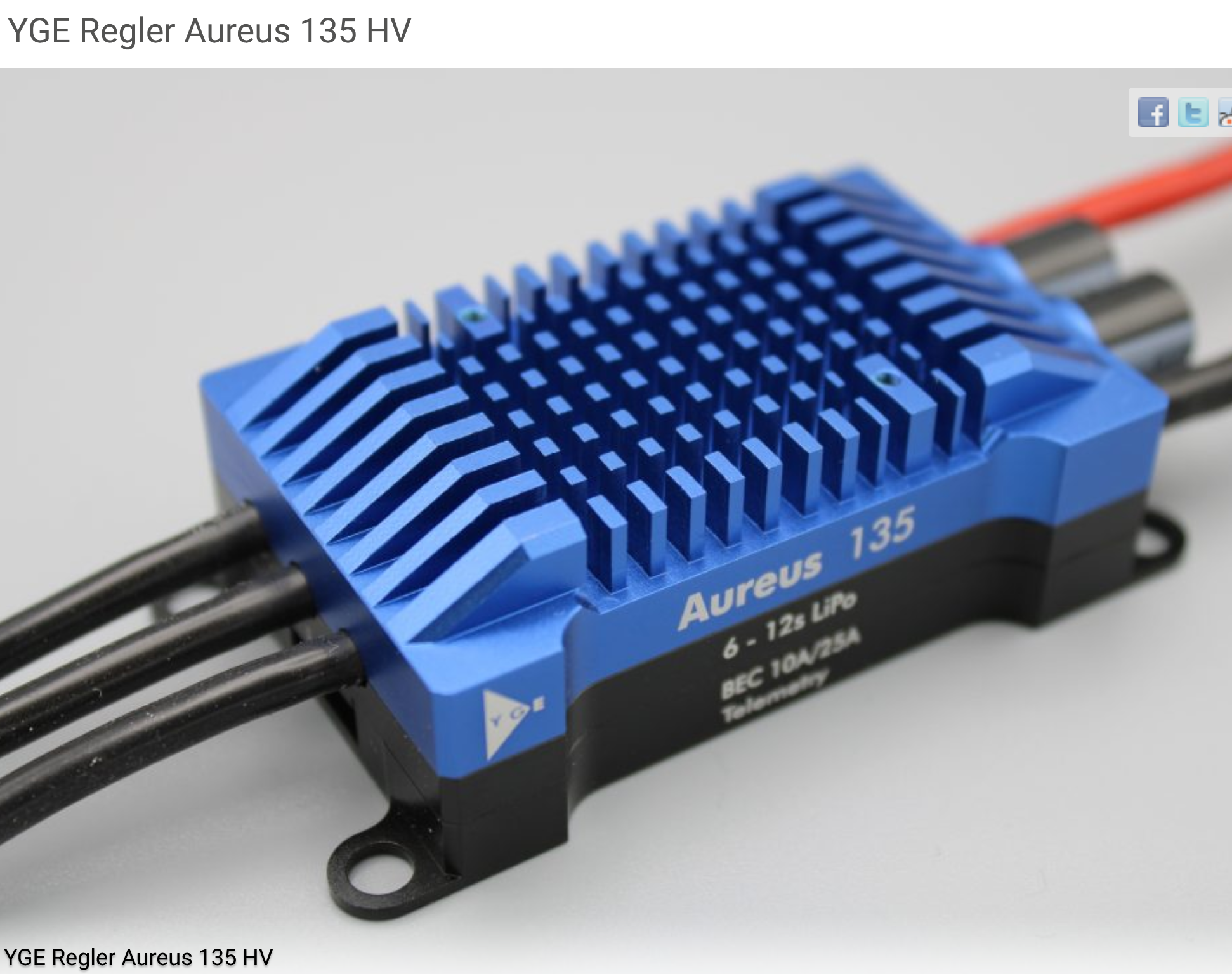

with my configuration doesn't work with the new firmware 3.7.0r2, like with Firmware 3.6.2 !
Telemetry hang from YGE Aureus 135 a short time after start and no stick reactions as by firmware 3.6.2 -
Back to 3.6.1 and all works fine including Integration (Script 3.5.0 r2)-
My config:
ETHOS 1.5.7 or ETHOS 1.5.9 the script (3.7.0) does not work with 1.5.7 and firmware 3.6.1 - with 1.5.9 also not because of the other problems (with firmware 3.7.0r2) (sensor lost after short time and no stick reactions)...
My config:

thank you for your report.
We will get same YGE on monday and try to fix it as soon as possible.
