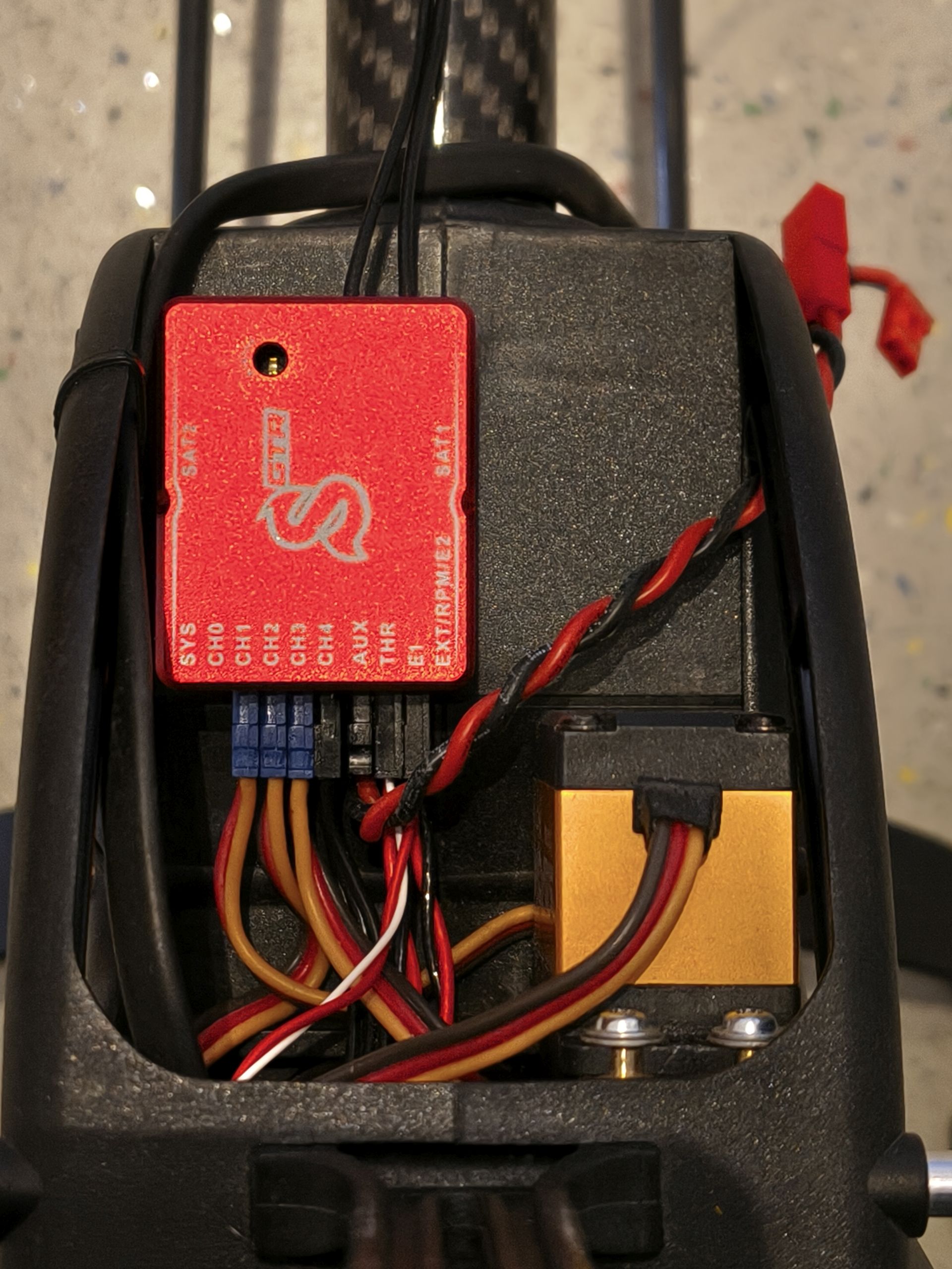

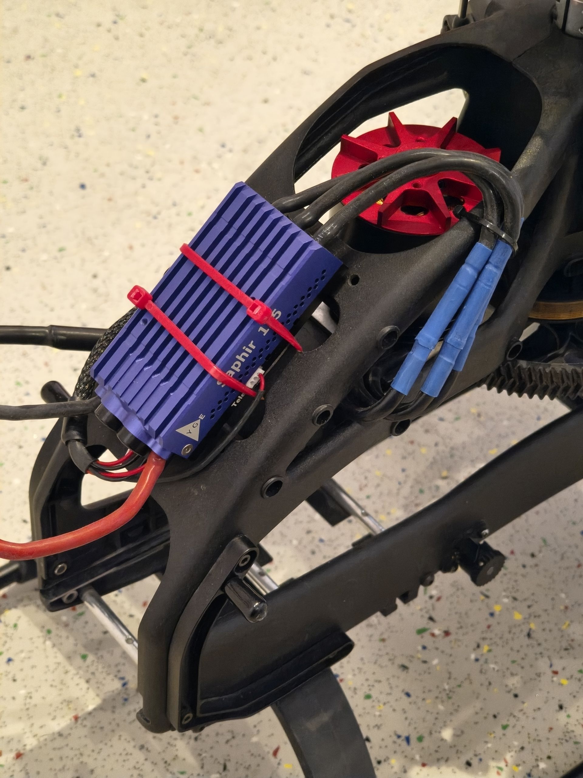

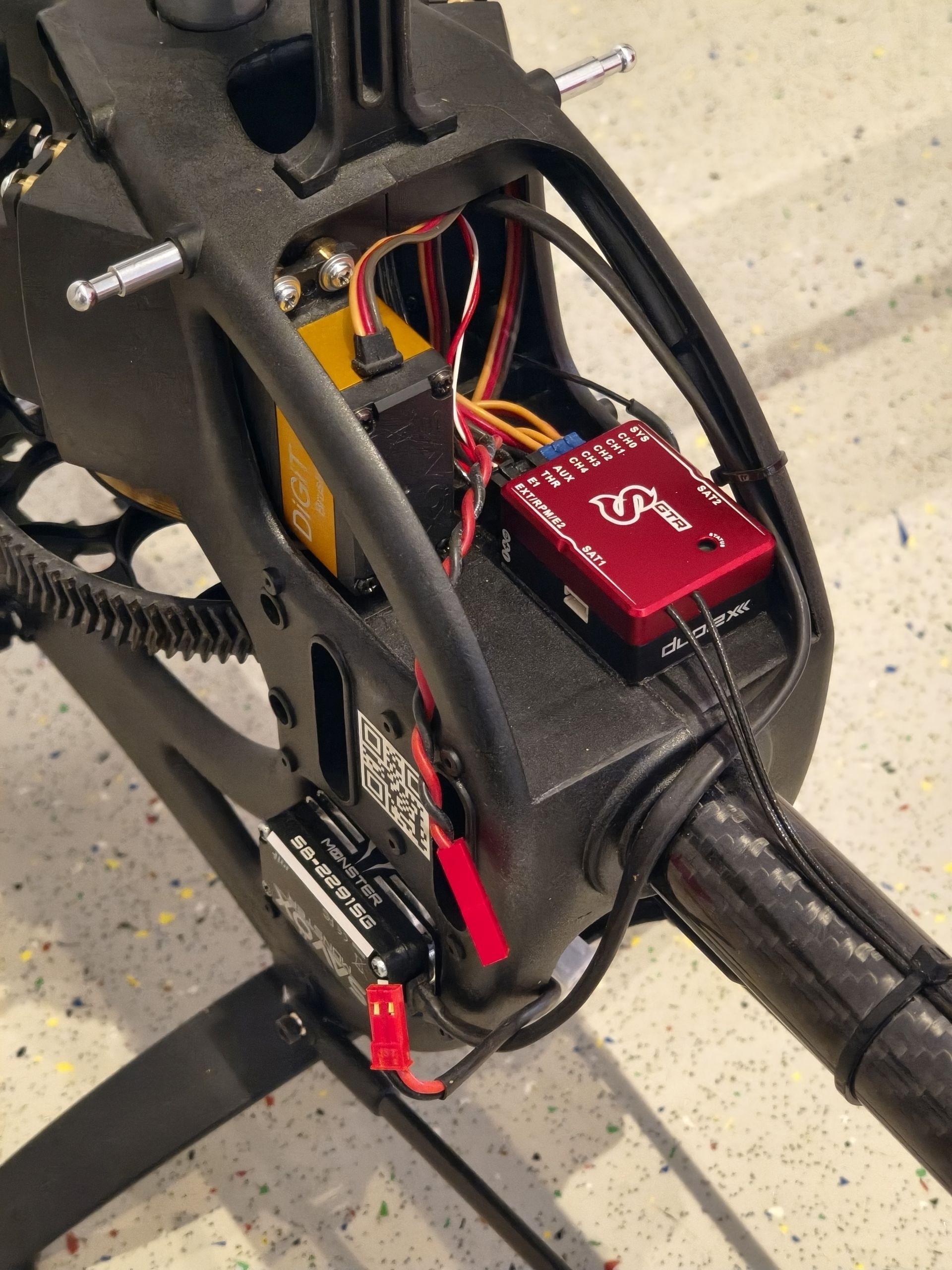

The heli is a Logo 600 SE, motor a Xnova 4025-830KV, ESC a YGE Saphir 125, servos are all Savöx Brushless, 3x SB-2271SG at the swashplate, tail is SB-2291SG. RC power runs at 7V, from YGE's BEC, buffered with a 300mAh LiFe battery via Spirit's AUX . There are no external sensors connected, just ESC telemetry is fed via Spirit's E1. Equipotential bonding is installed, resistance between tail casing screws and motor mounting plate measures around 3.0Ω.
Αttached three settings backup files, one for each bank, plus three pictures uploaded with the next posting.
Regards Philipp

Piro consistency seems very high. Tail servo endpoints seem uneven as well. What ball link distance do you have at the tail servo?
I assume the BEC Tester gave good results, the wires seem a little thin, but i can be wrong here.
