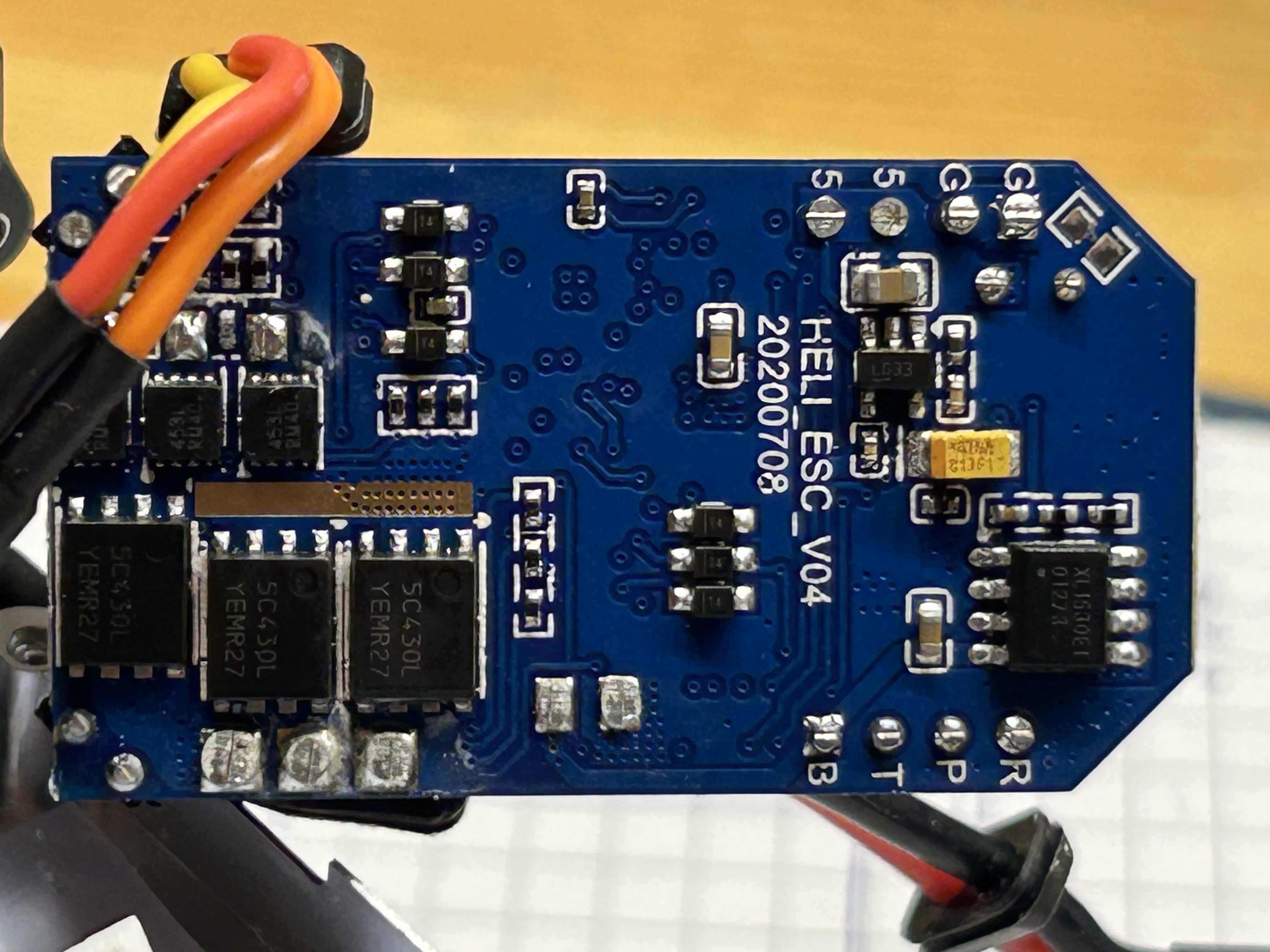

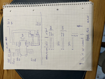

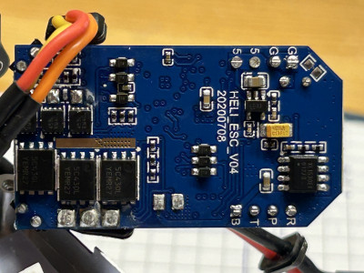

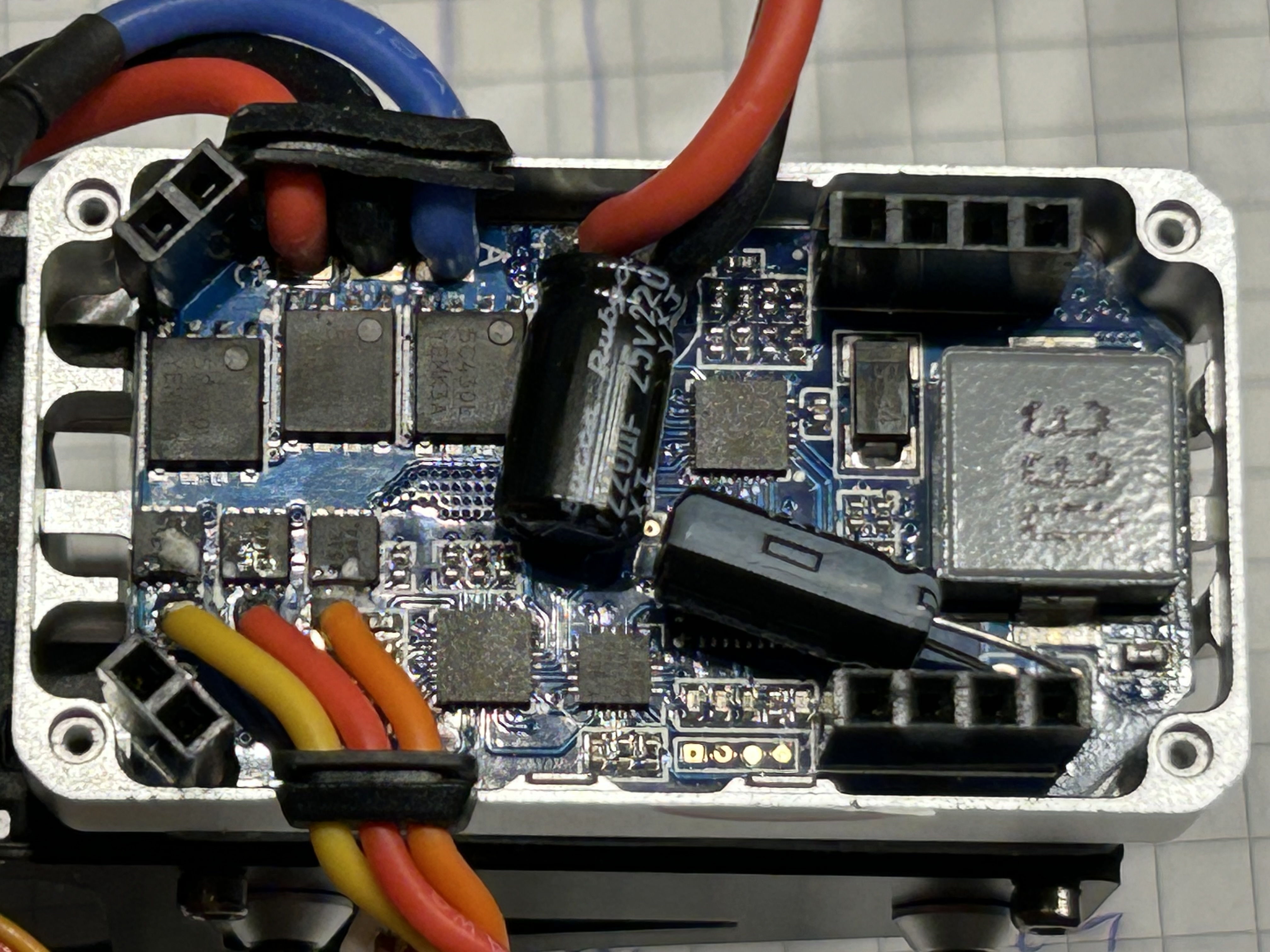

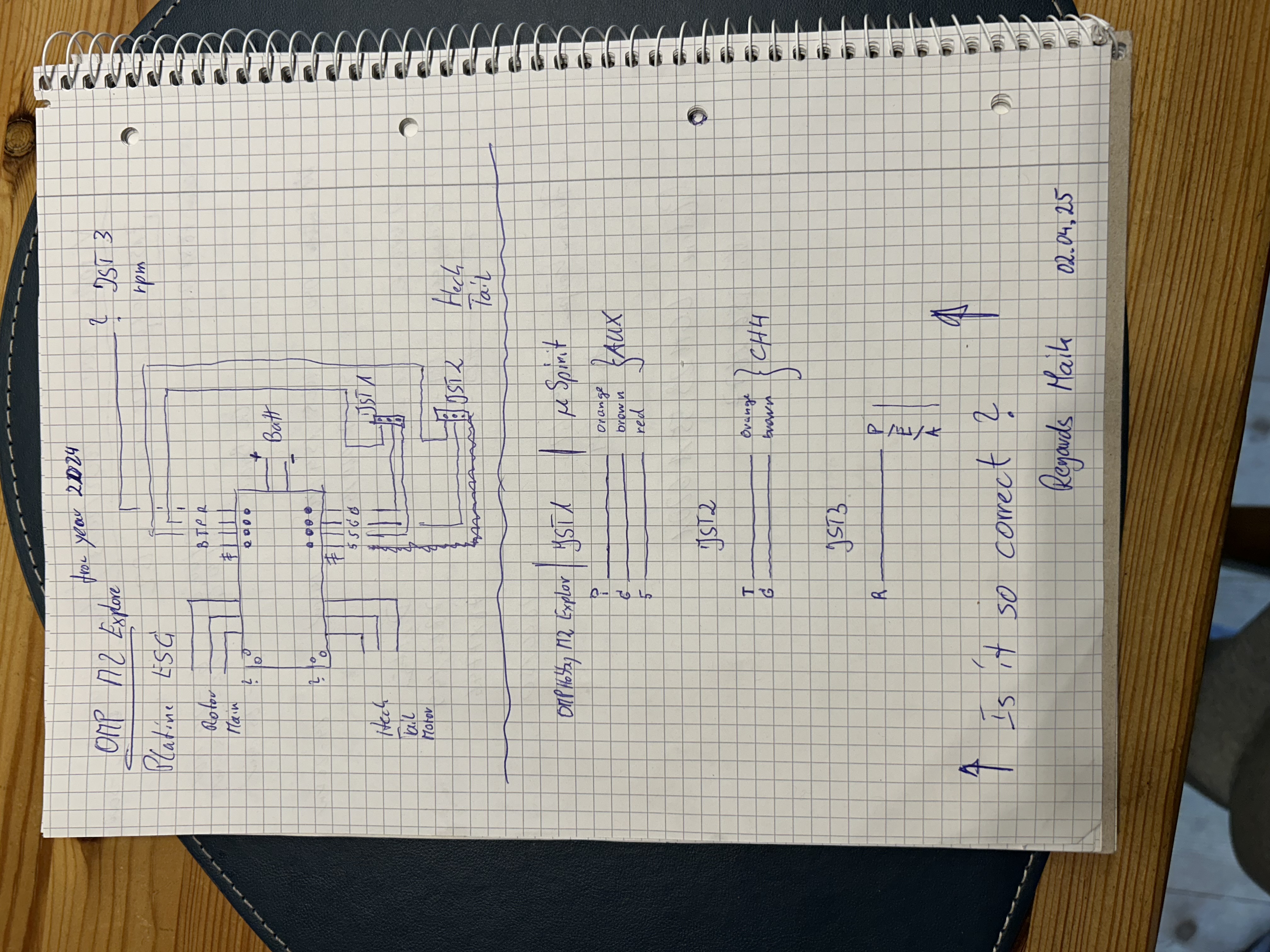

My name is Maik from Germany and I bought an omphobby m2 heli last year to practice.
With the settings and programming of the fbl system I have my problems.
Since I already have a spirit gt in my 700 scale heli, the m2 should be converted to the uSpirit. I have already pulled a lot of info from daniel-i his thread.
I am concerned here with the pin assignment of the omp esc. I once made 2 pictures of the esc and created a cable / pin sketch.
Please, is that so correct?
Regards Maik
