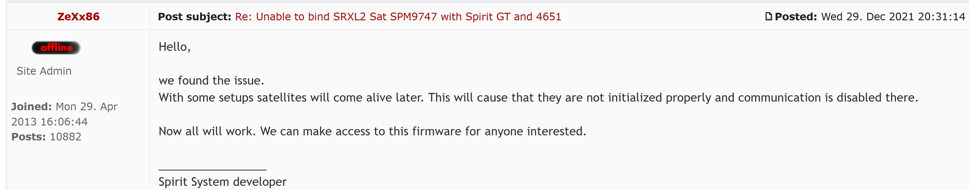

we found the issue.
With some setups satellites will come alive later. This will cause that they are not initialized properly and communication is disabled there.
Now all will work. We can make access to this firmware for anyone interested.
