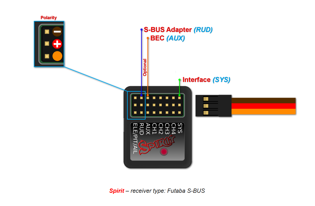

I am so confused. The manual is really not a great help for me. Does that mean I can use a Tracer receiver, switch it to Sbus output, connect it to the Spirit unit and fly my helicopter?
I was not aware of that. Would I need the Sbus adapter?
For right now I don´t need the Lua Scrips or telemetry. All I want is flying again.

As I said the manual is not a great help for me. The only thing I see is the Futuaba SBUS connection. That doesn´t tell me anything about how to connect a TBS Reciever to it. What is SYS and what do I connect to BEC (AUX).
