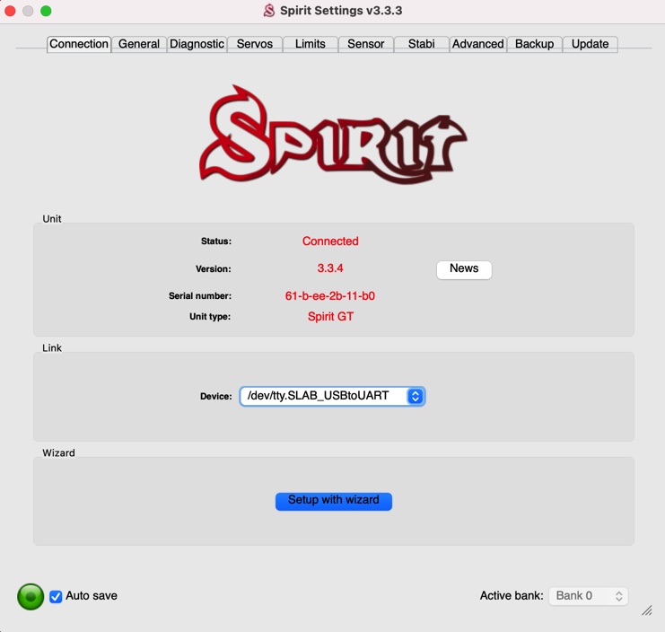

OK Tomas, I've now updated my GT to 3.3.4 - thanks!
After some more testing I have found:
The new firmware has partially fixed the issue. as long as telemetry is disabled, the 9747 (connected to either SAT1 or SAT2) will take over from the 4651T (in AIL port) immediately. There is no failsafe and the handover is seamless.
However, as soon as I enable Hobbywing telemetry the issue re-appears. The model again goes to failsafe if the 4651T is unplugged.
I am very grateful for your help so far, but I need telemetry active. Is there a way around this please?

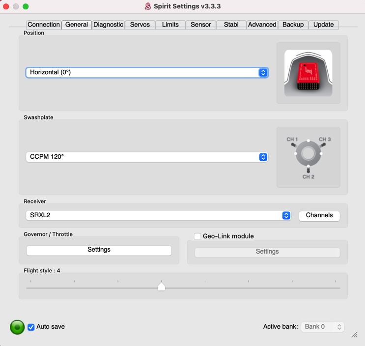

Hi Matthias,
I must be doing something wrong. Still no luck. This is what I've done:
1) I verified the firmware on the SPM4651T and discovered that is was 2.42 (older version). I successfully updated to 2.44 (current version)
2) I connected the SpiritGT to the Spirit Settings Software (Version 3.3.3) and confirmed that the installed firmware on the SpiritGT was 3.3.4
3) I connected the SPM4651T to the SpiritGT via the ELE/PIT/AIL port, powered up and confirmed that I had a solid light on the receiver.
4) I navigated to the General page and confirmed that the Receiver setting is set to SRXL2
5) I navigated to the Diagnostics page and verified that all channels are working properly.
6) I removed the SPM4651T from the ELE/PIT/AIL port and installed in the Sat1 port using the Spirit SRXL2 adapter cable.
7) I powered up, connected to the Spirit Settings Software, navigated to the Diagnostics tab and sadly, no channels worked.
8) I attempted the same on Sat2 but no channels worked.
I'm doing my binding via the bind button on the SPM4651T while it is connected to the Spirit2.
I've verified that no matter which port I have the SPM4651T plugged into, the LED on the receiver is solid when my transmitter is on and goes out when I turn my transmitter off.
I've purchased my SRXL2 Adapter cable from Spirit but to be sure I verified that each pin has continuity and minimal resistance and the the pinout is correct.
I must be doing something silly. (I really wanted to help!)
Best
-Eric
