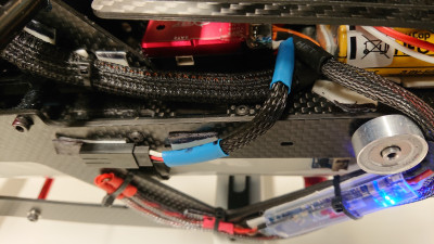

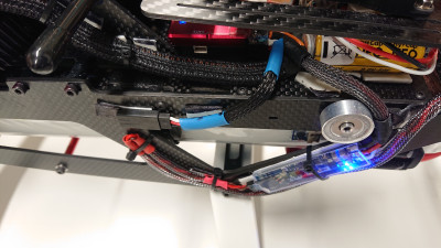

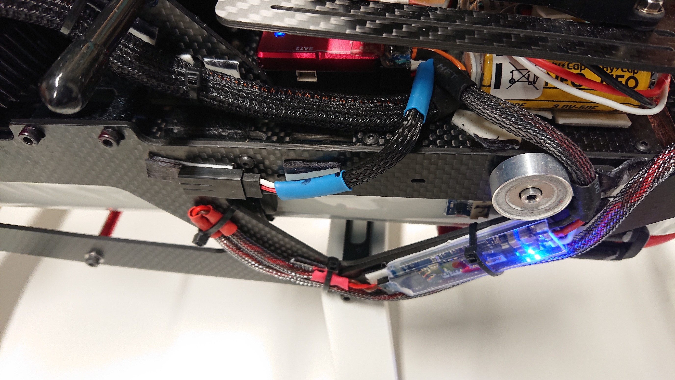

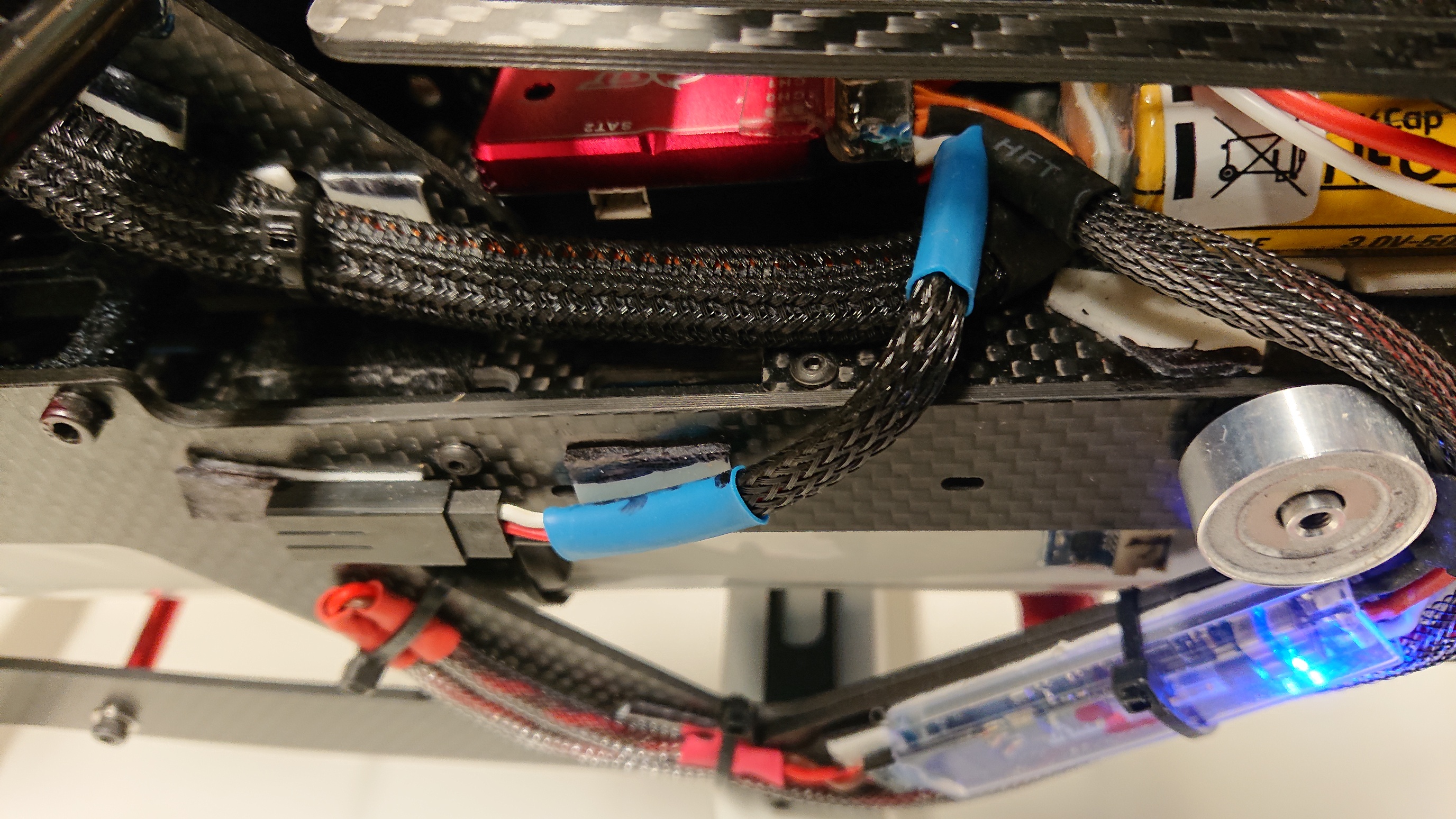

But I have had a strange thing today again - after closeing the Integration without saveing I got a "black" LED again ! Tomas I had that reported to you ! The strange thing all works (sticks) ! After getting back in the integration and immediate closure of the integration I got a blinking blue LED - so I was forced to go into the integration several times until I had a constantly lit blue LED again !
That's really a problem too and that should not be !
The problem with the "black" LED is an satus that shouldn't be at any time, maybe something can happen ?
So I think there must be done something that this integration will work reliable -
I have made some photos with "black" LED and others showing the problem -

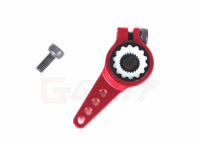

I would love if we would just have a checkbox to enter leveling mode, just like on PC software. This would be great for another reason - it would allow to enter leveling mode without changing subtrims, which is great if you just want to setup blade tracking, or if you level the swash mechanically by these servos (I use them and love them):
What you describe with LED is a different problem. For me it looks like you cannot use "RET / RTN" button at the moment. You have to use buttons in the app (BACK or CLOSE). Otherwise it leaves Spirit in setup mode (blinking LED). Black LED (off) also happened to me few times.

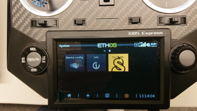

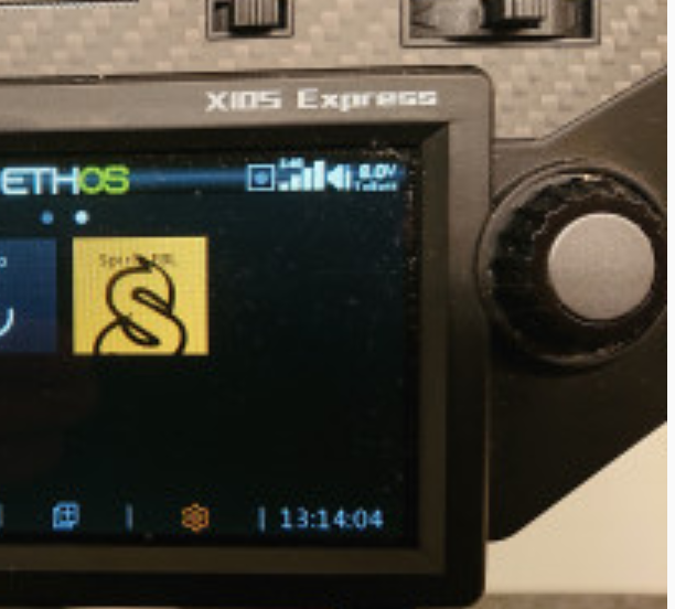

maybe I said it not correctly I don't use the RTN button of the Radio (left) but the right one in the middle of it (the silver one) see on my pictures where my transmitter is shown -
I would not know otherwise how I should do it to set the new value -

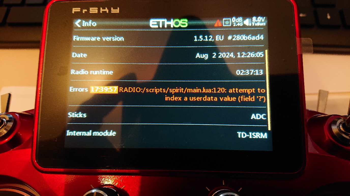

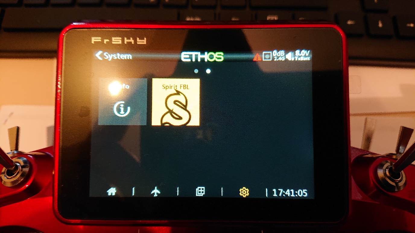

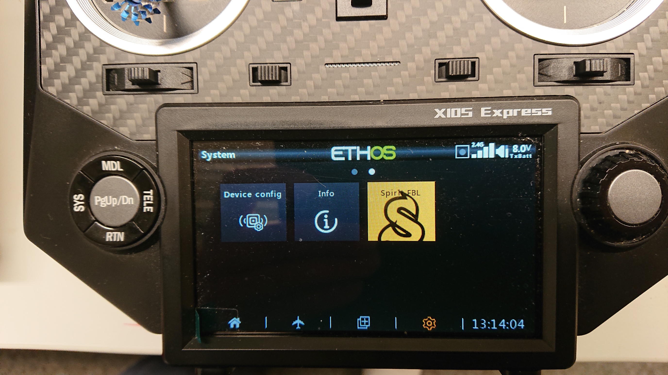

I have updated my FrSky Radios to ETHOS 1.5.12 (Horus X10S Express and Tandem X18SE) the Integation script gets an error (red triangle), see added sreenshots - in ETHOS 1.5.11 all works fine - I think there must be changed something that it works correctly again - For Information, the red triangle means stop the script that we dont get an EM (emergency mode) on the transmitter - I think this is a serious mistake that should be quick corrected - so the integration is not usable as it is unfortunately!
Tomas I only can give you an information that here appears an error and I hope you can correct the script that it works again -
Here some screenshots added, also with the error message on the screen -
