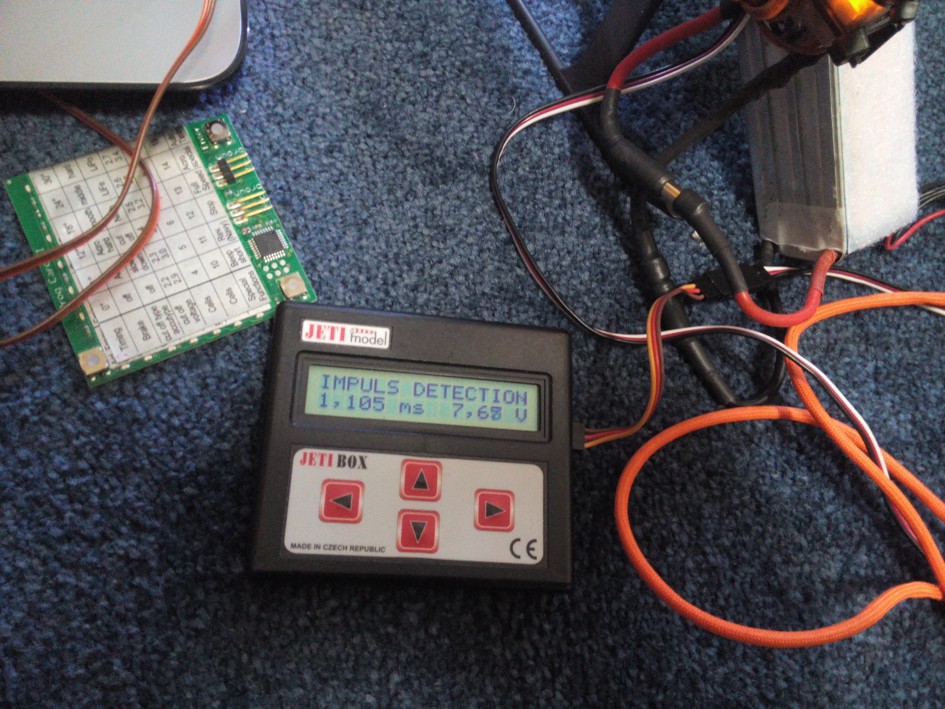

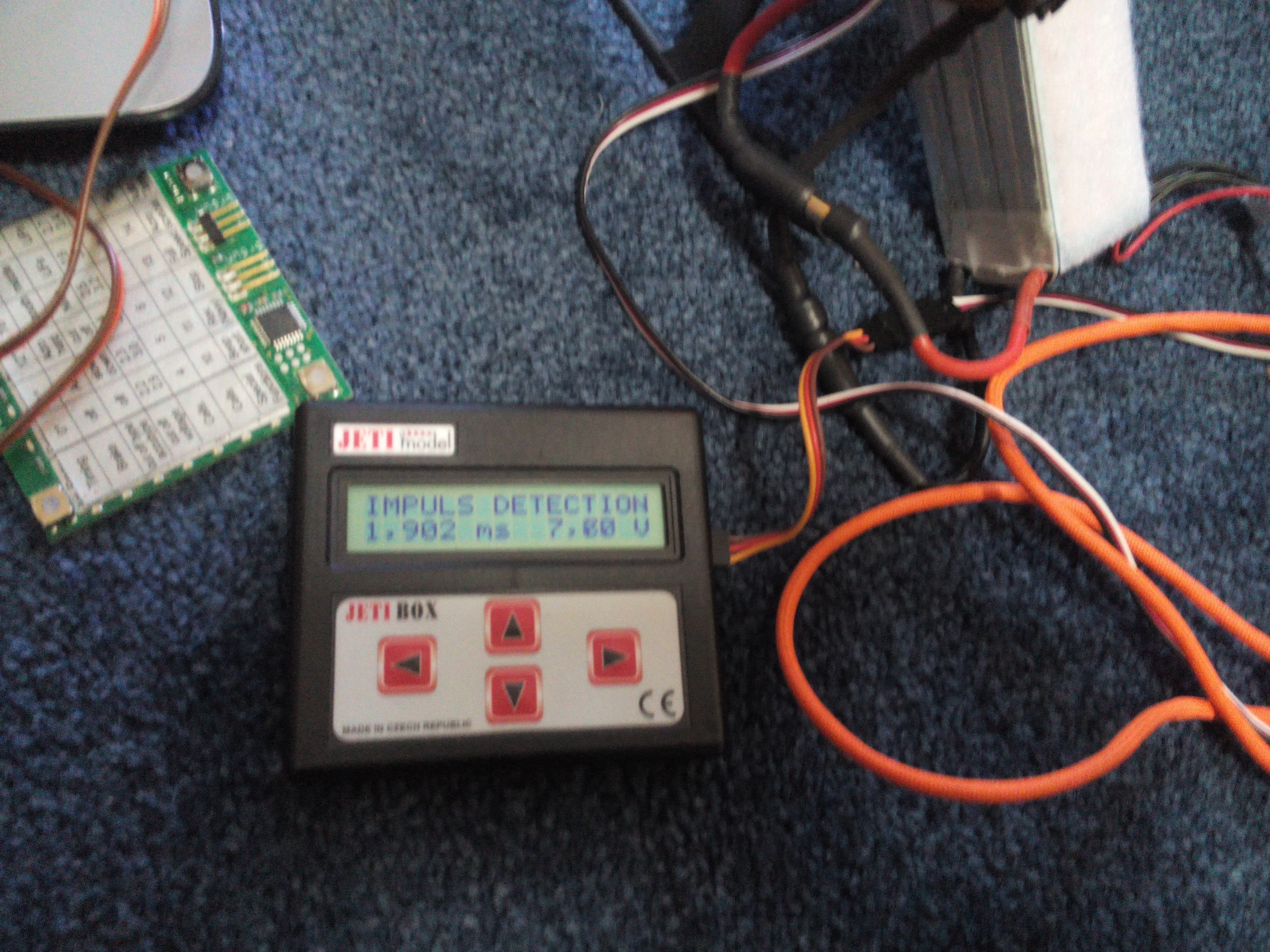

Here are also screens of my measurement of the pulse with gov off at 0 and 100% thr. Endpoints are spot on.
