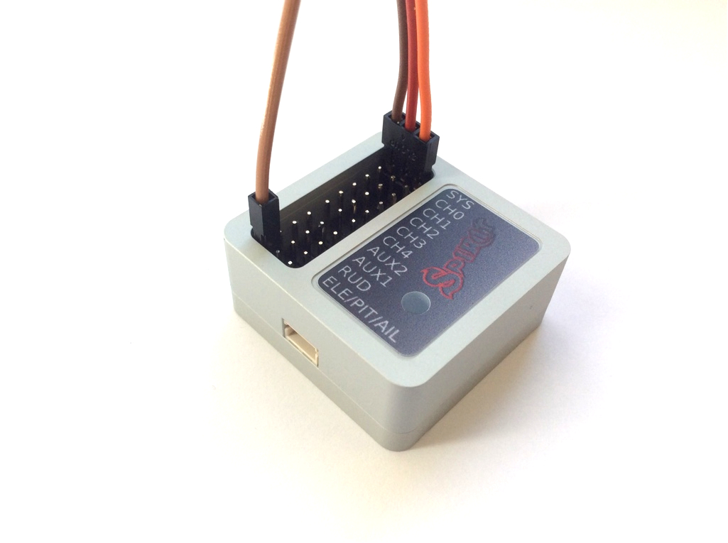

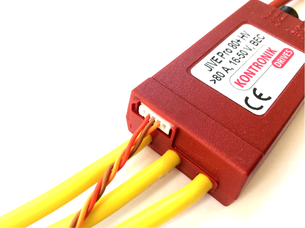

And please the connection plan ??

Hello Gerry,
Kontronik Kosmik/Jive Pro has support for:
Voltage
Capacity
Current
BEC Voltage
RPM
It can be displayed directly on the main screen of Jeti transmitter.
Connection is as per the photo.

Is the single pin on ele ... Is this for the speed

Yes, it is ELE pin.
It is necessary for Kontronik telemetry to work.
