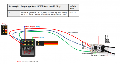

Mike_Snoo wrote:I am so confused. The manual is really not a great help for me. Does that mean I can use a Tracer receiver, switch it to Sbus output, connect it to the Spirit unit and fly my helicopter?
I was not aware of that. Would I need the Sbus adapter?
For right now I don´t need the Lua Scrips or telemetry. All I want is flying again.
IT's in the manual.
You go to output und set a pin to SBUS (inverted)
As I said the manual is not a great help for me. The only thing I see is the Futuaba SBUS connection. That doesn´t tell me anything about how to connect a TBS Reciever to it. What is SYS and what do I connect to BEC (AUX).
Really? You need to make a cable + - and sbus from the pins of the TBS and plug it into Sbus. Bec is, of course, power!
Mike_Snoo
Posts: 48
Joined: Wed 19. Aug 2020 12:50:31
Like this?
jasc
Posts: 61
Joined: Fri 20. Aug 2021 6:12:26
Mike_Snoo wrote:
Like this?
Looks good.
Mike_Snoo
Posts: 48
Works! Can´t wait to get the telemetry update!!
