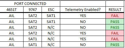

I've been a little bit more methodical with my testing and have recorded the results in the attached image. This is on 3.3.4 firmware.
The pattern here is clear - with Hobbywing ESC telemetry enabled, the model will failsafe if the main receiver (4651T plugged in to AIL port) is unplugged.
If telemetry is disabled, the 9747 will pick up from the 4651T if it is unplugged. One detail I noticed, is that the first time you unplug the 4651T and reconnect it, there is a period of about 0.5 seconds where control is lost, before the 9747 takes over. If you unplug and reconnect the 4651 again, the transfer of control to the 9747 is without delay.
This is repeatable.
This is repeatable.
- SPIRIT SRXL2 testing.png (6.96 KiB) Viewed 9108 times

Understood, and it also does work for me without ESC telemetry if using 3.3.4. With 3.3.3, it didn't matter whether telemetry was disabled or not.Mattes61 wrote:Hello berserkr,
As already said, I tested without ESC telemetry and with a 6-cell NiMh battery, strangely enough it always worked - I did not find that the SPM9747 is activated with a delay for the first time - As I already wrote with Eric something seems to be wrong, Tomas will have to test again, I think -
Obviously I don't know how the Spirit is programmed, but my guess would be that since ESC telemetry is received through a satellite port, it causes a conflict when telemetry is enabled. All speculation of course - I look forward to hearing Tomas' comments on this.

I have it working! As it turns out I had telemetry enabled! My SpiritGT and SPM4651T combination works in all ports as long as ESC Telemetry is disabled (like others have posted).
I guess the good news is that we're all seeing the same thing now. Tomas can refer to my video for an example of what happens when telemetry is enabled.
-Eric
