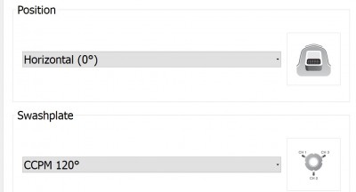

I still dont understand problem. They call swashplates differently. Even each radio have different wording.
But in both Brain or Spirit there is no mistake.
Spirit was developed years before Brain exist. And our aim is to not copy anything else.
Posts: 643
Hello franz88 !
There is no difference between Spirit or other FBL's !
For the orientation of the FBL the upper picture shows an arrow which represent the flight direction and that is what matters - both the installation situation of the FBL is based on the direction of flight and the corresponding orientation of the swashplate is decisive, otherwise there is nothing to consider or anything to be attached to a name - or in other words, what is it like orient the swashplate in the direction of flight and then choose the right one - of course you should know whether the TS is 120° or 135°, you could measure that out if necessary, if this is not explicitly explained in the manual, that's not rocket science -

Ok no problem.
I try other settings

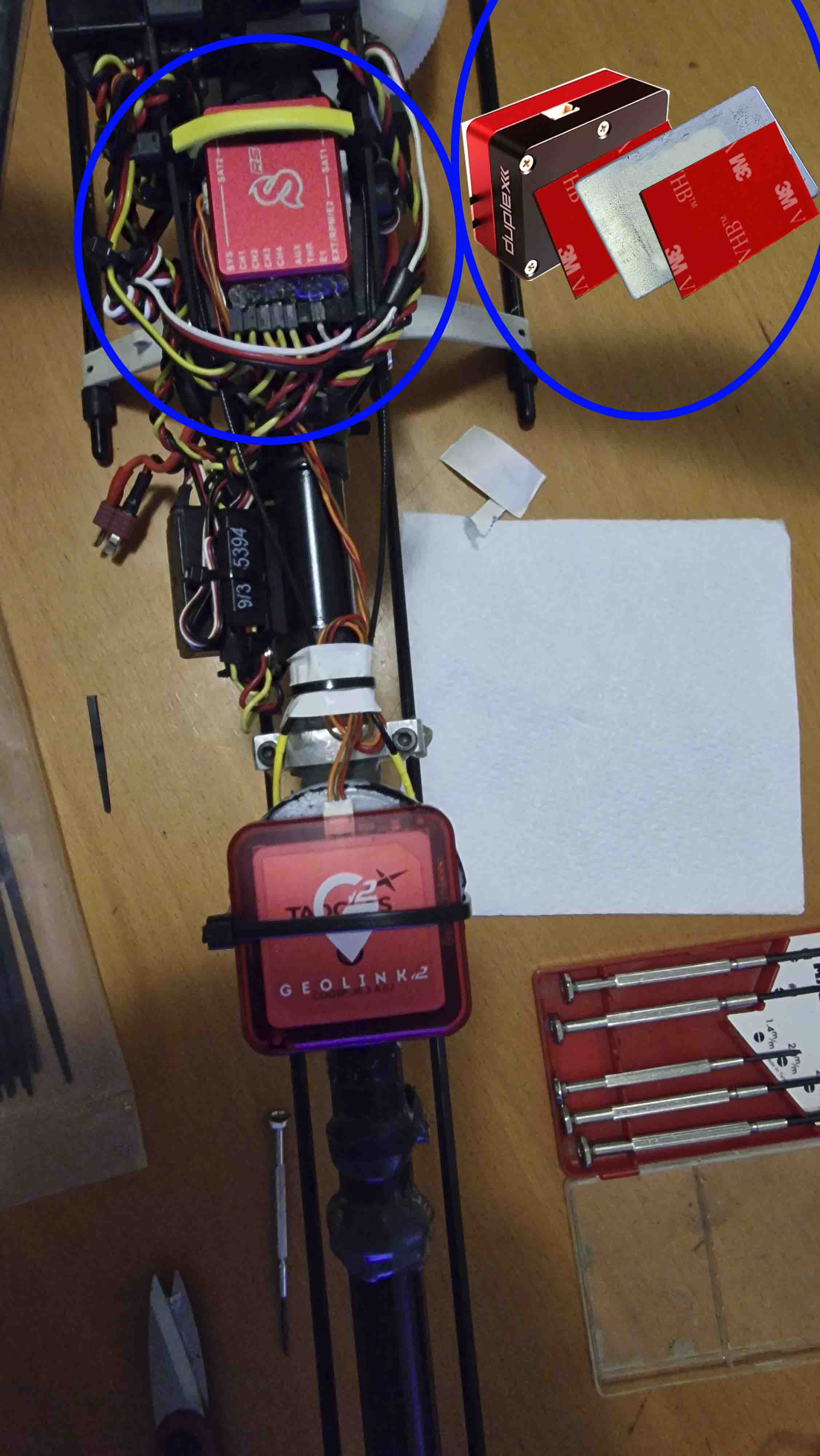

to decrease vibrations I put a layer of bioadhesive a rigid plate and a layer of bioadhesive.
How to use in helicopters nitro.

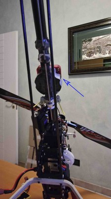

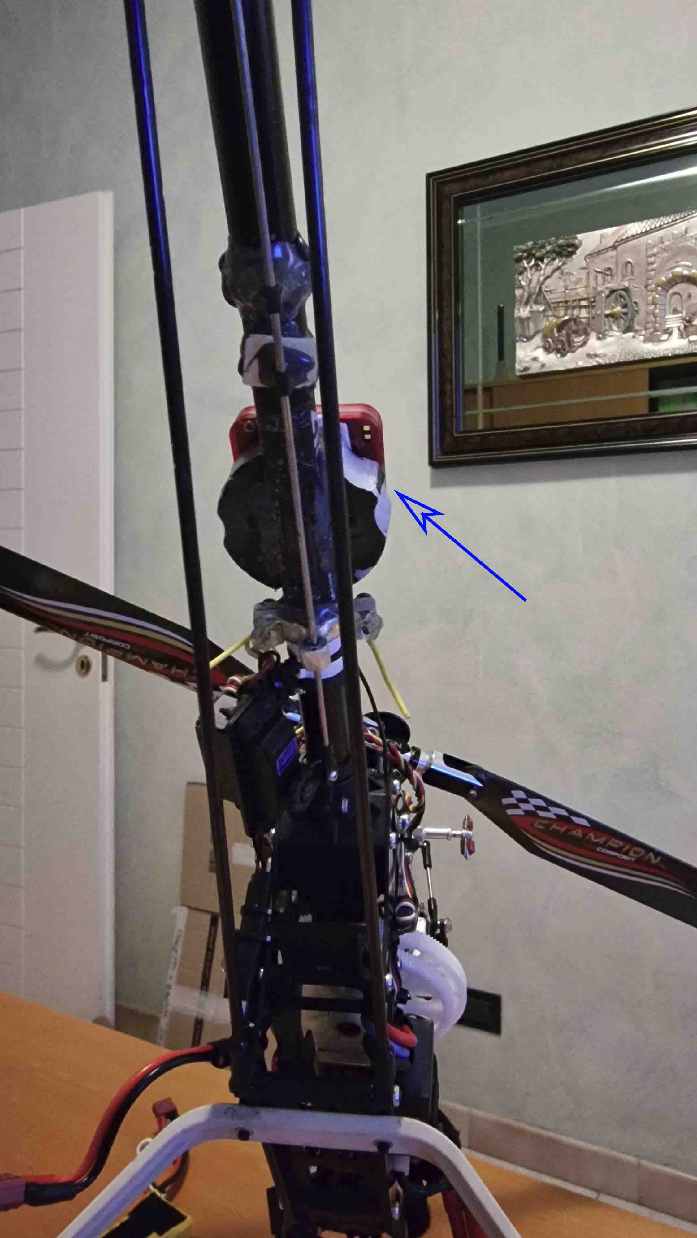

I added an electrical clamp with heat shrink tubing to not transmit the vibrations (if it's okay, I'll leave it , otherwise I cut it with scissors)
Also for the geolink I modified the support, i consumed to let free the laser. (before I used only barometer why the laser was blocked from an obstacle)
I'm also redoing the settings.
Geometry link I hadn't.
I entered 6 degrees of cyclic but now I understand correctly.
i set 6 degrees in geometry and in ciclyc i set 8 or 10 degrees (of pitch i use 12 degrees)
Posts: 13045
You are not lowering vibration level because of Spirit, but because of helicopter. It is not safe to fly with this level at all because all parts are under big stress.
Adding more layer of double sided tape could result in bad performance because it is already too soft. So please use what is recommended in manual. Only one layer of our tape. This is recommended for any model with any engine.
Other tapes can be too soft which is not good. Each FBL unit is working well with certain tape because it has different weight. If adding more then sensors will measure how it is wobbling at the model.
For Spirit it is better to be mounted hard than soft.
Electrical clamp for GeoLink is OK, but not for Spirit unit.
Posts: 643
Hello Franz,
one question, do you push down the FBL with a cable tie ?
If yes put this away, that helps not the FBL ! I know some finished models from horizon hobby were delivered in this way, but this is way back in time - don't do that today !
