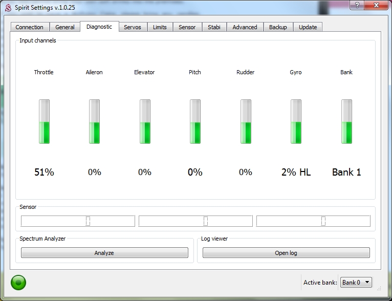

I have installed test22 and run about 6 power cycle tests with no issues.
I also tried (twice) powering on the heli with the TX off, but everything seemed ok.
I have included a screenshot of the settings when the heli was powered on with the TX off.
I note that the throttle was 51%
I know it might be over kill, but would it be a good idea to have a failsafe value for throttle.
Assuming 0 may be a bad idea since futaba can have -ve throttle..
Cheers,
Yak.
Posts: 13038
Great, you are right.
This is not good.
Fortunately Throttle is not initialized until TX signal is coming.
Thank you very much for your help!

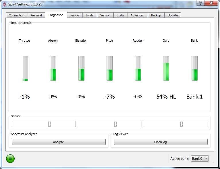

Thanks for that.
I have installed it, and retested the log files with the TX off.
Everything is looking good as well as the "start-values" when the heli is turned on, while the TX is off.
As you can see from my screenshot, the throttle is -1%.
While this might be good for me, I think the number of Futaba SBUS users might be higher than the number of Taranis SBUS users. When I switched from Futaba to Taranis I had to reverse the throttle endpoints.
Some futaba users might be using 100% as no throttle, or is this a non issue?
Cheers,
Yak.
