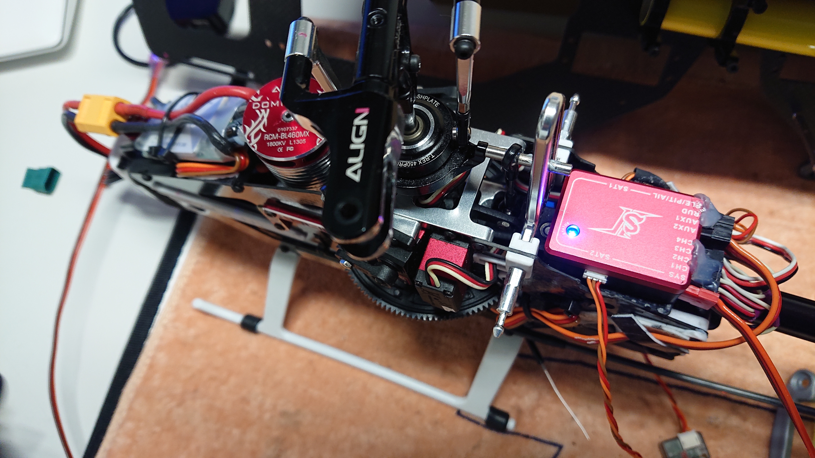

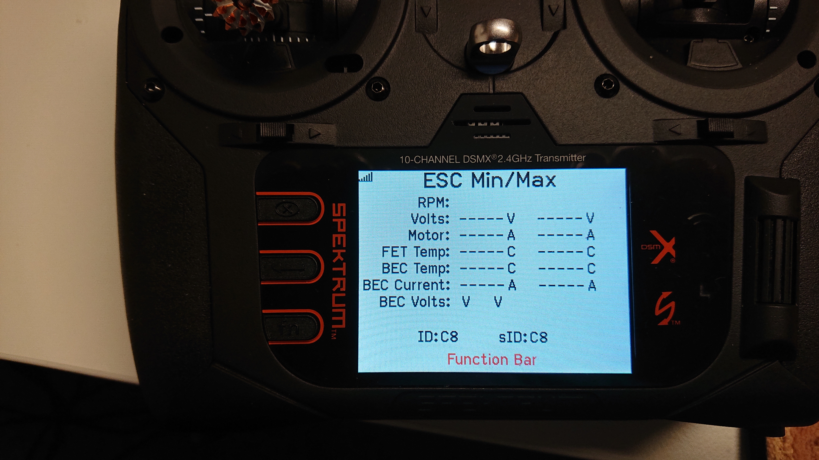

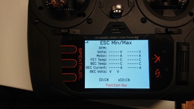

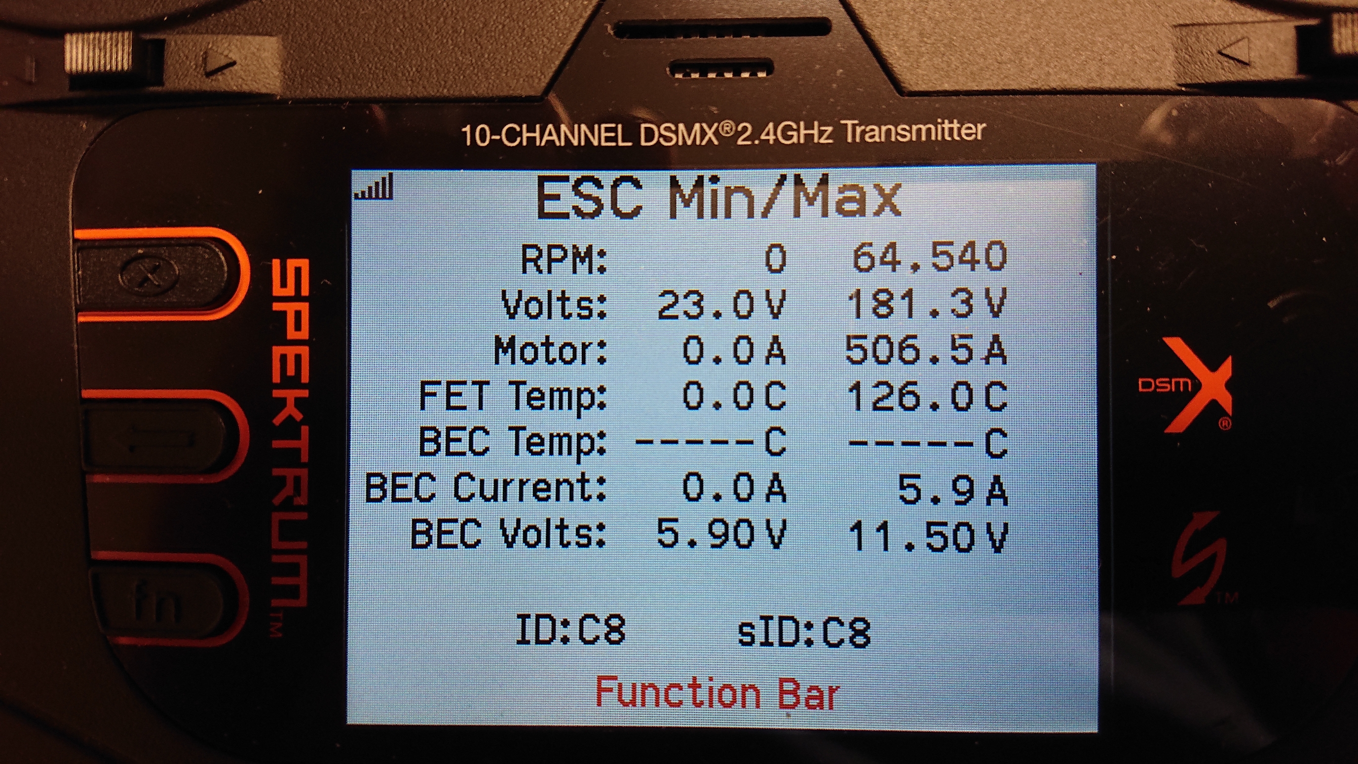

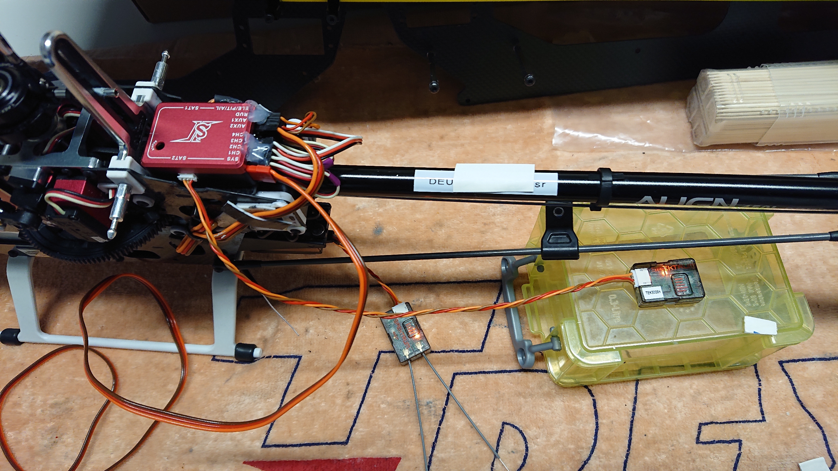

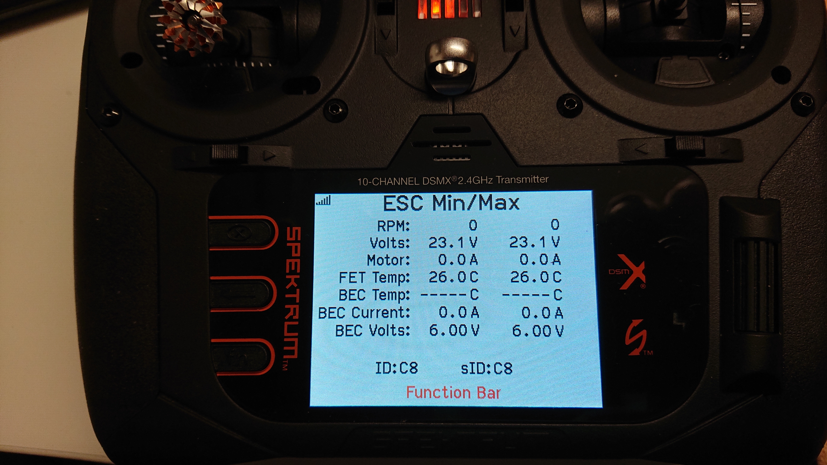

Hello everyone !
I have tested my configuration ESC YGE, Spirit II with firmware 3.3.4 from 11.01.22 -
I have to say bad news ! It doesn't work stable - Framelosses were resettet for example 4 to 0 - Rpm's were showed 30000U/min but motor is not running ! Amperes and volts are shown very high values 3xx V, 500 A but motor isn't running -
This mainly happens when I plug in or unplug the 4651T connected via the Ail pin, but unfortunately also not so comprehensible with the 9747 - if either the 4651T alone or the 9747 alone is plugged in, the whole thing is stable, with the 9747 plugged in via sat2 - I have attached a few pictures and the FlightLog, which then also contained a receiver signal lost, although I had plugged in at least one satellite -
