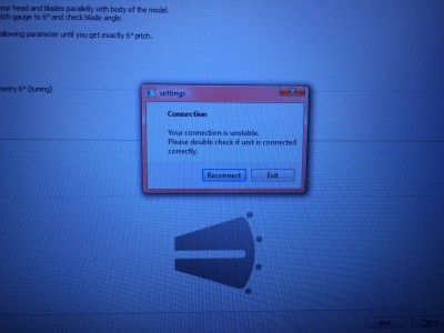

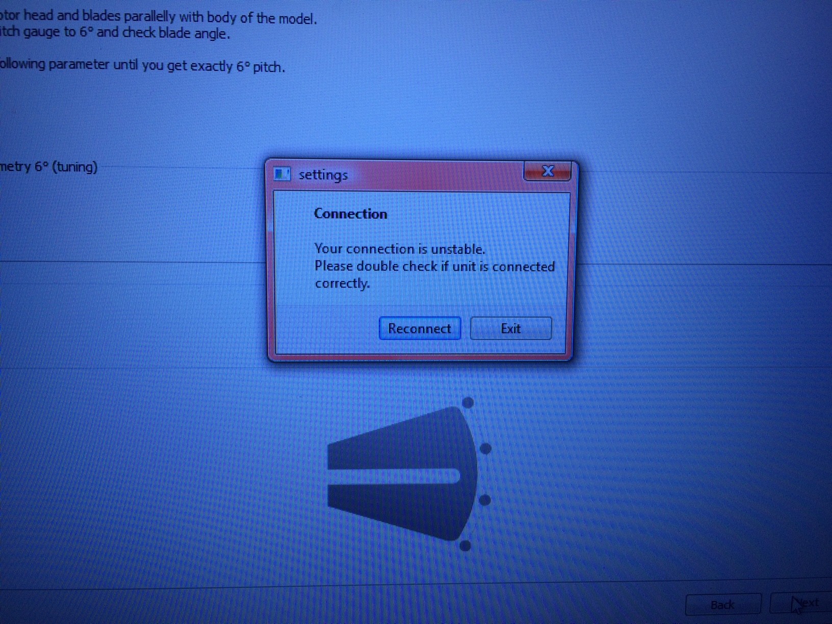

Hi all I am getting an error popping up when trying to program my Spirit Pro!
This is what pops up: Once this happens the swash jumps around and my Spirit blinks on and off....It happens when I go into any area to adjust swash, pitch, servo centering etc...

it look like you are powering the unit with some power that is not too good. It can't probably handle your servos.
Maybe just wiring is not OK.
If you can tell us more details (what ESC, BEC, servos, firmware, software are you using), I will be able to tell you more.

After a program was sent to me to fix the issue of losing the serial number in the unit, I only had time to bind the sat, and do a partial setup. I saved that it all seemed to be working correctly. Then I got around to trying to do the setup again last night, and that's when it started acting up again giving the error massage.
It does it when I move to the next step in the wizard. The odd thing is it seems to save the initial setup I did last week (servo type, reciever type) but loses my setup of swash leveling servo arms pitch and that sort.
I've even moved back with the back tab to the previous setting redid my settings, it sets up, but as soon as I move to the next step, unit flashes, servo's jump around and settings are lost again. The heli is an Align 500 Pro DFC, stock motor servo's stock DS515 cyclic, tail Ds525, Castle ice 75A ESC.

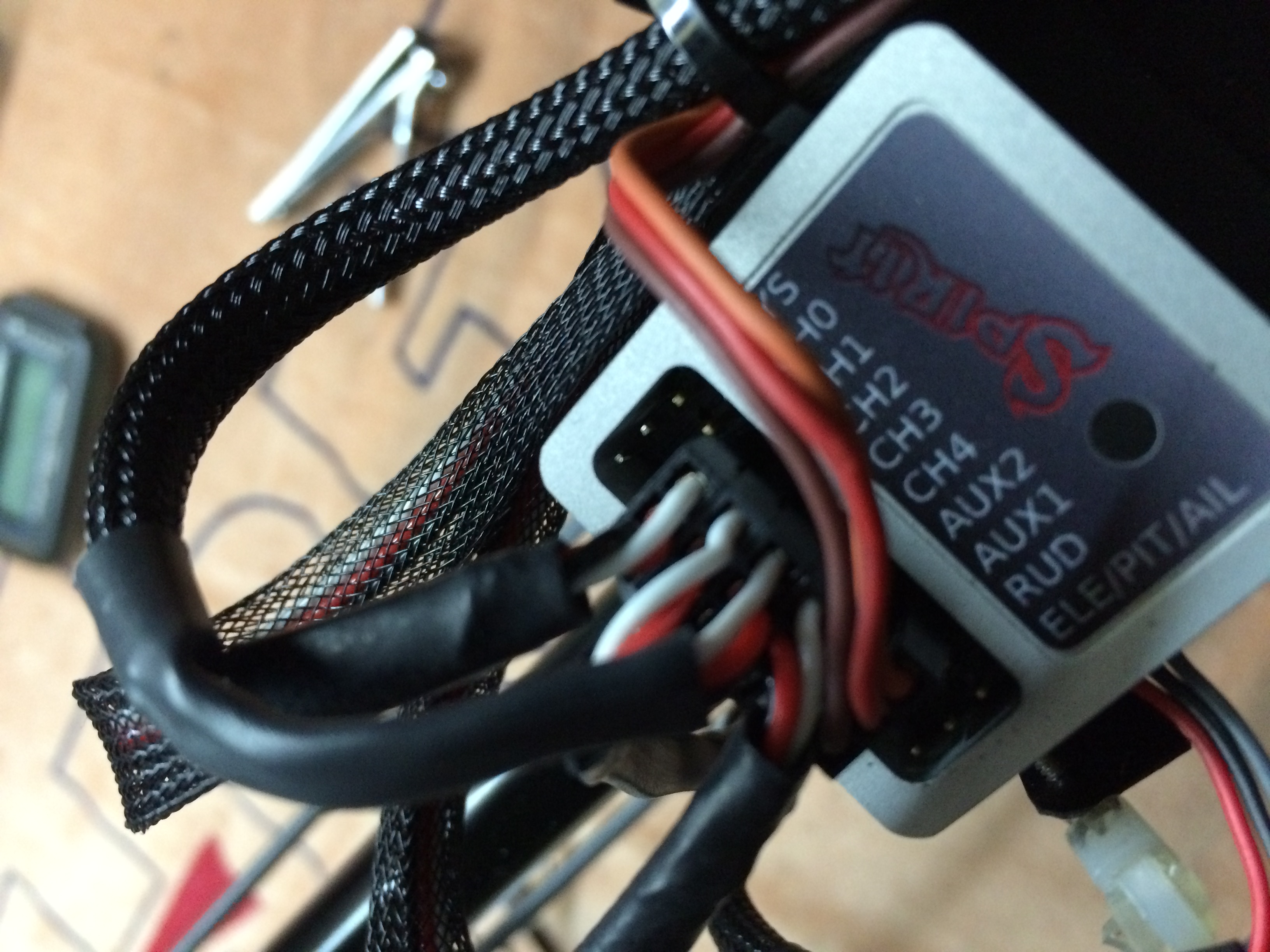

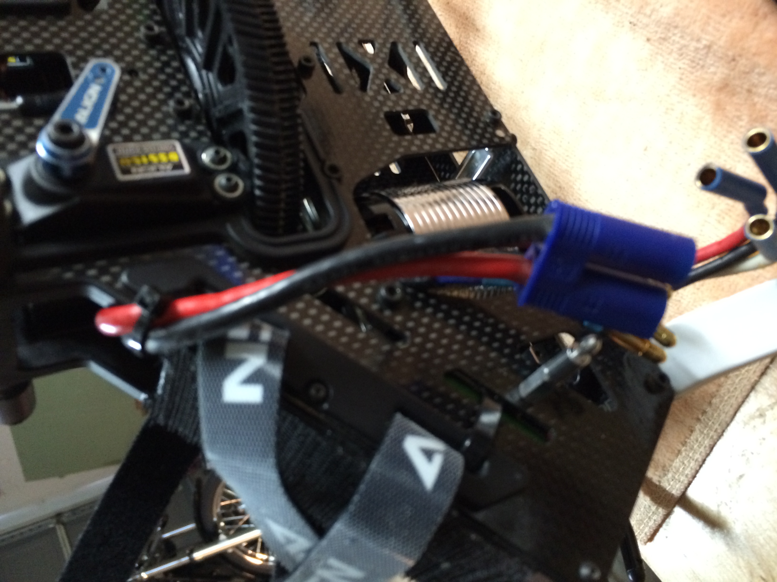

By picture of wiring, do you mean how unit is wired? Or do you mean whole wiring throughout the heli?
What type servo's do you reccomend? Here is wiring as I have aleron ch1 ele ch2 pitch ch3. Also the connector from Castle ESC is pictured.

update, ok did a BEC test and it said BEC failed....could my esc be bad???
Posts: 12988
Oh,
your wiring photos are looking well.
But if a BEC test failed, then it is not good at all.
What you can do is to disconnect one servo and perform a BEC test again.
If this will not help, disconnect next one and try it again.
So at a certain point you should get success.
We will know how it is bad. Theoretically adding capacitor may solve the problem, but it will be still on the edge.
I believe that your BEC is OK, but it is not capable of delivering required power in a demanding situations. So very fast servo movement can cause total loss of control or unexpected behavior as you can see.
