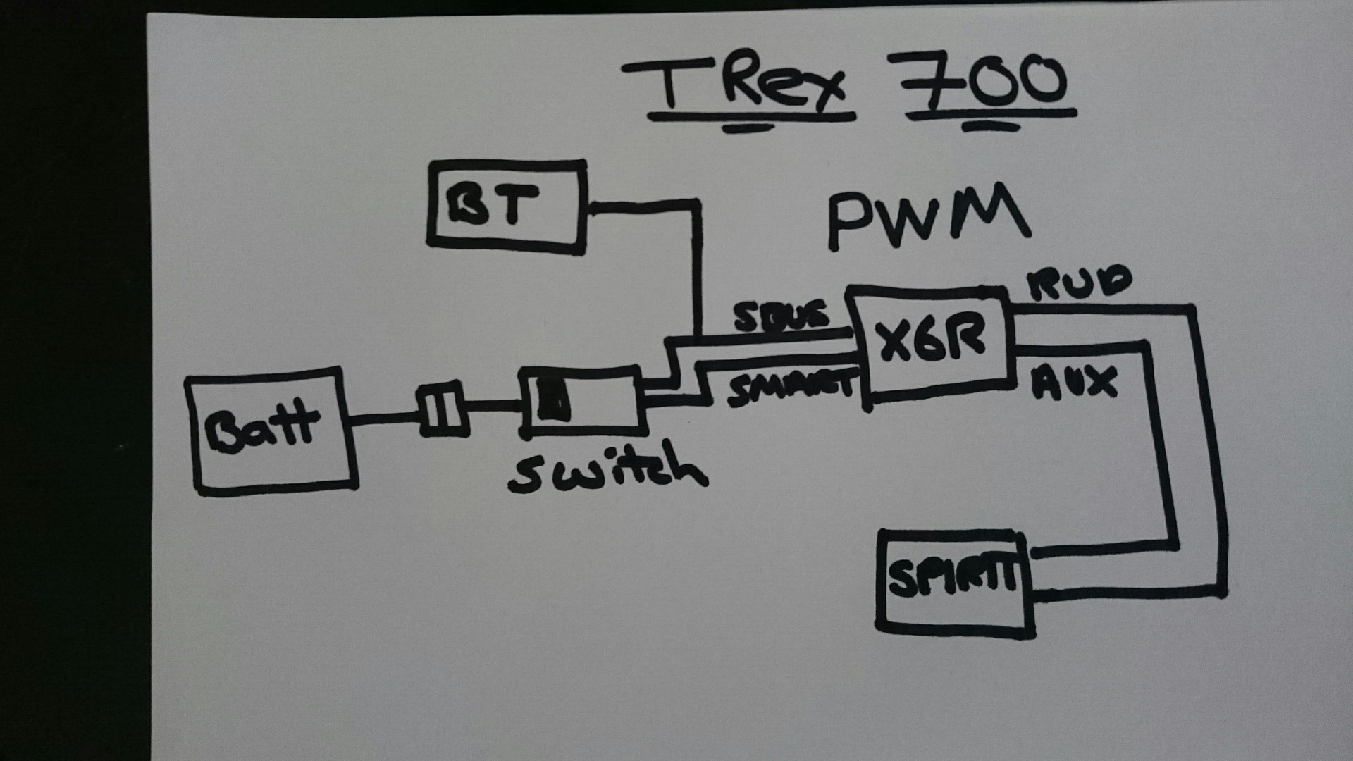

T-Rex 700

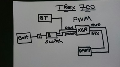

Just to simplify things please could we just concentrate on the T-Rex 700 for now, so just to clarify :-
The X6R is configured as a PWM receiver and is fed from the powerbox switch (two o/p leads) into both the Smart port and the SBUS port.
The powerbox switch is fed from a single 2000mAh 6.6V Life pack.
Please refer to the wiring diagram as the helicopter has been used in this configuration for probably two years now along with a BT adapter with no problems.
Unfortunately i don't have an SBUS invertor cable to try.

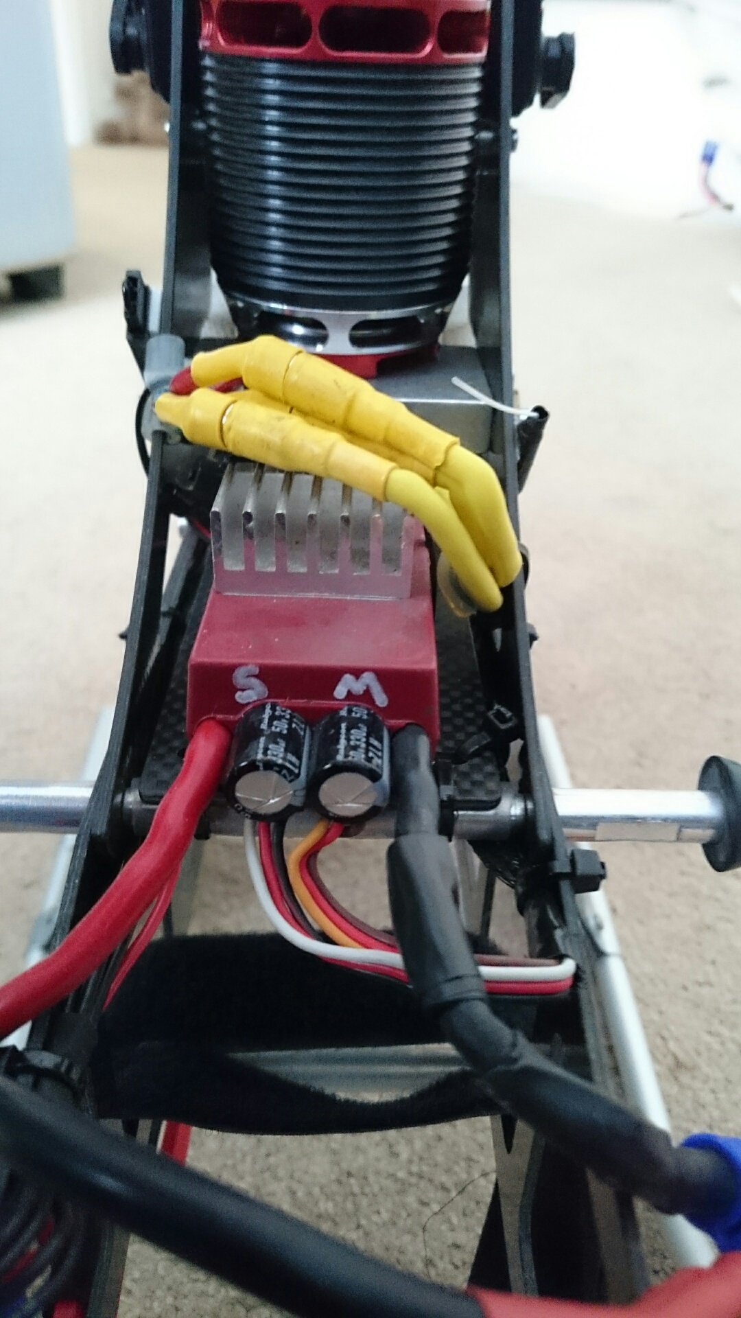

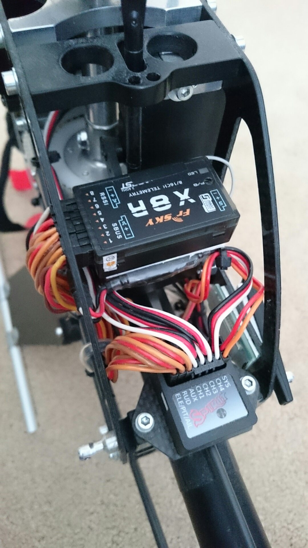

Pictures for the Henseleit TDR.
Master throttle/power supply from the Heli Jive ESC is fed to channel 1 on the X8R.
Slave power supply from the Heli Jive ESC is fed to channel 8 on the X8R.
Power then supplied to the Spirit via the RUD and AUX cables.
Posts: 13045
Thank you!
Now it is much more clear.

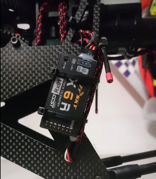

At the photo DSC_0253.JPG I can see PWM connection, but in receiver, S.Port I can see just two wires.
So the integration can't work in this way - there you have to connect cable for the OpenTX integration where all 3 wires are connected.

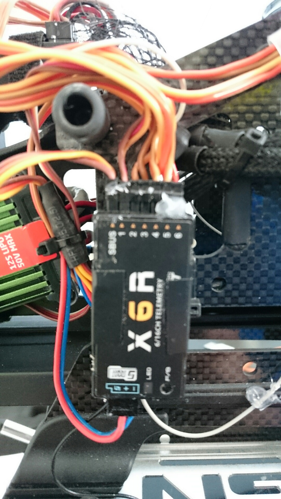

Just to make you aware that photo DSC_0253.JPG was taken without the integration cable fitted and this is how i have been using the helicopter in normal operation.
When testing with the integration cable fitted i was only powering the receiver from a single power supply via the SBUS port.... the blue/red power cable fitted to the SMART port was left dangling in mid air.
Just to confirm that other then using the SMART port of the X6R as a power supply input you are happy with the way i have wired things on the TRex 700 ?.
