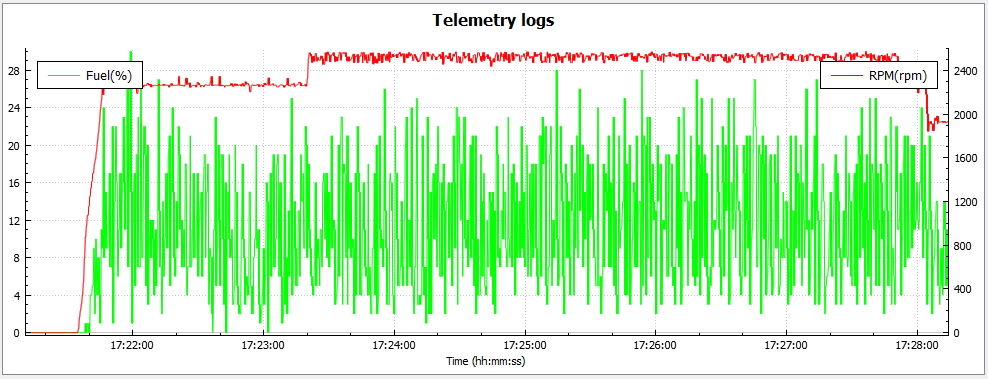

I attached my settings, and also a screenshot of the RPM and vibration log from a long test hover I did a couple of days ago:
Vibration Log
Vibration Log
I'm a bit puzzled by the fact that tilting the helicopter before takeoff can throw it off. Does it really try to capture the horizon at bootup and then integrate throughout the whole flight? In addition to the fact that it accumulate integration error during the flight, that is also a problem for helicopters like the 550X that are leaning forward quite a bit due to the weird landing gear (tilts forward by 5° to give better tail clearance). The microbeast did not have that restriction AFAIK, and seemed to always be able to figure out what was down on the fly by using the accelerometers and current rotation rates.
