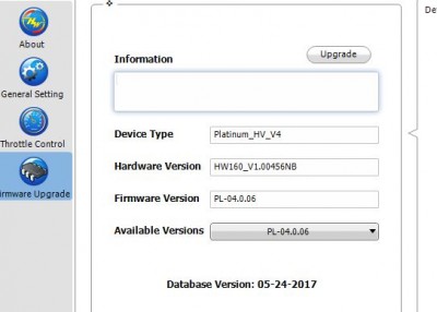

Can I ask you to verify firmware version of the ESC? I know you have mentioned it is the latest.
It should be at PL-04.0.06.
Also to be absolutely sure that you have 2.4.1 version that we have, can you verify the checksum of the firmware file, please?

HW is 04.0.06 and MD5 is also ok.
