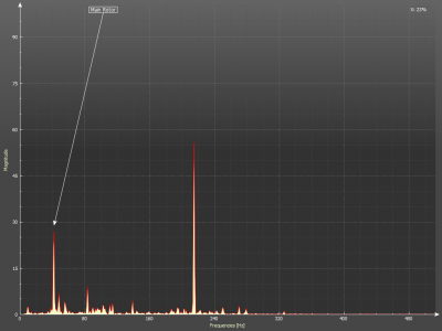

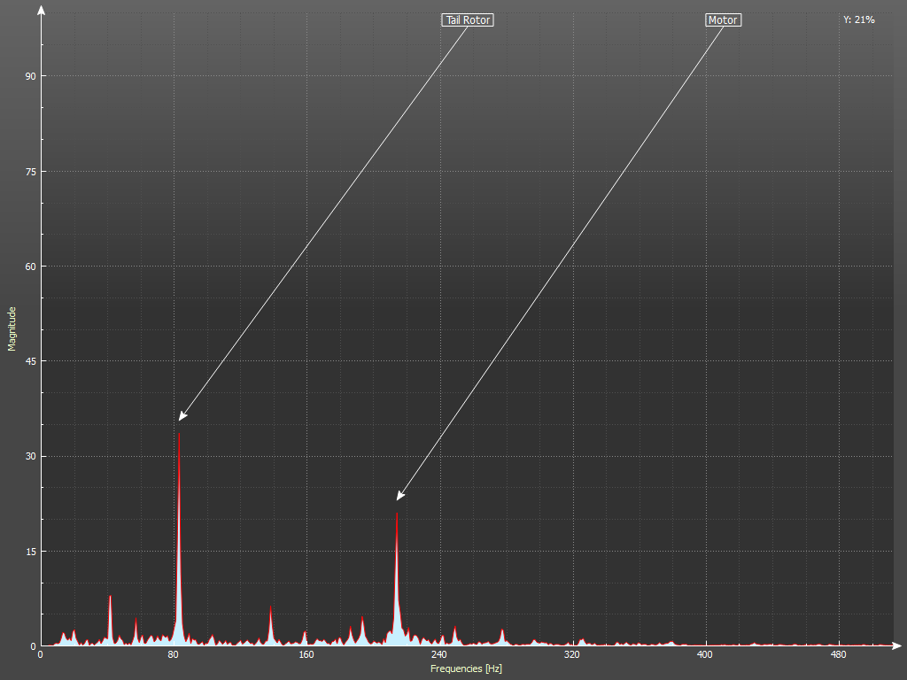

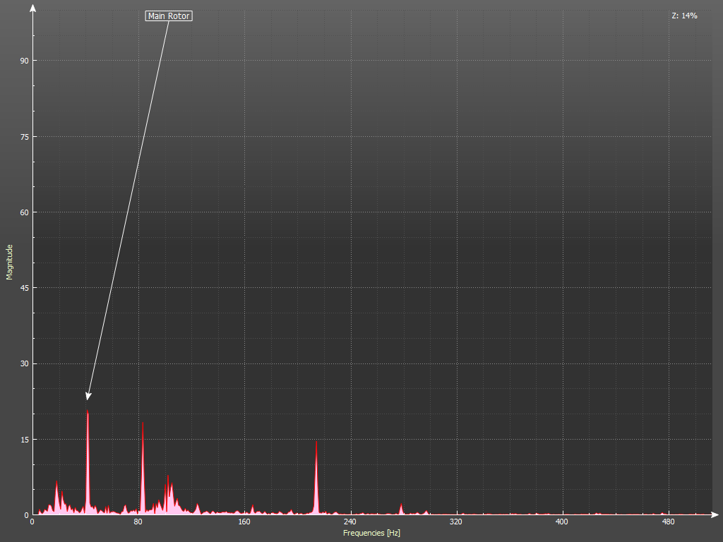

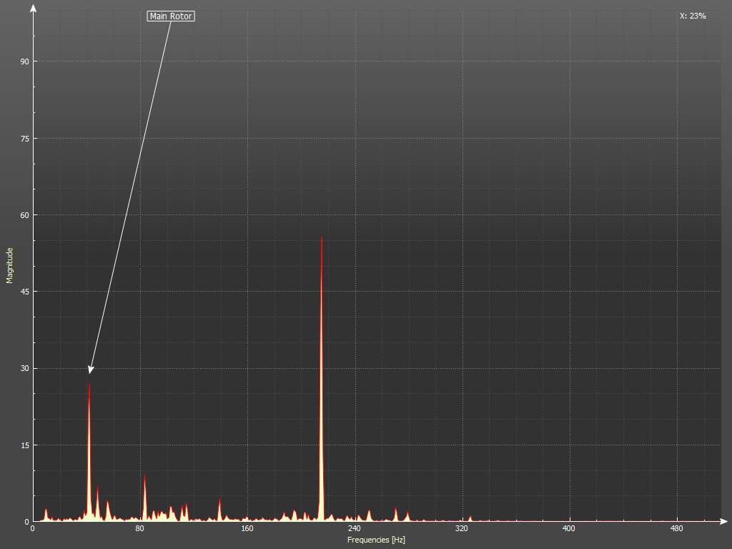

Brand new Fireball with Tail Wag can't get rid of it.
Tail gain down to 30% can I go any lower ? Any high I get fast wag in Idle Up 3
Setup files attached. Will do vibration logs later today.
Any suggestions ?

at lower head speed. I don't see any vibration issues, logs attached.
Have any other suggestions ?
