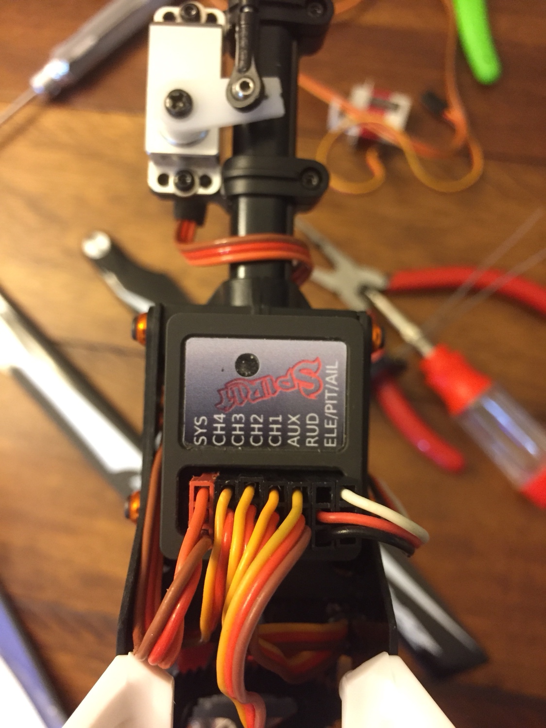

kawitech
Posts: 7
Joined: Mon 19. Oct 2015 3:27:59
ZeXx86 wrote:Hello,
we are testing each cable before shipping so I believe they are OK.
Unfortunately some old Spirit units could be incompatible with CC telemetry for which we are doing free modification. The only requirement is to ship the unit to us. Then in one day we will change internal part to allow the telemetry.
Do you have some newer unit for testing? Is the unit really Spirit Black Edition or it was bought as Spirit but it actually is dark gray/black?
After spending 2 hours trying to get CC telemetry work I find this thread. I think my Spirit will have to be sent in. Please post a note on the CC telemetry wiki page to keep others from possibly wasting time in the future! From your description I assume mine is the gray model?? I’m attaching a pic. Thanks for everything you do, your products are amazing.
