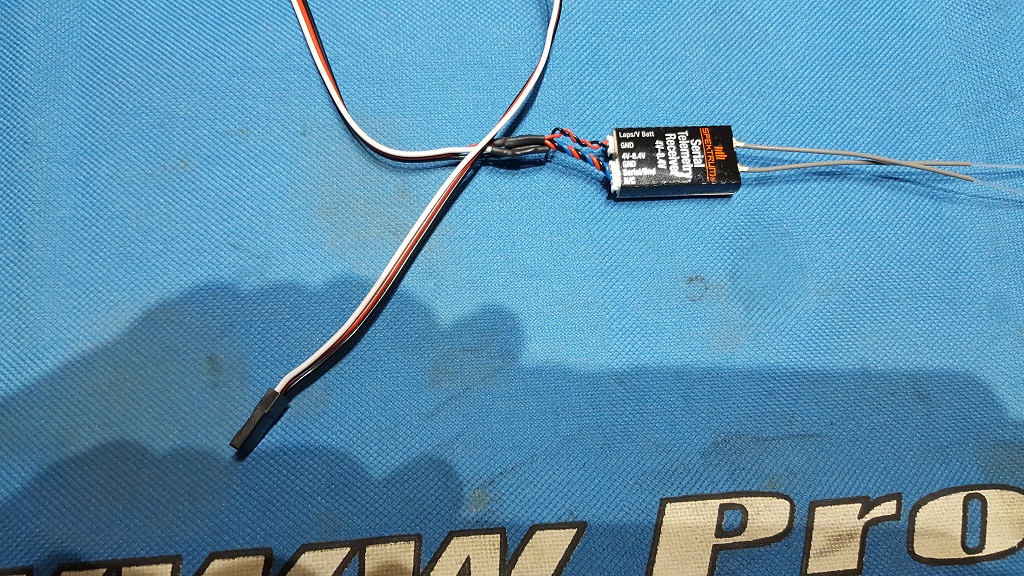

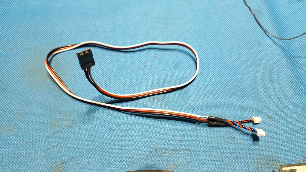

I solder the voltage sensor leads that come with the 4649t to the + and - of the power / signal cable of the 4649t to get my BEC voltage to report. I usually do this when extending my RX wire to fit the model.

Pictures attached of how I build my leads.
