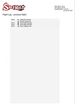

talon 25 amp and new a ubec from 3a, new servos (Savox) , and a Radio Spektrum dx8 gen2.ho also the grounding system,tail with motor support, i have check continuity and all work perfect... but I already lost the radio signal with the satellites 3 times and I changed 3 different satellites, two were fake, I was convinced that they were the ones, the last one took new and original, specifically a spm4648 autobind, and even with this last, I found the radio by the receiver, and from the log of the control unit, I find the voice receiver lost signal, just before flying just connect the battery at heli, so I exclude categorically the ESD ON THE BELT.I also changed the receiver's cables, got some new and better, moved the bec, the regulator,(far from satellite) I took every precaution possible, and I always find myself after a while that the satellites, lose the signal and not they are more good in general. I read all the forum, on similar problems, and I followed the letter all the advice when similar situations happen. I'm whipped, I do not know if I change radio and system, the radio is new is a dx8 gen 2, never fall or other, and on other models with the satellites have never had problems, similar, I talk about drones.What can I do to solve? if I wanted to use a receiver spektrum, not the satellites this time, which one would you recommend? how many channel?
I also attached a scrEenshot of the log, and the strange thing is that I lose the signal of the receiver immediately, then low power, but everything works well, and the lipo is charged, then I disconnect the battery, connect again and the log is clean without advice(ALL GREEN) e WITH THE SAME BATTERY .all cables are new and in order and I have no false contact.

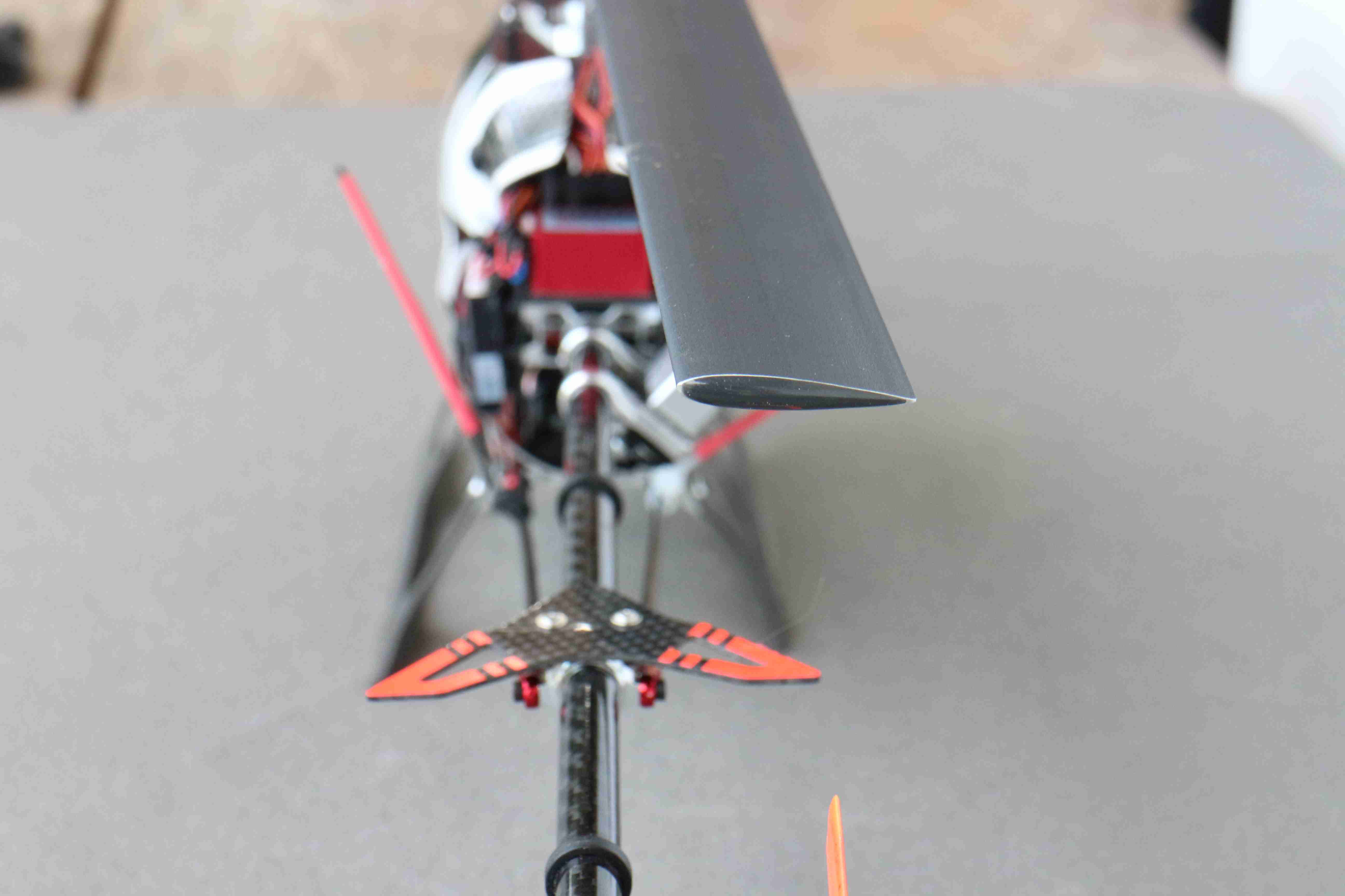

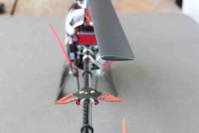

Regarding antenna position:
I placed the 4649T at the end of the left side plate with antennas pointing down. Looking at the back of the heli I placed on the left strut (connects frame and tail boom) a tie wrap pointing at 11:00 o'clock and on the right strut one that points at 1:00. Both tie wraps create a "V". With a piece of red shrink tube I attached to a tie wrap one antenna. So the antennas are protected, secure and point always in the right direction (90° to the signal direction). Sorry for the blurry pic but it should show the blade.
Why do you use an extra ubec?
The Talon 25 delivers also 3A through his internal BEC and 8A short time.
Did you disconnet the red power line from the ESC connecton??
Otherwise you have two power supplys (ESC 5.5V and UBEC 5.0 or 6V) fighting each other and this will cause an instable voltage supply for the receiver and the Spirit

i you are getting warnings directly in your radio then the problem is very likely unfortunately in their powering.
With 250 size heli you can't fly too far so you really can't get in a troubles with just one satellite in a normal situation.
Moreover if you are using spm4649t or similar which has standalone regulator inside it is completely separated from unit and even if FBL unit will die for any reason, you should get still full signal.
So the only case when you can loose the signal is when there is not enough power.
Unfortunately Castle BECs, especially these internal from ESC are not the best, they require very often at least some additional capacitor to cover brown outs.
Moreover usage of Savox 0257 will add you even more troubles, since they are not designed for flybarless usage. They are equipped with DC brushed motors that can draw a lot of current and if overheated it can easily shutdown the BEC or burn if BEC is strong enough.
If you will set higher servo frequency then it is even easier if you are doing a lot of stick movements.
So Castle ESC + these Savox servos are unfortunately not good combination at all. The servos will also not offer you good precision, so by usage of a different such as MKS DS92A+, DS93 or even some cheap Turnigy 306MG you can dramatically improve flight performance and solve current draw issues.
To verify that this is really the case you can perform BEC Tester. No satellite should flash or indicate a signal loss (either in log or in your radio).
I would not switch to a different radio, your setup must work well. Instead usage of ESC with a better BEC can be the best solution. For example HobbyWing V4 Platinum 40A.
