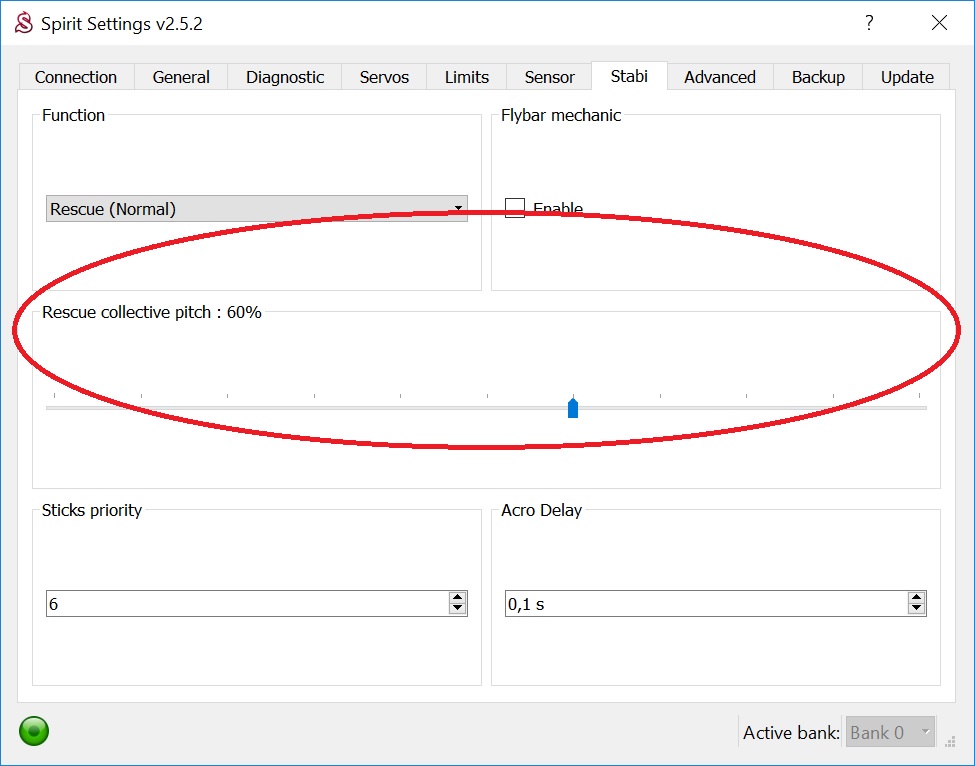

here you can adjust the performance (speed) of rescue. Make sure that collective pitch is within the designed range for the heli (e.g. +13/-13 degrees).

Will try at next flying, but I thought it just sets the pitch, so how much the heli ascents during rescue?

I reduced RPM and the collective pitch of the rescue to 40%, otherwise heli was going out of the camera too fast. This actually made one rescue not shake, but all others do shake. I just made 200th flight with this heli today and this problem is from very beginning, very consistent.
