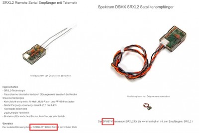

I have an question about the possibility to have additional srxl2-satelllites at the satellite ports of the FBL, like described in the new firmware 3.20, look at the screenshot - Can I buy an adapter cable in the shop ? Please can you describe how that should be possible.

Have I something misunderstood ? Can I attach the normal DSMX-Satellites at the Sat-ports or can I really attach an additional SRXL2-satellite at the sat ports but how ?
I see in the Shop no adeqate cable to attach for example from sat port 1 or 2 to an SRXL2-satellite -

you can connect SRXL2 satellites at the SAT ports. We will make available the cable, hopefully on monday.
So for example you can connect up to 3x SPM4651T satellites.

sorry I know that you are very busy but I want to ask when the new SRXL2-cable (for more than one satellite) will be available in the shop ?
By the way is it then possible to mix different satellites as SPM4651T and SPM9747 (both are Spektrum)
