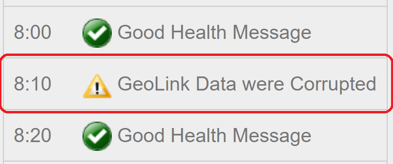

After connecting to my Spirit 2 + Geolink through wifi link and windows 10 PC soft found that Geolink's setting window tabs are getting shaded for a few seconds, become unaccessible and dropping me down to the INFO tab (picture). Afer a few seconds its getting back and work normal (picture). Sometimes log is showing a message "Geolink data were corrupted" (picture). Period between normal and unaccessible state is about 3-5 seconds and constantly switching.

I get that same error in logs and I’m using the usb interface I thought it was just a recorded error until geo link got sat signal ?ZeXx86 wrote:Hello,

No, as far as i found it start giving errors and disconnecting when geolink got sat signal after blue led is on. During searching, before sat position is fixed when blue led is off it works good for me.
