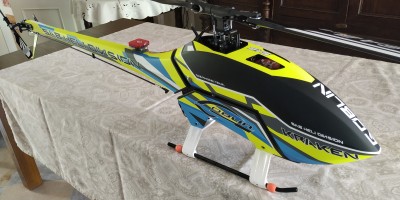

At this stage I was prepared to install the new firmware 3.3.2 on the Big Kraken because normally I don't like to use it as "Test Rabbit" , and I was speakless today when I switch on for the first time the Position Hold,
it was like nailed on the Air !!!!!!!!!!
Than I test the Function Automatic Rescue, and it's done Flawsles perfect!
Attached picture Kraken, the cable from the GeoLink is provisional installed , it will go unther the
boom.
