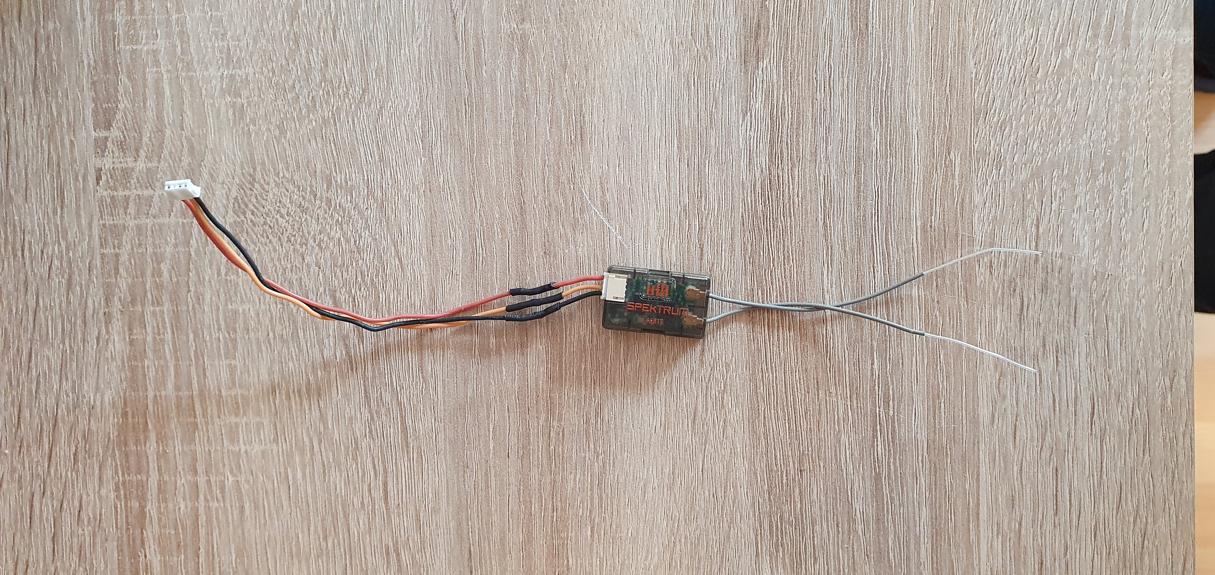

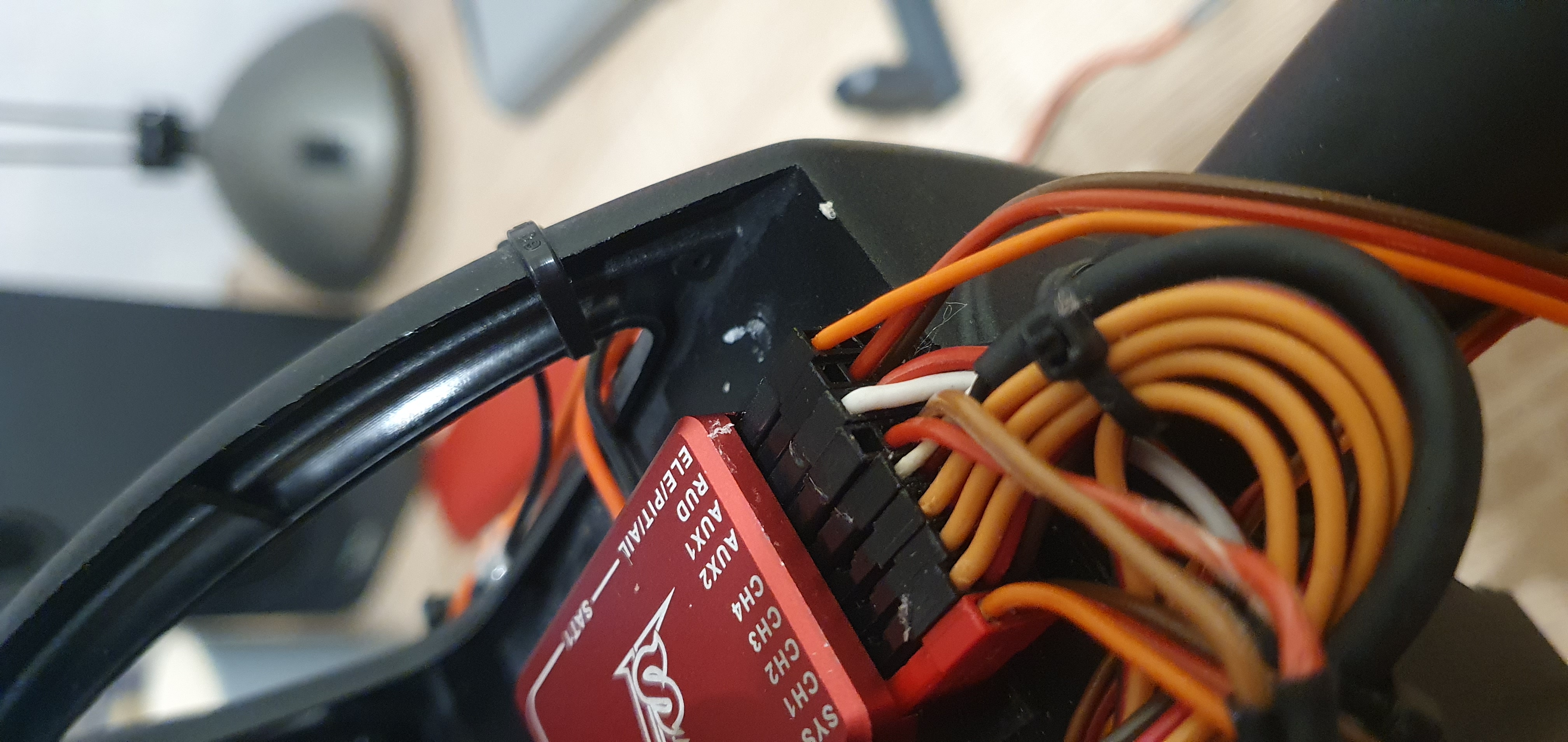

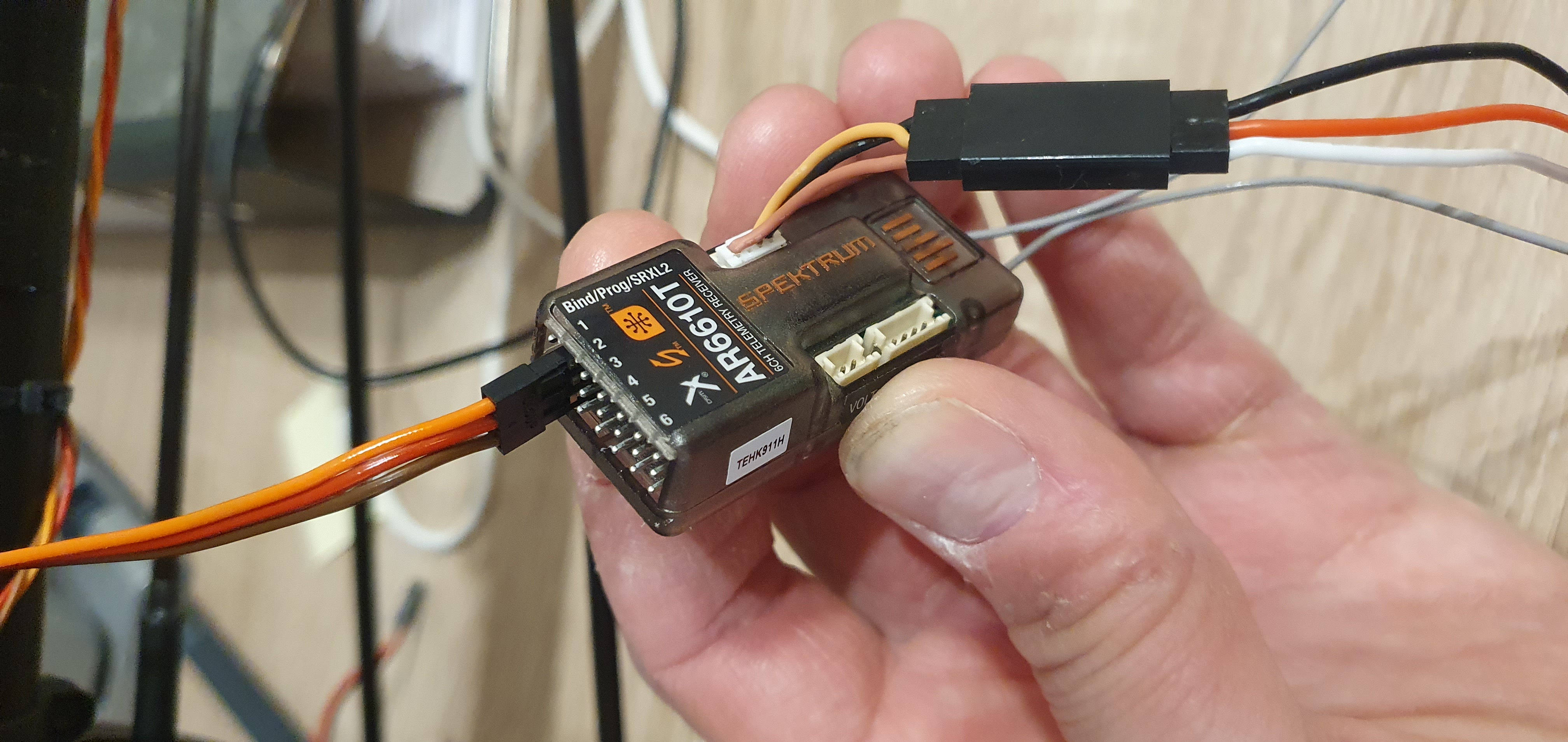

I'm trying to get the AR6610T + 4651T to work. But it doesn't work. Both receivers have the latest firmware. I have connected the AR6610T to channel 1 according to various forums and the 4651T to the SRXL2 connector on the AR6610T. The heli does not initialize. It only works when I connect the AR6610T alone. Then via the Bind/DAt/SRXL2 port. What do I have to do to initialize the heli when the FBL is connected to channel 1 of the AR6610T? Many thanks for your help

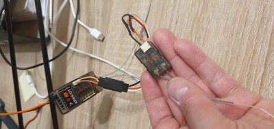

I pressed the button on the AR6610T. then both receivers flashed and I was able to bind successfully. nevertheless the heli does not initialize. I'll test again if it makes a difference when I press the button on the 4651T.

I have tested the same configuration as you and it works for me - what firmware have you installed on spitit II ? Install the newest 3.33 one - Can you try it with the original cable for satellite receiver ? My binding procedure is as follows push both binding buttons at the same time an then push in the supply voltage, you don't need spirit at this moment because binding is only a part of spektrum radio and receiver - in this way it woks for me -
Some thing I have forgotten to say, have you the latest firmware in your radio too ? Also you have to look at the newest firmware of the satellite receiver by registering on spektrum homepage, then it must work !

I have the latest firmware installed on the transmitter and both receivers. All products are registered with Spektrum. I soldered the original cable. The receivers both go into bind mode and it binds successfully. But the heli doesn't respond. I noticed that the 4651T flashes earlier than the AR6610T. If that means anything? AR6610T only works on the BIND/DAT/SRXL2 port when I connect it alone. Binding works without problems on port 1, but the FBL does not recognize any control inputs.

Hello, I have set SRXL2 in the Spirit. In SRXL2 mode it initializes correctly. I don't get as far as adjusting the gas in the connection to channel 1. Nothing moves in the diagnostics menu. just by connecting to Bind / dat /srxl 2

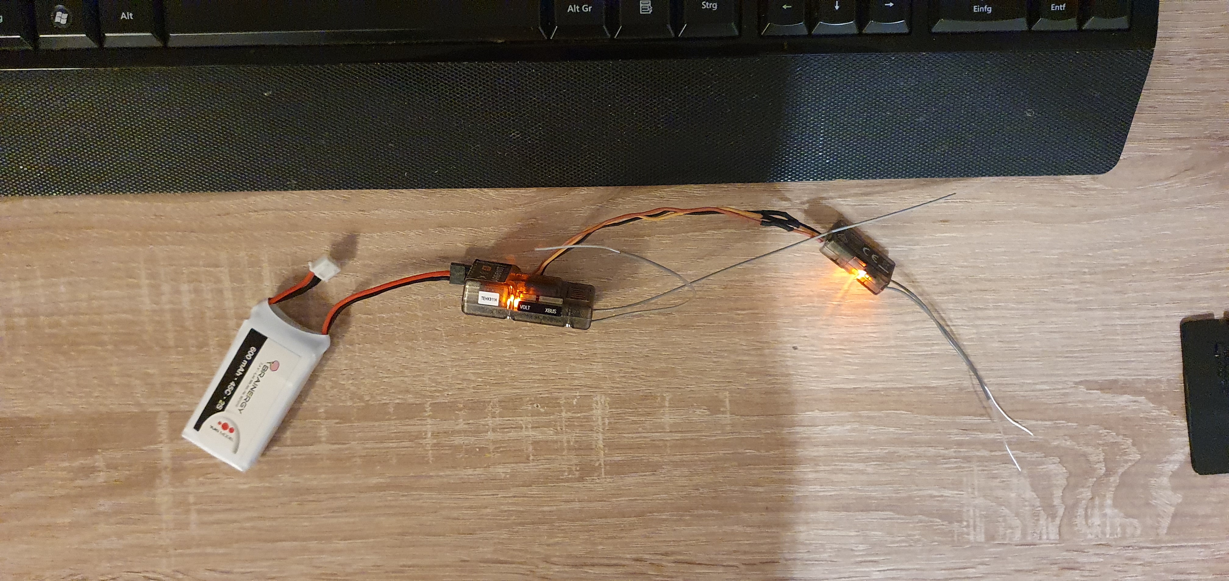

Hi, but the binding also works with the Spirit without any problems. in my video both receivers are bound. They shine permanently. I can still try to bind the receiver with a battery. Binding isn't really a problem. binding works. but the helicopter does not initialize despite the bound receiver. That's my problem. many thanks for the help !
Update :
I have now tied with the battery, but the Spirit does not respond to any inputs. later I show the settings in the Spirit. I don't think that's wrong, since it works with the SRXL2 port alone.
