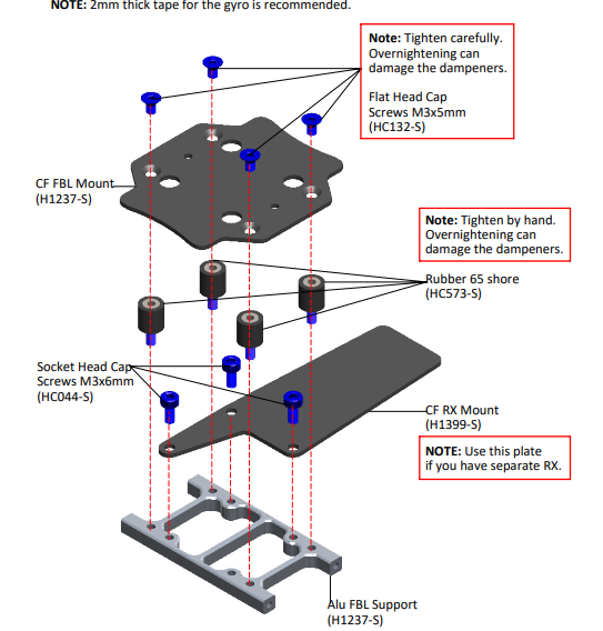

I‘m building a Goblin 700 RAW nitro right now. The kit allows two mounting options, rigid or with a dampened mounting plate.
Witch one is the preferred one in a nitro? Rigid with one or two layers of tape or the dampened one?
Thanks in advance
Posts: 13049
dampeners should be better.
And only one layer of double sided tape is always recommended. Otherwise it can cause more problems than benefits.
