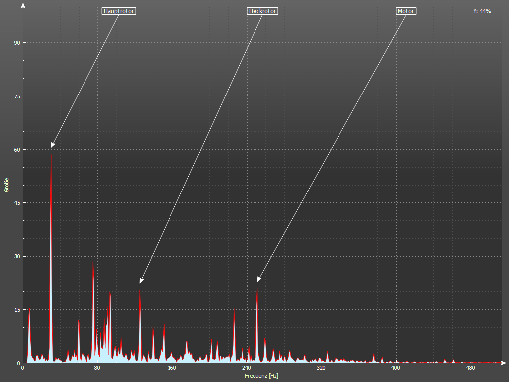

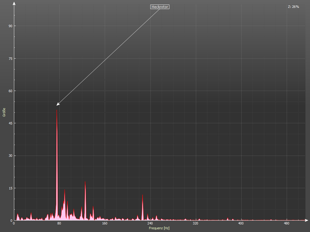

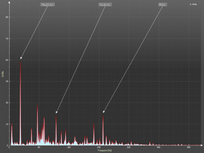

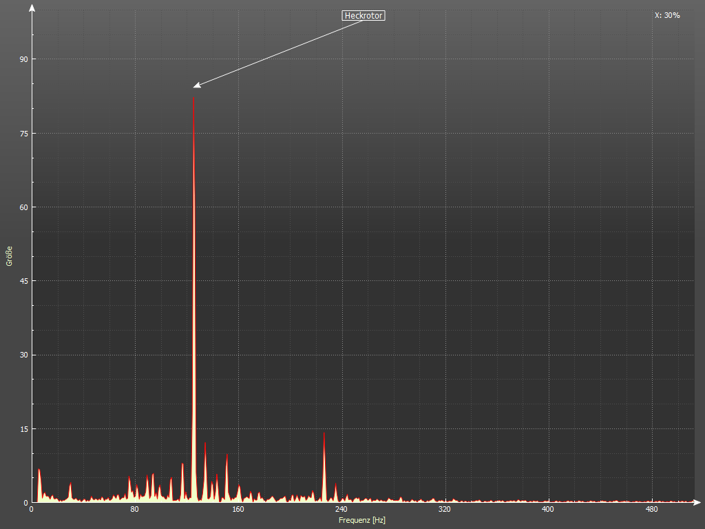

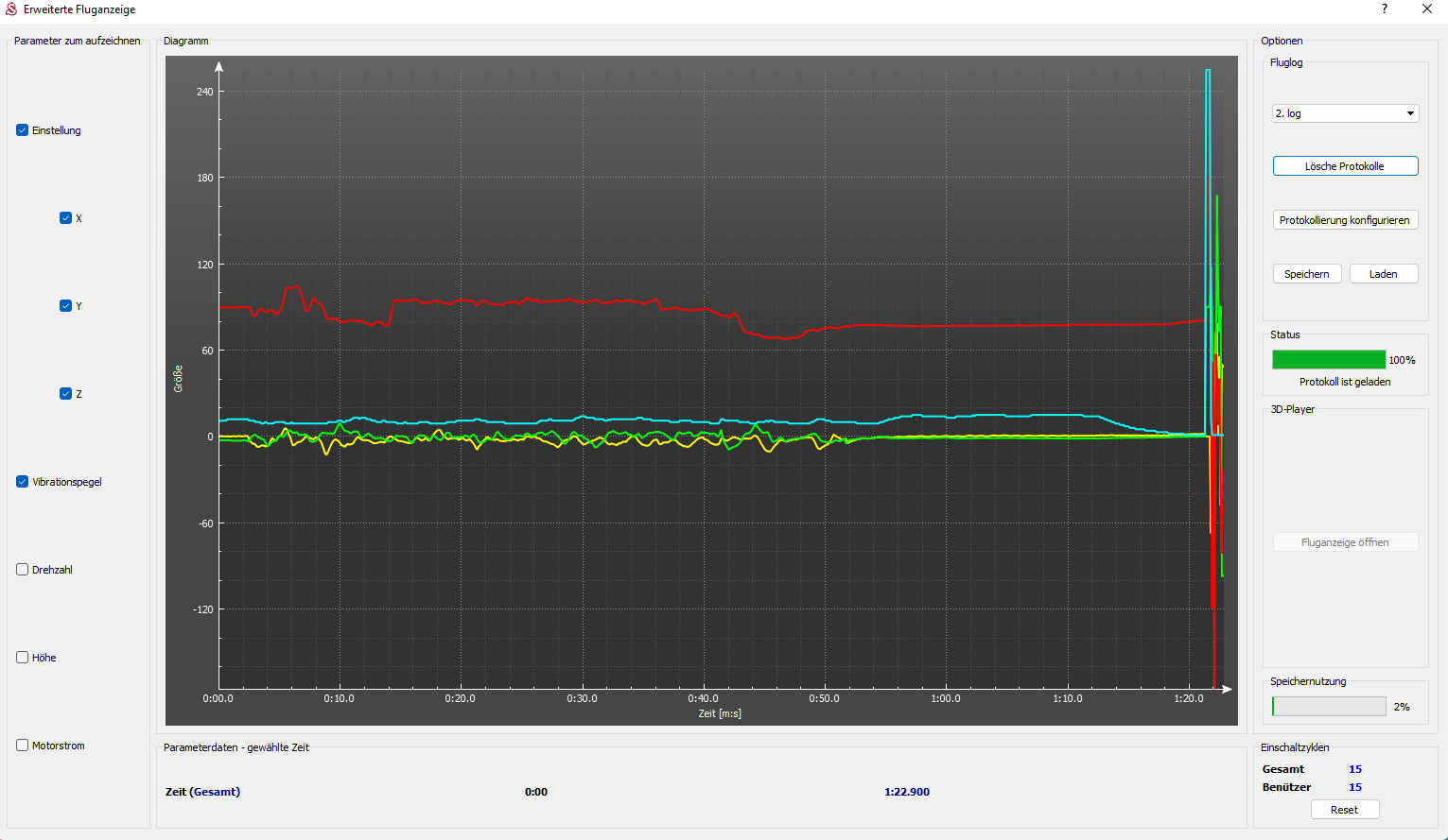

What means the screenshot "Einstellungen X,Y,Z"

the problem with altitude hold is not in vibrations, but possibly in GeoLink mounting or servo configuration.
It is important that when you enable Servos - Subtrim (tuning) all servo arms will be in the center of their travel.
At the same time there must be 0 degrees between main blades.
Can you check this?

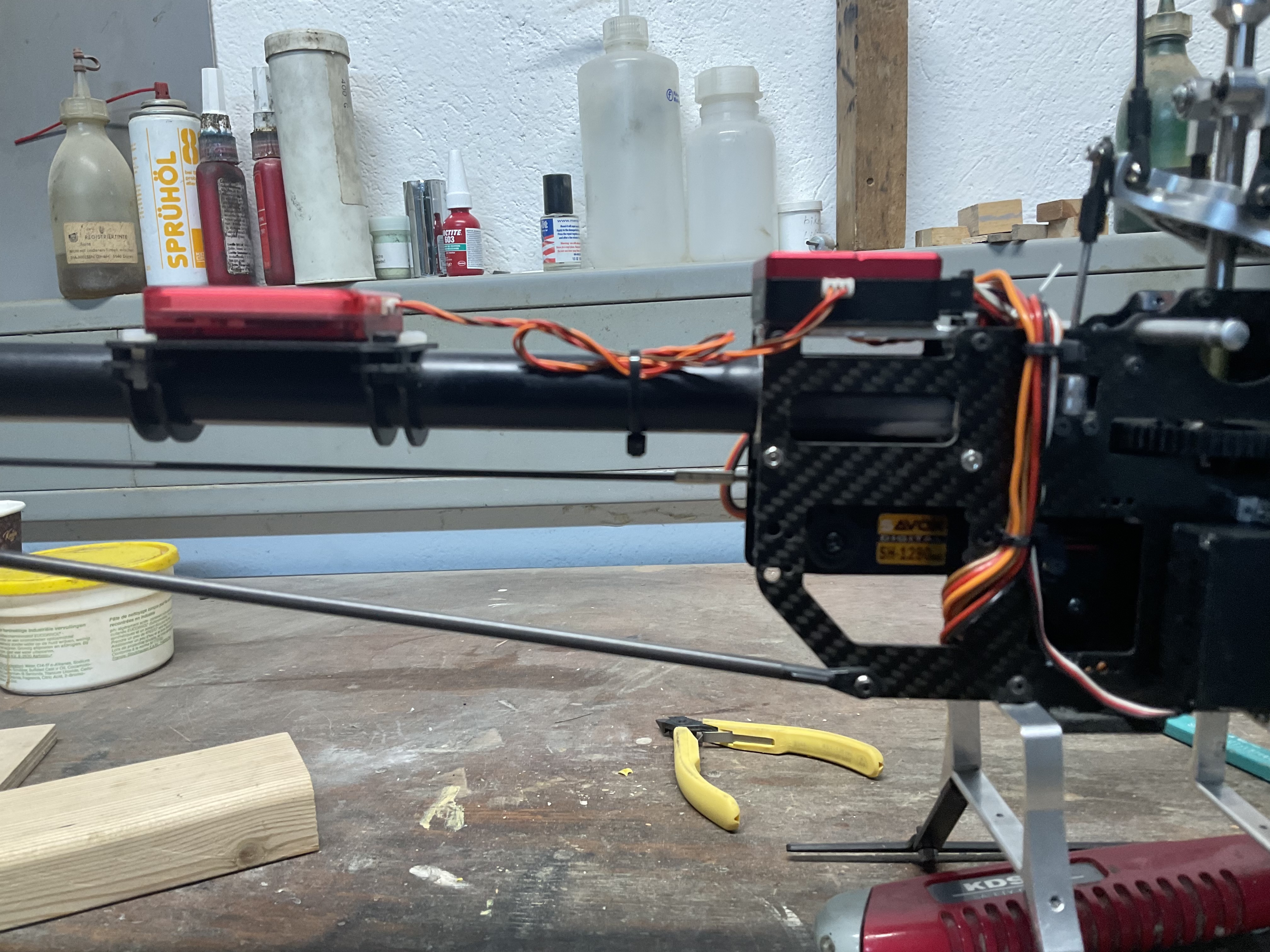

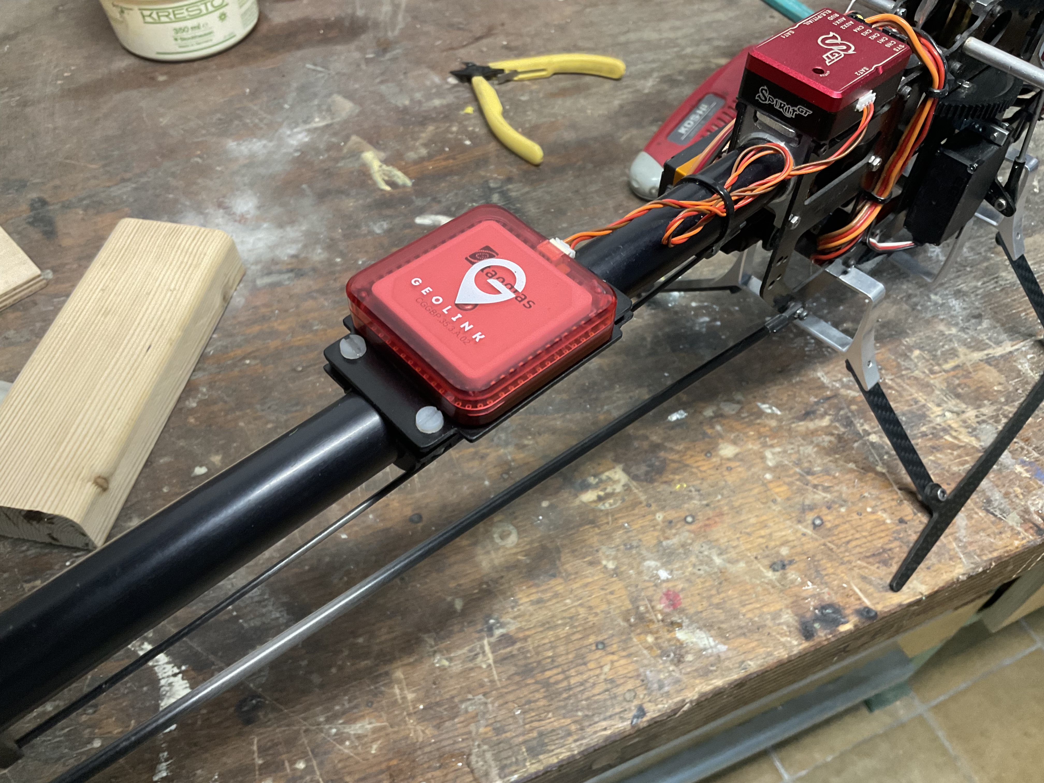

Here is my geolink mounting. Servo konfiguration will be check next time.
