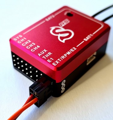

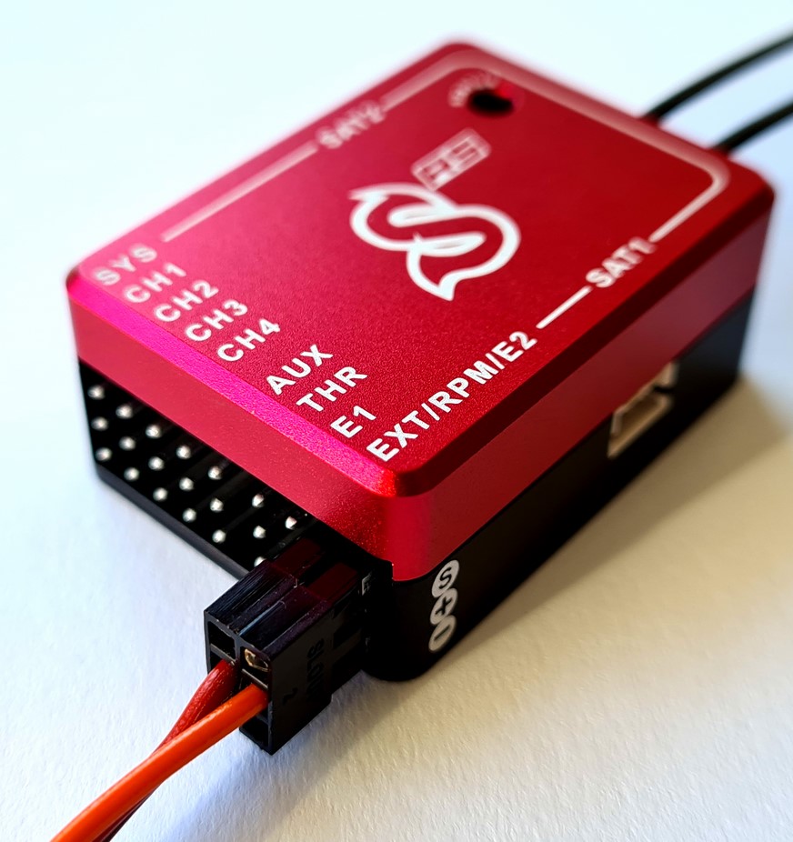

I entered the signal cable of the sensor in the pin rpm (EXT/RPM/E2) and the positive and the negative in the door e1 (my bec i entered it in the door aux).
Now if I enter in general - governor and i and I check if the sensor is active or no, when the engine starts to turn the sensor turns on and off intermittently.

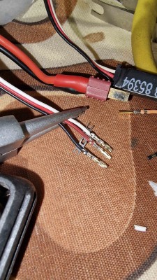

I have another problem.
If i insert plug servo in pin rpm and + and - in port e1 the sensor not read good rpm.
If motor is stop the sensor rpm read that the motor is in rotation.
If I press the cable signal the rpm result 0.
I have changhed plug but the problem is equal.
The sensor hobbywing rpm is new i open this sensor from the envelope.
Now what do i do?
I try to put graphite ?
And I have crimping togliere i try to crimp all 3 cable?
Now i soldering one servo plug.
But for me the pin rpm have good contact.
The rpm in the software are read is normal or no this situation ?

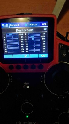

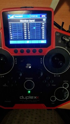

I control from the radio monitor the signal sent to the spirit.
When the stick is at minimum has value -100% as you can see in the picture which I attach called "minimo.jpg" and this value in in the radio it is accurate
with sticks in the center I have value 0 in the channel monitor

I also crimped the servo connectors to be sure that copper of the thread good contact same in this photo
later i checked the continuity with the tester and it's perfect

I also entered a graphite ring against interference the same to that of the esc
Posts: 13045
possibly only different ESC settings could help.
In any case it will not cause any troubles. Some ESCs in some configurations are putting signal to motor even when motor is stopped. For this reason it is measuring RPM. But because signal is too week motor is not running.

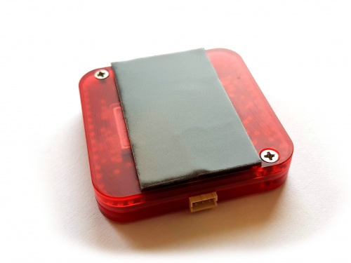

Below the geolink I saw this thing
casually this thing it is for reading the air pressure ? (from the barometer)
When you place you have to put only in the center the double sided tape not to block this sensor?
in this mode: (they are photos taken from the internet just to understand the concept so it's not important if it's the version 1 or 2, my version of the geolink it's number 2 and spirit rs)

Opening in the bottom of the GeoLink is for Laser sensor. Not air pressure sensor. It should have direct visibility to ground. But if it is not possible, it will work well too. Just without laser measurement.
