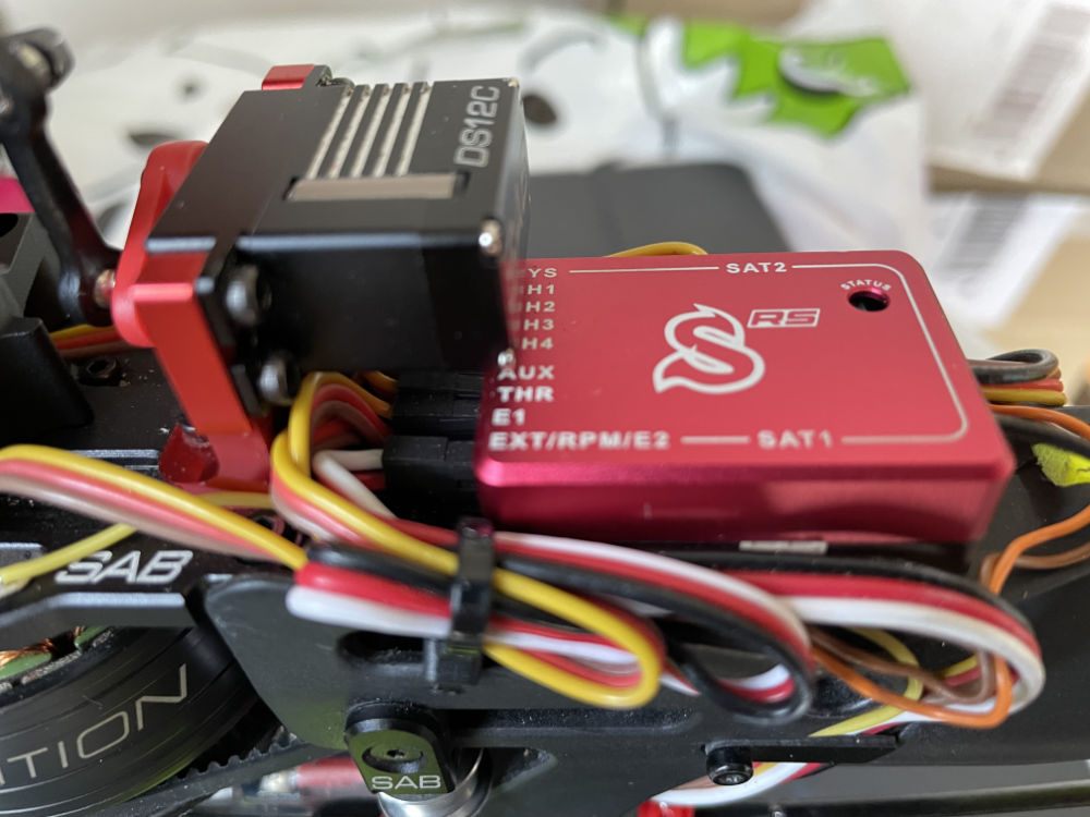

Posts: 13045
Thank you for the details.
I can see that there is something connected to EXT/RPM/E2 - there are white, red and black wires.
Can you tell me what cable it is?
If something is connected in the upper pin just like the white wire, then it will cause random loss of control.
golfecho
Posts: 15
Joined: Thu 26. Jan 2023 22:00:39
it is difficult to take pictures in this tight space. the angle of the picture is not very helpful.
There ist nothing connected to EXT/RPM/E2.
The white, red, black cable is the connection to the ESC. It is connected to the THR port of the spirit.
The connections are as i listed in my answer.
I will try to take a better picture in the evening.
If it helps you i can remove the Spirit from its pad an than tacke the picture.
Kind regards
Gerhard
