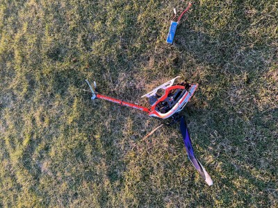

I've just come from the airfield. Unfortunately, today was not such a good day. My RAW 420 with Spirit GTR crashed.
It happened when I changed from bank 0 to bank 1. The heli simply could not be steered any more and crashed. Engine off or bailout, all did nothing, it was still in the air for about 20 seconds and then crashed. I could do nothing.

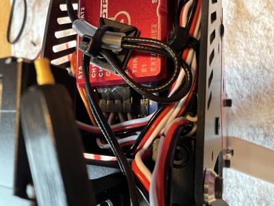

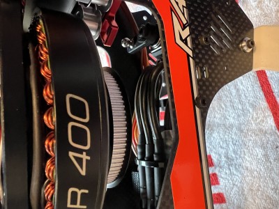

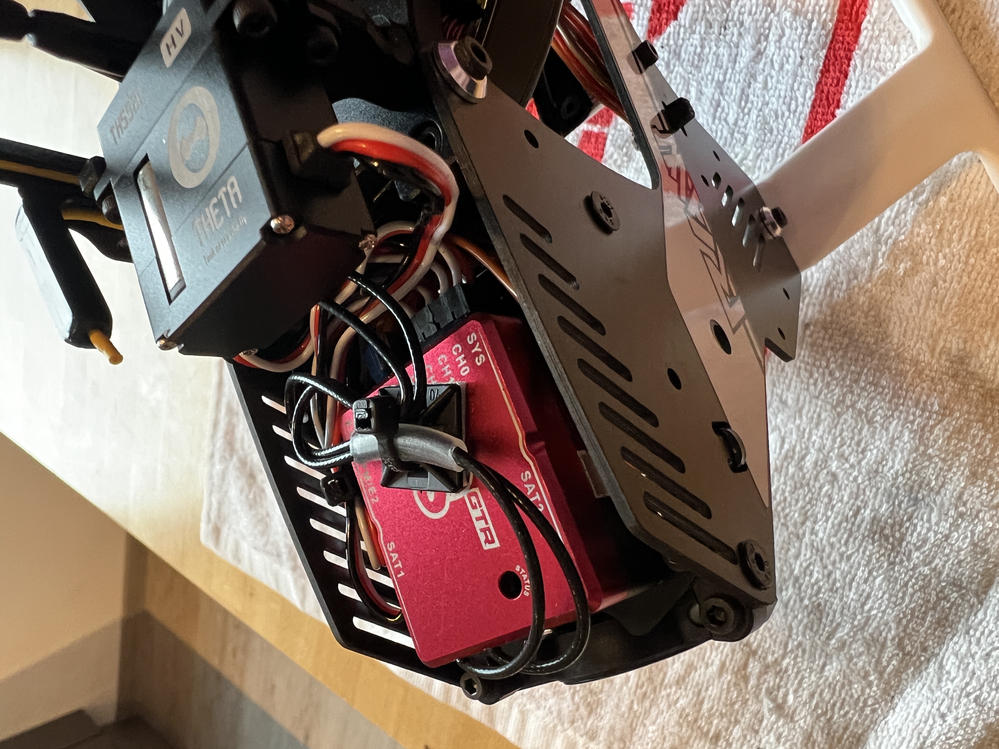

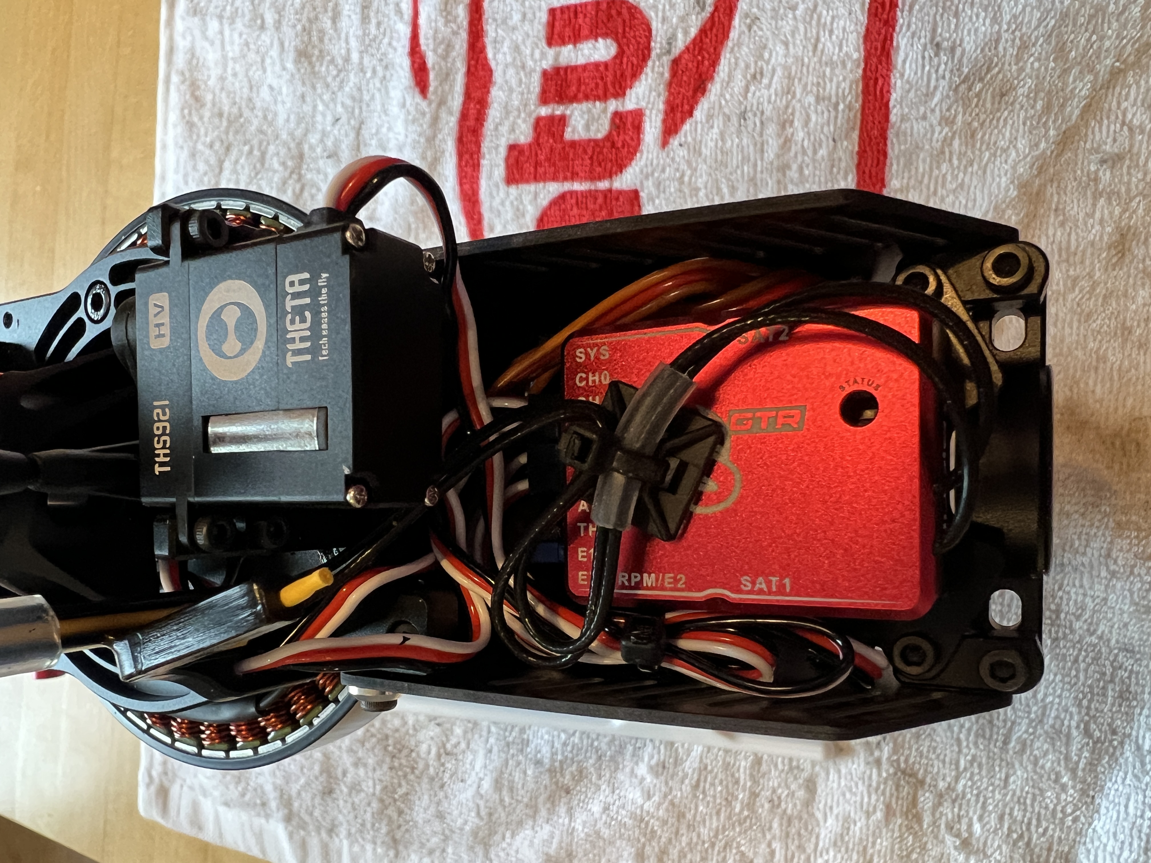

Dan0111
Posts: 27
Joined: Fri 05. Mar 2021 8:57:41
Good morning,
Attached is the setup file for each bank and the pictures.
2.4ds
(255 Bytes) Downloaded 105 times
1.4ds
(255 Bytes) Downloaded 114 times
0.4ds
(255 Bytes) Downloaded 109 times
Dan0111
Posts: 27
Dan0111
Posts: 27
Posts: 13049
thanks for the details.
1. I highly recommend to not bent antennas like this. They are loosing major part of performance and also are damaged if bent in sharp angles like near the unit enclosure. So model can have only around 20% of the transmission range. But this was very likely not reason for the crash.
2. I can see blue connector in the unit. Where this connect goes? Is it E2/RPM/EXT port? Is there some wire going at the top position in this port?
Dan0111
Posts: 27
This may look worse in the photo than it is. The antennas are not bent. They are really only very lightly placed in the bend, without force. But I can change that if you like. If it had been reception problems, the engine would have stopped immediately. I just checked the failsafe again and it works.
The telemetry plug from the YGE 65 is connected to the E1 port. EXT/RPM/E2 is not connected.
