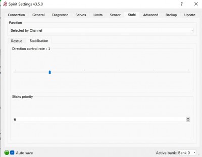

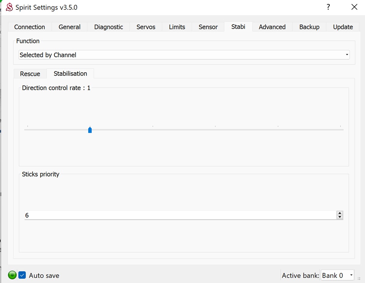

stabi tab
stabi tab

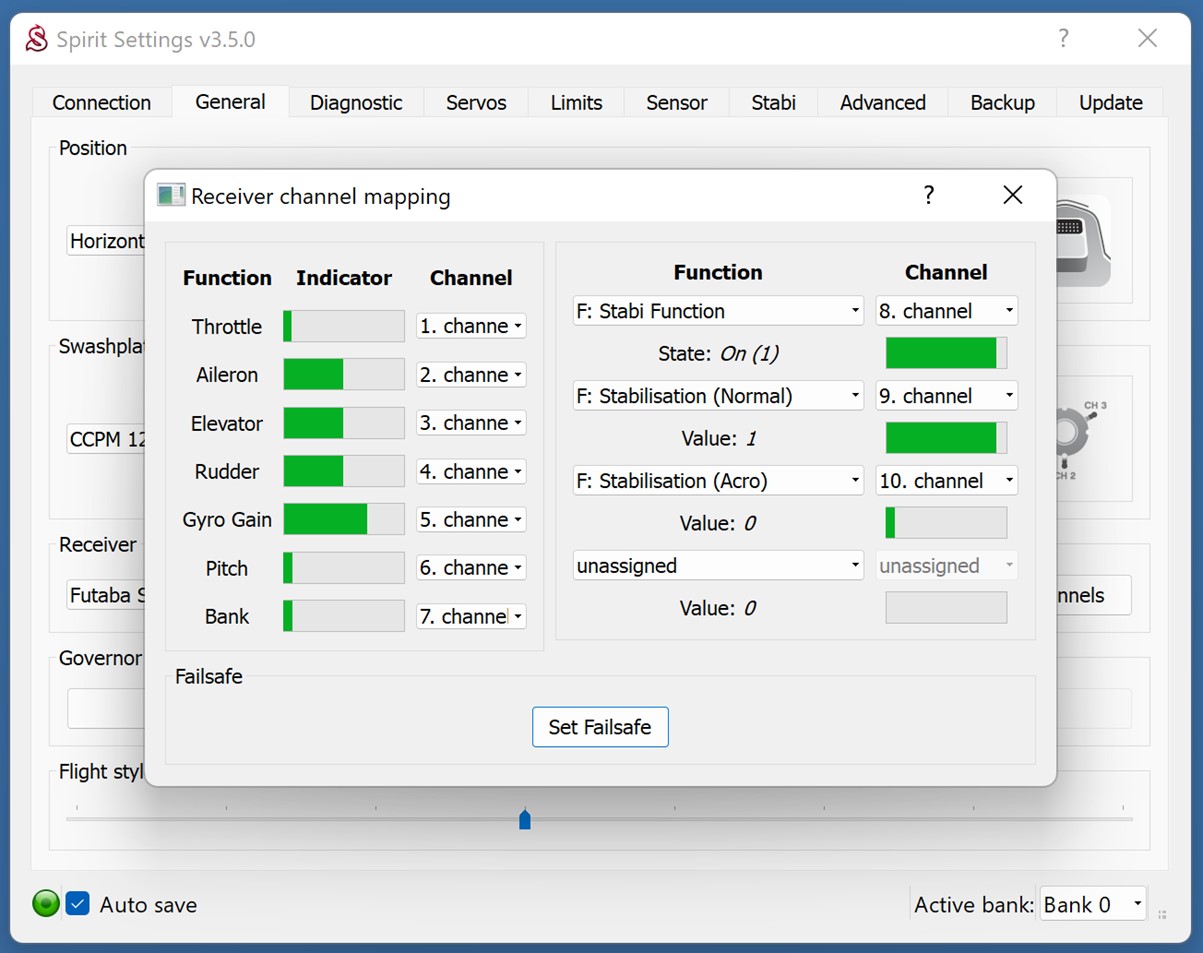

Receiver channel mapping

If the wanted function is working you see it here in Spirit Settings:
