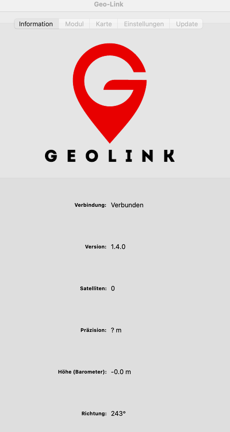

now I have to report almost the same issue that was reported for Win 10 and GeoLink V2.
My setup:
- Old Spirit (red)
- V 3.6.0
- GeoLink V1
- macOS sessings app V 3.6.0r2
No access to GeoLink, the information tab is visible, but the other tabs are greyed out:
After downgrading to Spirit 3.5.0, access to GeoLink was given again and I could update it to V1 1.4.0.
Back to Spirit V 3.6.0, I could not access the GeoLink again.

What I also noticed is that the connection via WiFi is very unstable and settings-SW was crashing often, especially when opening the GeoLink window.
After your post I tried to connect via USB and that way it is working on both Macs and no more connection losses or app crashes.
Looks like it is WiFi related...

With the provided software from the thread V 3.6 nearly unusable on the latest Mac Operating System the problems do not exist anymore!
Thanks for your excellent support!
