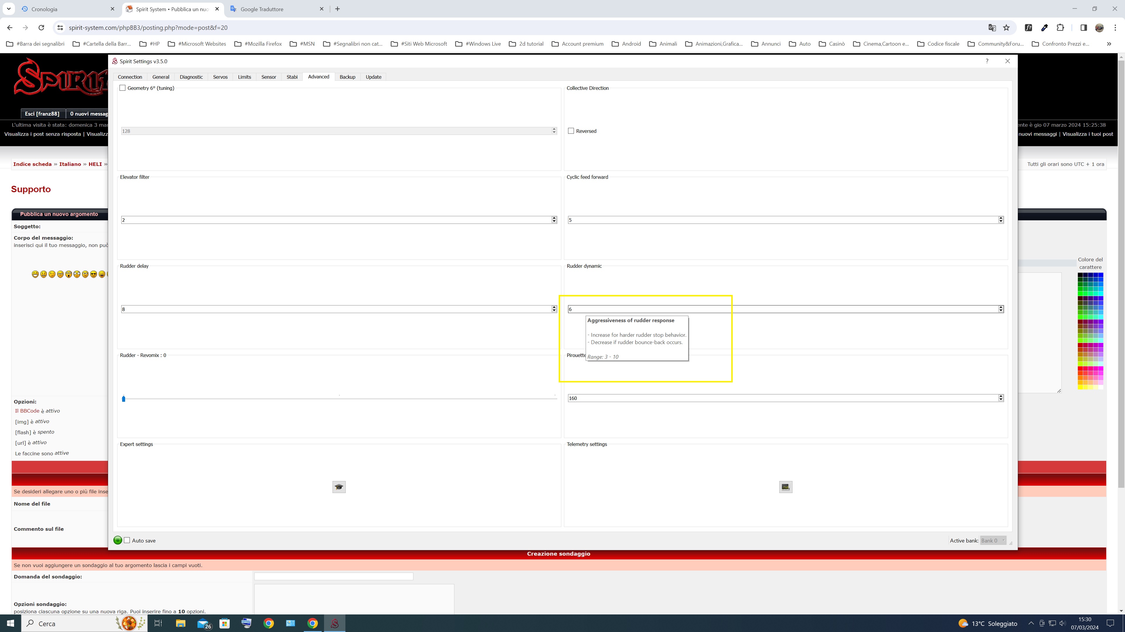

I would like set to the best my helicopter with spirit gtr.
after releasing the stick of the tail if the tail stop he's too nervous Which parameter should I move?
you can translate into Italian the spirit windows software?
this pop up are good but every time translate into Italian or read the manual on the flying field it's not the best.
I bring my PC with me to read the descriptions of advanced parameters because I could change them from the radio (integration jeti) but pc it's better for advice but the language in English is one handicap.
I convinced many of my friends to buy spirits but they don't understand English.
I don't think it's difficult to translate the software.
with the translator certain words they are translated well other bad words.
if can help I translated the jeti manual.
so to soften the tail stops?

yes at the moment the only solution to understand the advanced parameters is to open the manual and use Italian translator.ZeXx86 wrote:Hello,
yes, we plan to add Italian version to Software.
Please take a look here:
https://manual.spirit-system.com/index. ... ning_Guide
We updated guide recently.
but
open the software spirit and go with the mouse on the parameter and read the description in your own language it would be better.
oh god nothing serious but there are people newbie they don't understand English that they didn't know
that if you go online you can find the manual in various languages.
my friend it connected the spirit to the software and tried to understand what that parameter did, But in the end he saw English and it solved calling me and I set the spirit for him.
While if he was Italian he would have set it alone the flybarless unit.
we can dedicate the left side of the software to write the operation of the various parameters.
pop ups is good but after a few seconds they disappear.
in conclusion if the software is translated it would be better

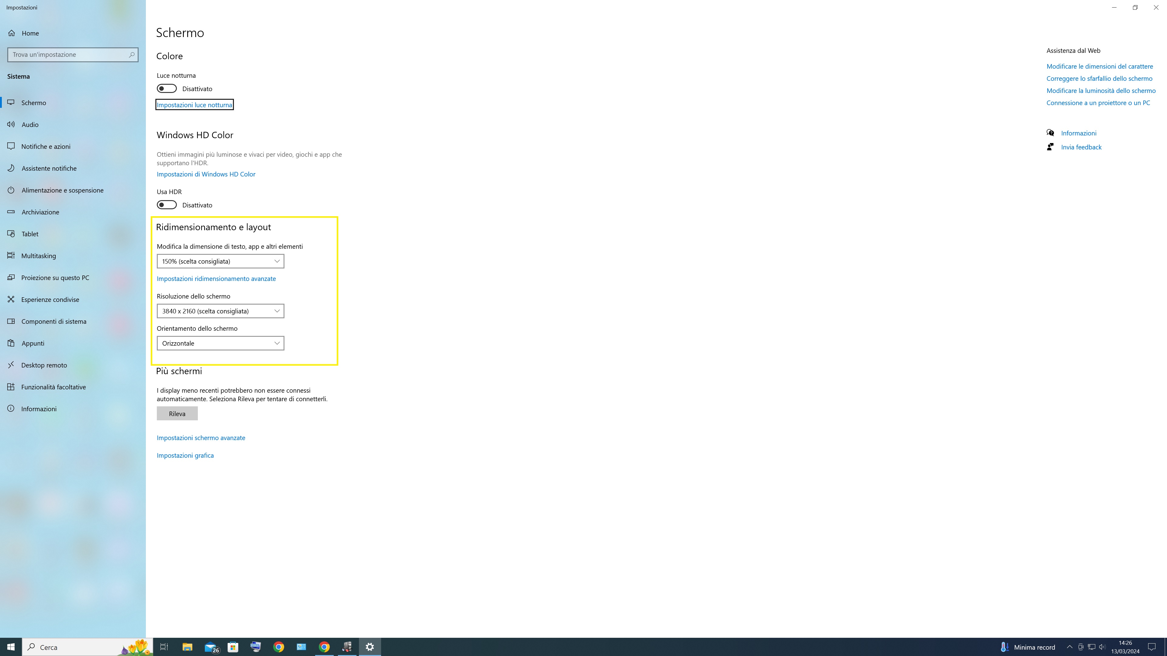

I read the messages on the spektrum analyzer.
I tried with version 3.5 and everything is ok
now i update software spirit the last version 3.6.3 I downloaded the windows version from here
https://spirit-system.com/download.php
the spirit I updated to the latest version available 3.6.2
I also have problems with spektrum analyzer.
the first time a white window comes out
and the second time the error came out connection is instable.
https://youtu.be/z1Y9IEmsSl8
PS
because logs in advanced log time Aren't they automatically deleted?
when the memory is full the oldest log is deleted to give space to the new logs??
Sorry for my bad english

this is my component pc (to understand which component can cause the problem spektrum analyzer)
P8Z77-V LX (LGA1155)
Intel Core i5 3470 @ 3.20GHz
sapphire AMD Radeon R9 290
Windows 10 Pro 64-bit
16gb ram ddr3
I attach video resolution settings and I want specify in demo mode spektrum analyzer is ok

Many thanks for all the details.
We will try to find the problem tomorrow.
I will send you private message with URL for new version. I hope it can help you.
We are still trying to find solution. We are building new computers to be able to replicate the issue at the moment.
