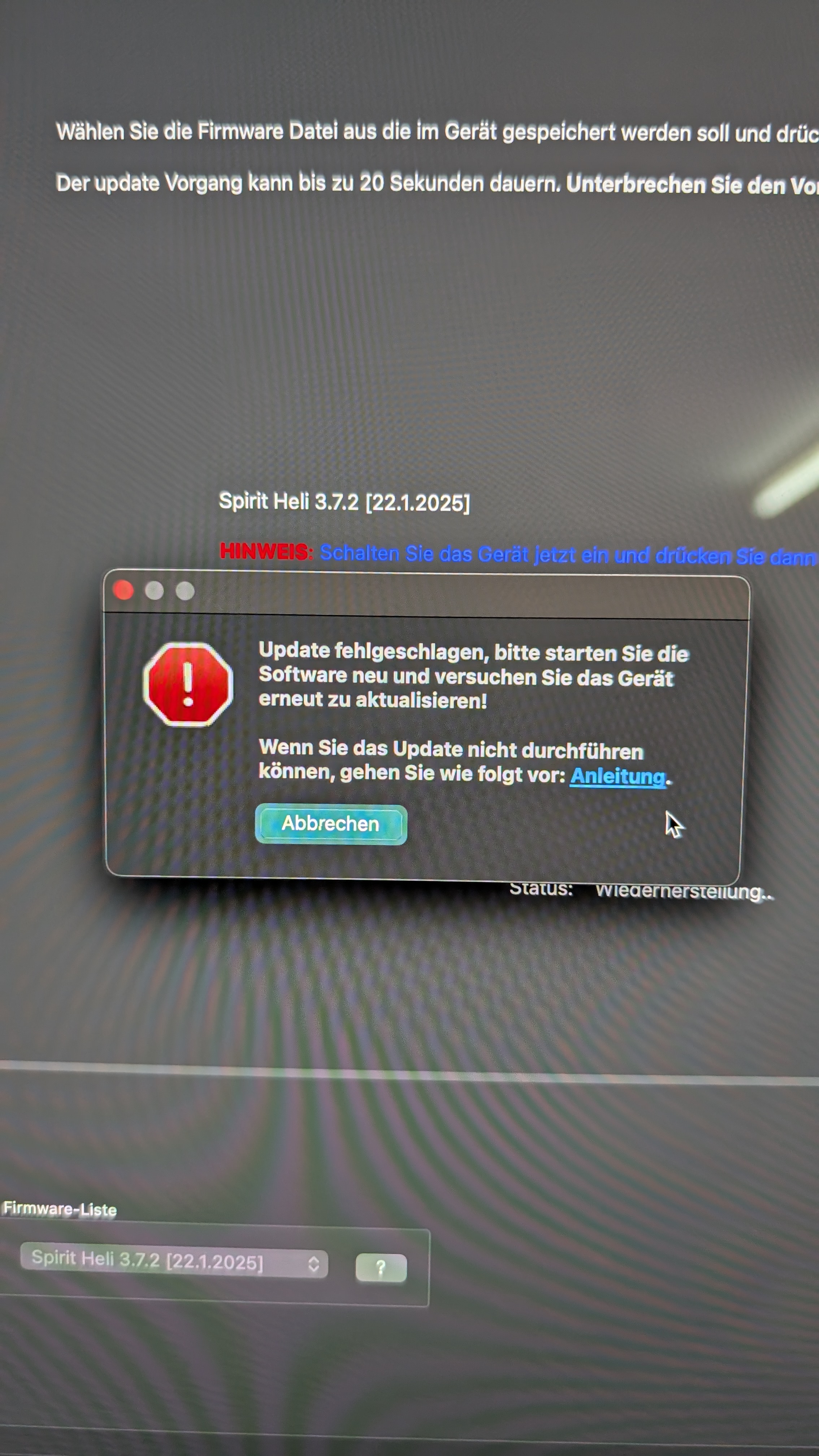

Hello there,

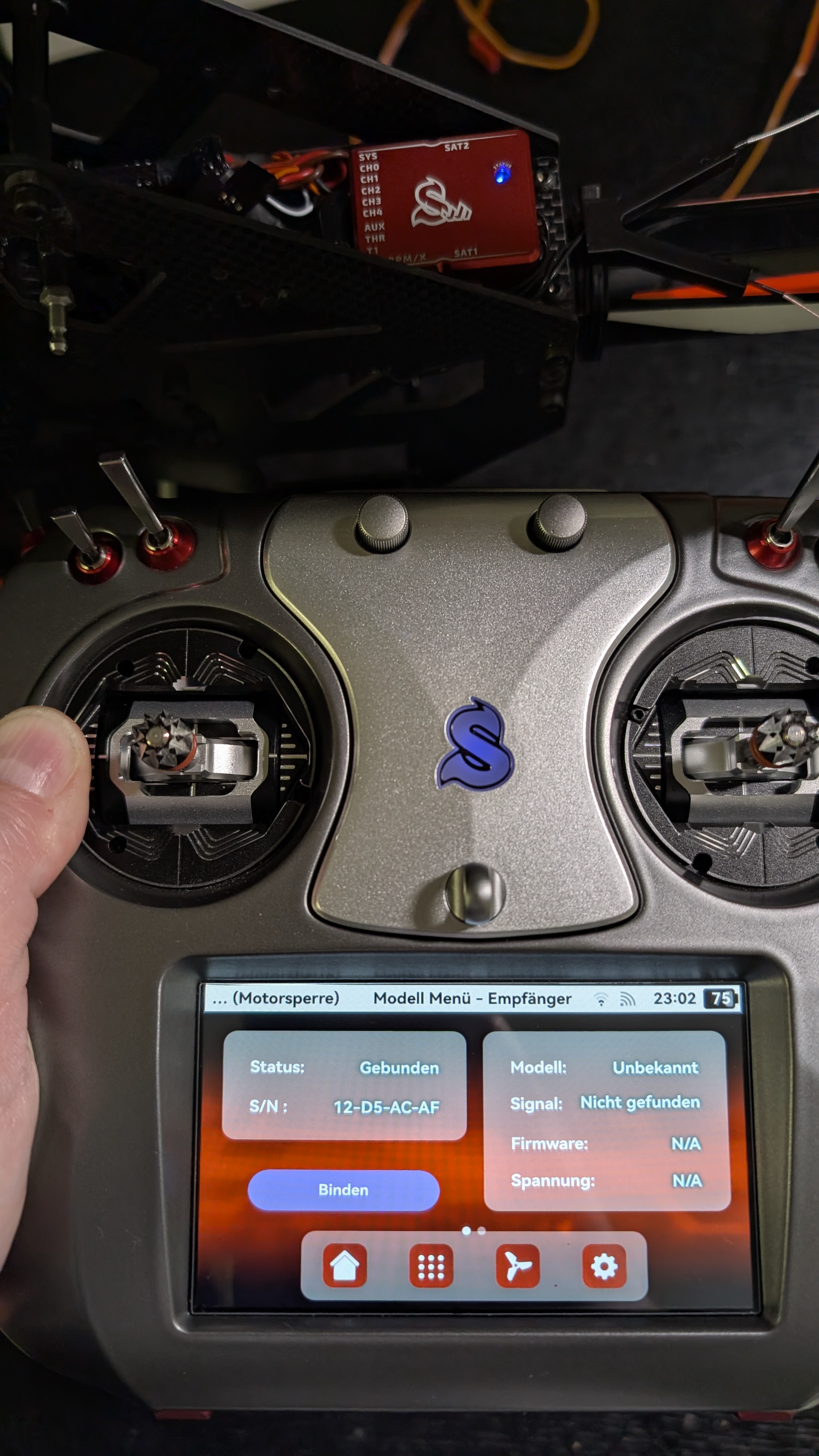

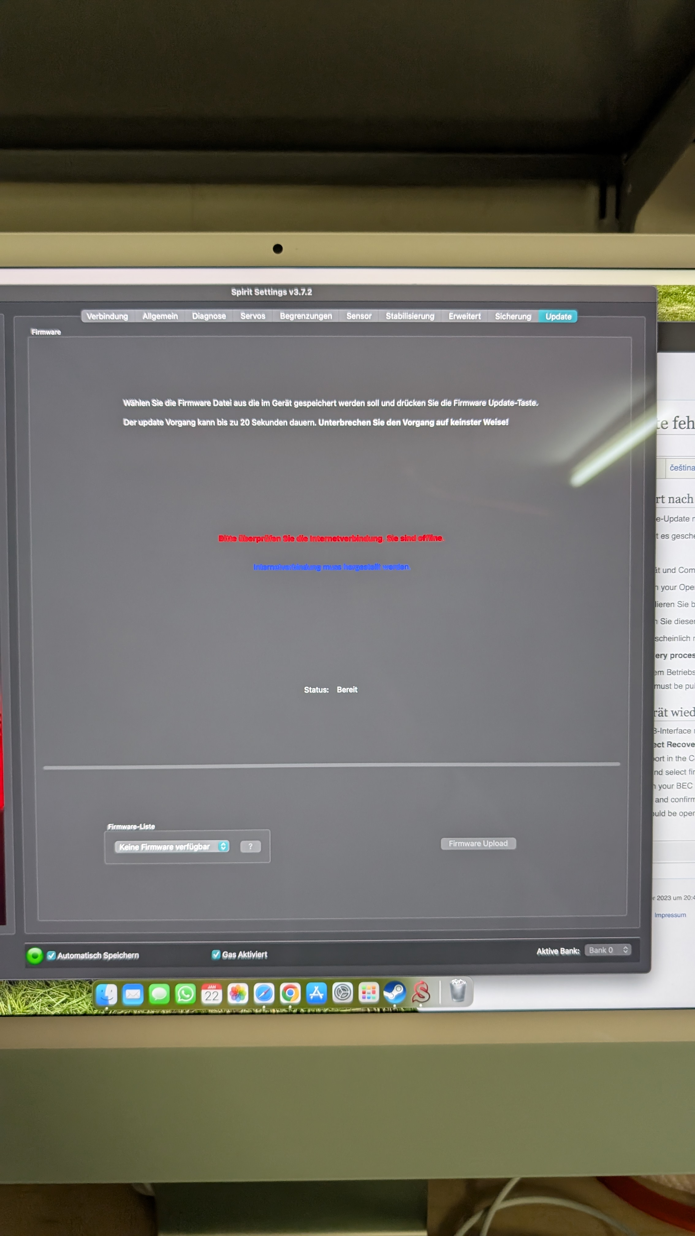

This evening I wanted to install the new 3.7.2 on my W1 via the Wave. So I thought at first I would do the RX update from version 3 to 4, after the update the heli restarted and I no longer have a connection. Afterwards I tried to update the software via the PC and Mac. When the heli is connected to software, the W1 is recognized but no firmware is available under Update.When I try to make a recovery, after booting I select the correct USB after update Plug in the battery but the W1 simply lights up blue and doesn't start pulsing. I waited 5 minutes nothing, then just pressed the update. Logically error. The W1 with a binding plug is bound by the wave, but no RX reports. I'm asking for help I made 3 models via wave update today, but there's a worm in one

we are sorry for the problems, it seems there were two issues from which one was because our servers were overloaded (all pilots were updating around this time).
For the second it seems that during updating some data were not transmitted properly. We already addressed this issue and added new safety checks for wireless updating of the Spirit and receivers. This will be available in the upcoming Wave update to avoid this problem. Wave update will be available possibly tomorrow or on monday.
In any case both Spirit and RX can be always updated though the PC software whatever will happen. You can recover it in the recovery mode according this page:
https://manual.spirit-system.com/index. ... ing_Failed
Spirit RX can be flashed according this page:
https://manual.spirit-system.com/index. ... X_Updating
